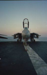

The ramps can be manually dropped at shutdown or by the maintenance crews on deck. This was normally done prior to a jet going into the hangar, or to facilitate maintenance that required the ramps in the down position. Normal aircrew shutdown has the ramps in the up position, but it's not uncommon to see them dropped like in my pic above. You're not crazy for wanting to build the Hasegawa Tomcat in this day and age... I have several and have built a few. True, it feels like you'll never stop throwing parts on it while you're building, but the challenges are well-documented and they
