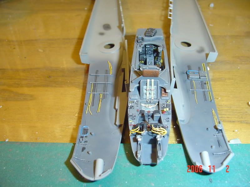

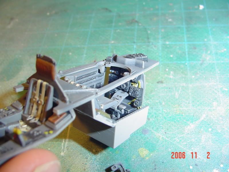

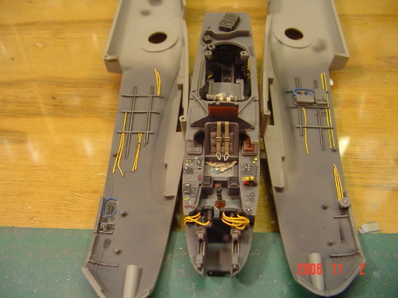

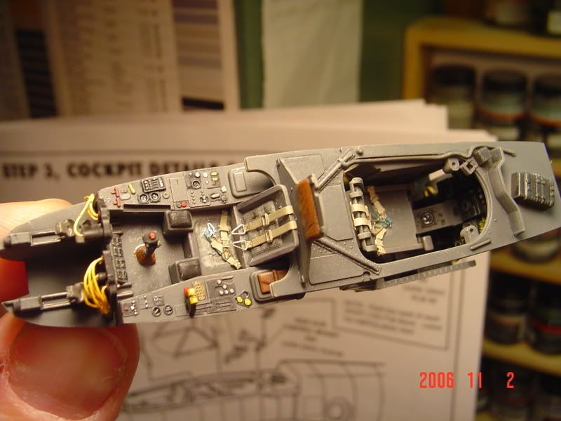

Chris Kethan Posted November 2, 2006 Share Posted November 2, 2006 (edited) Here are some photos of my 410 cockpit. I've got the wings assembled, and the landing gear painted. I hope to close the fuselage and and add the wings this afternoon. I actually preshaded some of the cockpit (I'm not a fan of it, but it seemed to help the cockpit since it is so dark in there). I added the yellow wiring with bits of fine wire. The harnesses are Eduard PE. I used a wash of Tamiya smoke, flat coated, and followed up with a drybrush of light grey and steel. It came out pretty well, I think. I should have routed the pilots harness through the seat back, but I took the lazy way out and just draped it over the seat back. I'm not much of a photographer, so bear with the crappy quality of the photos. Enjoy, Chris Edited November 2, 2006 by Chris Kethan Quote Link to post Share on other sites

jrallman Posted November 2, 2006 Share Posted November 2, 2006 very nice work indeed! the wiring adds a nice busy touch Quote Link to post Share on other sites

Matt_S Posted November 3, 2006 Share Posted November 3, 2006 Is this the R/M 1/48 kit? If so, hiw did you manage to get the instrument panel pieces straight? Matt Quote Link to post Share on other sites

moeggo Posted November 3, 2006 Share Posted November 3, 2006 Is this the R/M 1/48 kit? If so, hiw did you manage to get the instrument panel pieces straight?Matt Yea its the R/M kit, its the same as the Promodeler one too. I have had look at mine and I would glue the panel one at a time and hold it place with you fingers till it takes Quote Link to post Share on other sites
Chris Kethan Posted November 3, 2006 Author Share Posted November 3, 2006 Is this the R/M 1/48 kit? If so, hiw did you manage to get the instrument panel pieces straight?Matt B) Matt, It's the 1/48 PM kit. I used the TLAR method to get the instrument panels precisely in the right spot. That....Looks.....About....Right :) Seriously, I used super glue and just held them in place with tweezers until the glue set. It's probably not the correct angle, but I'm not a rivet counter and I don't let details like that get in the way of finishing a kit. Chris Quote Link to post Share on other sites
ScottD Posted November 3, 2006 Share Posted November 3, 2006 Is the wiring painted or does it come in that color? If it is in yellow, where did you get it from? Quote Link to post Share on other sites
Chris Kethan Posted November 3, 2006 Author Share Posted November 3, 2006 Scott, It was enamel coated wire from Radio Shack. I bought a pack 3 pack of different sized spools for about $4. I just drilled a hole in the back of the instruments put a dab of superglue on the hole and stuck the wire in. I bent the wire to shape and painted it yellow when I had it prebent. (If you try to bend it after you paint it, the paint will crack and peel off. Ask me how I know. ) Pretty simple and inexpensive scratch building trick. I can't take credit for it. I got the idea of adding wire from looking at Bill Lachance's incredible luftwaffe builds. Chris Quote Link to post Share on other sites

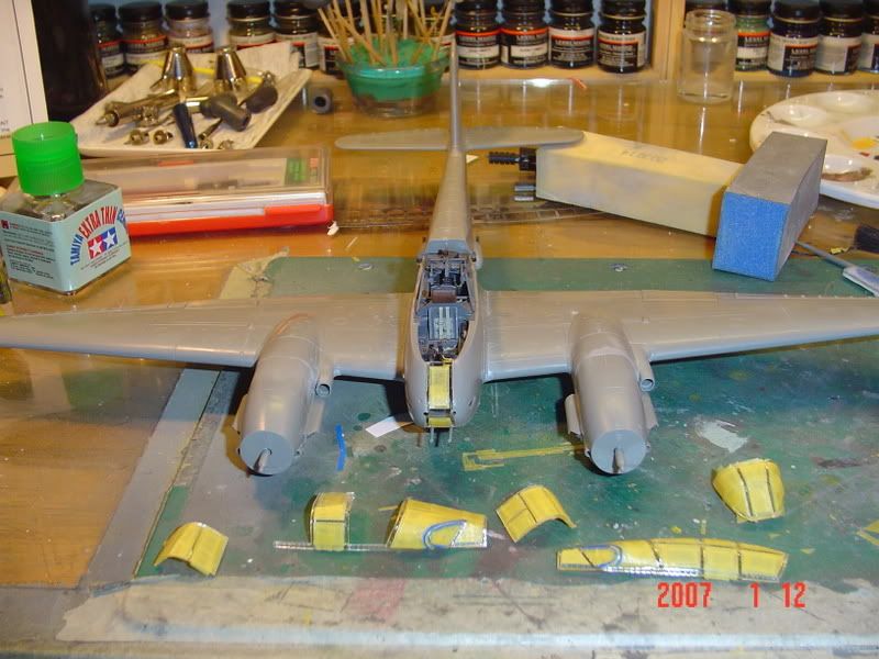

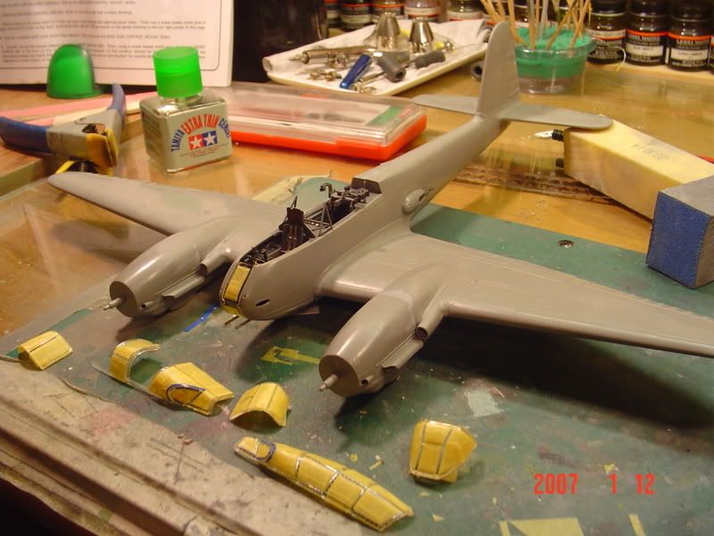

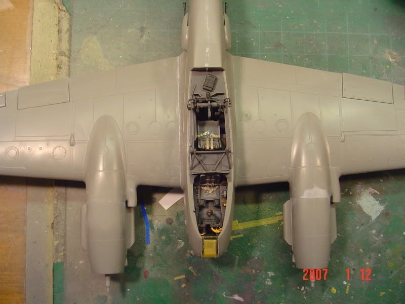

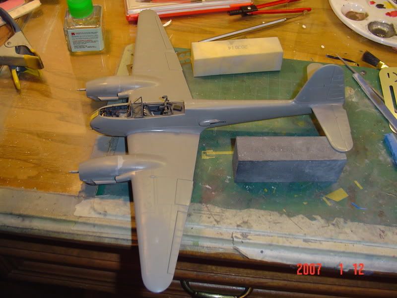

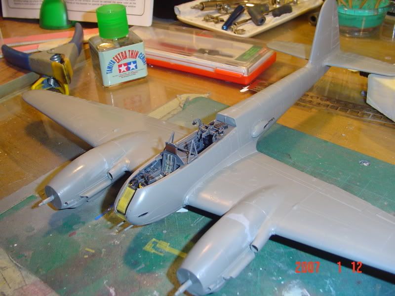

Chris Kethan Posted January 12, 2007 Author Share Posted January 12, 2007 OK..... Finally time for an update. I wasn't able to model much during the last 6 weeks, and when I had a little free time, I spent most of that free time masking the 410's greenhouse canopy! ;) When it got especially tedious - (which was often, because the canopy has to be masked on both the inside & outside) - I worked on my 1/48 Promodeller Fw-190D11. It is a mostly OOB build with a few small details added. On to the 410.. The cockpit & airframe are complete awaiting an alcohol bath and a paintjob! Here's a shot showing the canopies.. That's it for tonight. I hope to finish the prep work on the Fw190 tomorrow. Then I can paint both aircraft at the same time. Chris Quote Link to post Share on other sites
Dr Fester Posted January 12, 2007 Share Posted January 12, 2007 Chris, Thats some fantastic detail work on the cockpit and very sharp painting, superb. I can see where your spending your time now ;) , but well worth the effort. Looking forward to seeing more of the progress now the wings are on. Cheers Doc Quote Link to post Share on other sites

Shawn C. Posted January 12, 2007 Share Posted January 12, 2007 Outstanding work Chris. I'm anxious to see how you deal with the construction of the canopy. The parts fit pretty well, but I just couldn't align them properly *and* deal with the seam on top. Thus, my Me-410 is not done. Hopefully you will have better luck on your kit. Cheers, Shawn Quote Link to post Share on other sites

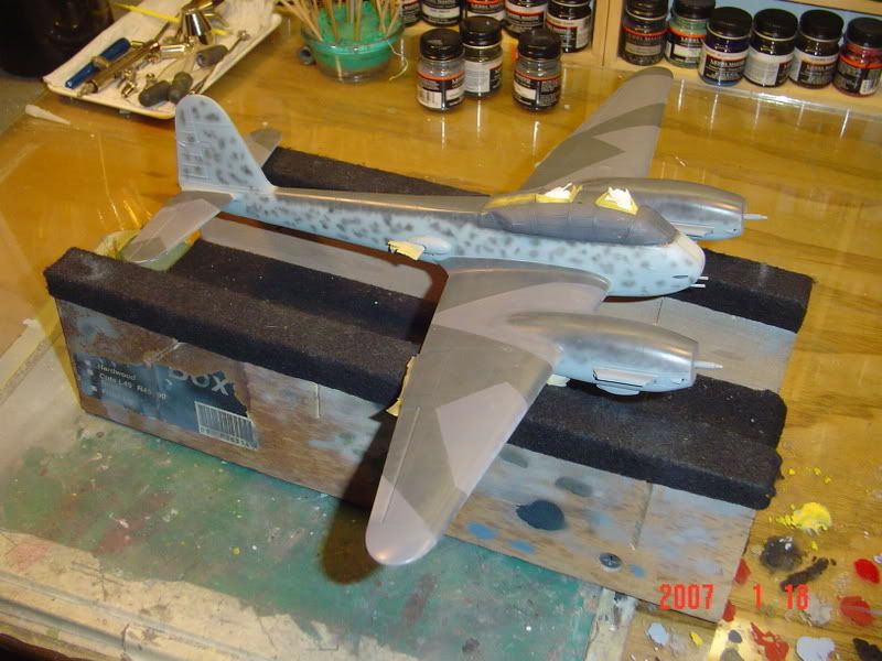

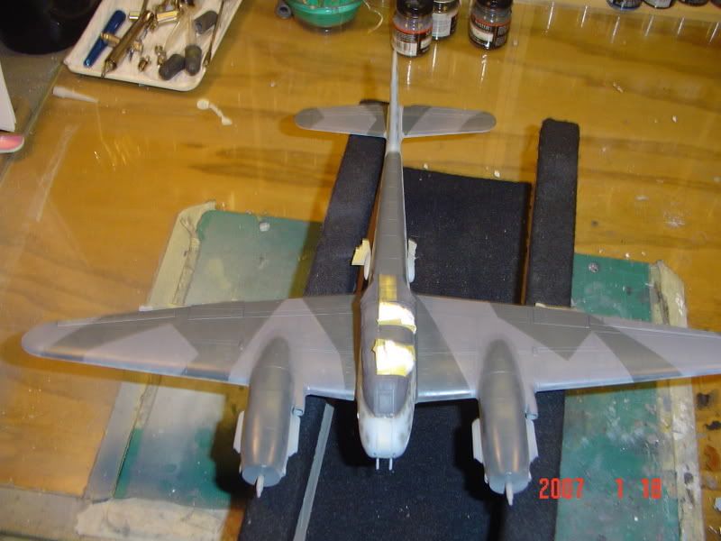

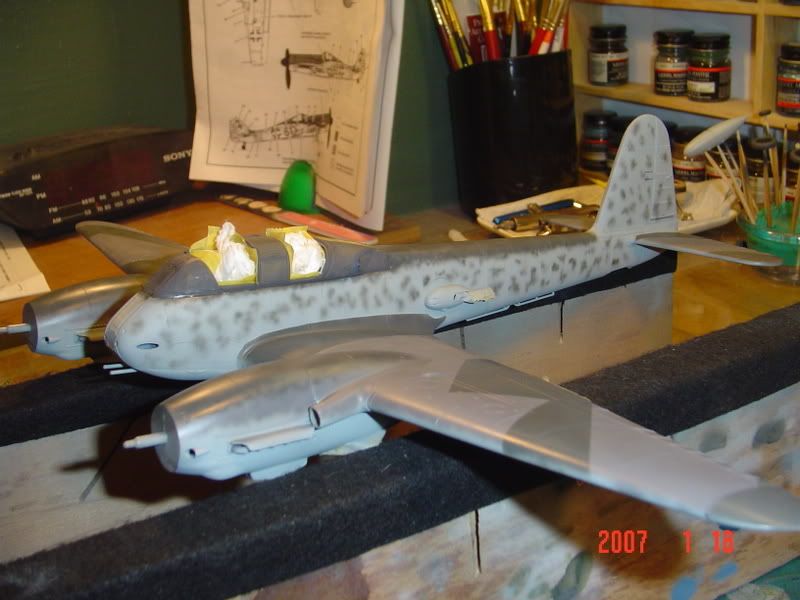

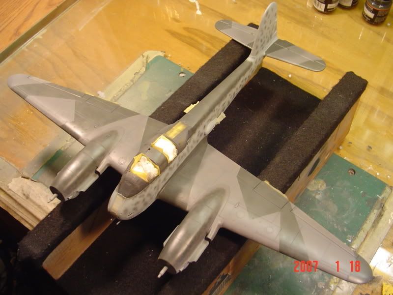

Chris Kethan Posted January 18, 2007 Author Share Posted January 18, 2007 Here she as after a marathon painting session last night. Shawn, you were correct. That canopy was a beotch to fit. I practiced dryfitting it for a few times before I actually applied the glue. I used clear 5 min epoxy, so I only got one chance to get it right. ;) It's not perfect, but it's about as good as I could do. Also, for those of you building this kit, be sure to trim the rear gunsight before you add the canopy. The kit part is too wide to allow the canopy to fit. I cut my gunsight apart & shortened the base to get it to fit under the glass. Enough BS.... On to the pictures! I'll post more after the clear coat & decals. Chris Quote Link to post Share on other sites
dragonfly Posted January 19, 2007 Share Posted January 19, 2007 Excellent work Chris.....love the detailing in the cockpit. Jerry Quote Link to post Share on other sites
moeggo Posted January 19, 2007 Share Posted January 19, 2007 Very Nice Chris!! I will try to remember about the rear gunsight when I start on mine next! Quote Link to post Share on other sites
