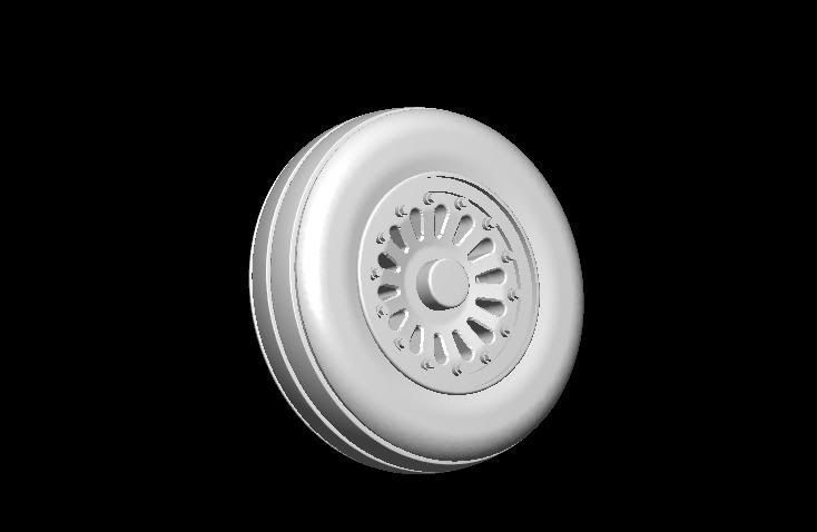

j-basset Posted January 17, 2007 Share Posted January 17, 2007 (edited) Hi, just an update: If you're wondering what happened to the previously announced 1/48 LAU-128 launch rails, it has been delayed so that it's production and market release takes place with another product we are considering. Here it is: This is a CAD rendering of the F-16 main wheel currently used on the F-16A/B/MLU/Block 25/30/32, and is meant for the Hasegawa 1/48 F-16. We'll be sending this for rapid prototyping soon, but would like to survey its viability before we proceed. This is something we would appreciate feedback on, as the Tamiya 1/48 F-16CJ is around the corner, and who knows what will follow shortly. After that, the only hurdle left is how well a 3D printer can reproduce something like this. Jason F-4DableModels Edited January 17, 2007 by j-basset Quote Link to post Share on other sites

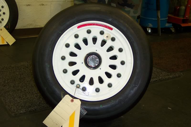

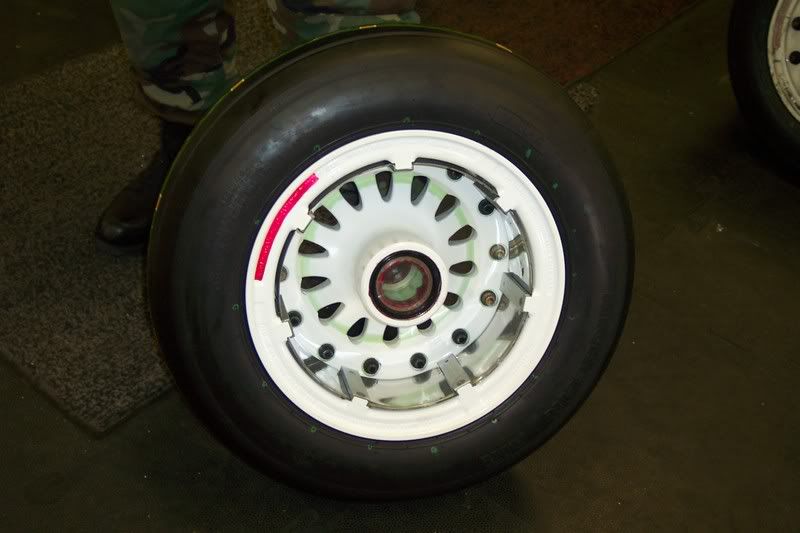

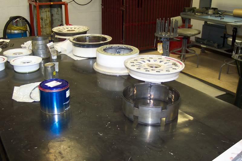

ThePhantomTwo Posted January 17, 2007 Share Posted January 17, 2007 (edited) A couple of pics of the MLG wheel in our tire shop,we fly Block 30's.Pics taken in September of 2006. Inner portion of the wheel ..and what it looks like all tore down. Edited January 17, 2007 by ThePhantomTwo Quote Link to post Share on other sites

j-basset Posted January 17, 2007 Author Share Posted January 17, 2007 Dave, Thanks for the pics. It's great to be able to see how the rendering holds up to the real thing. Much appreciated. Jason A couple of pics of the MLG wheel in our tire shop,we fly Block 30's.Pics taken in September of 2006. Quote Link to post Share on other sites

doctorpepper Posted January 17, 2007 Share Posted January 17, 2007 hey, since it's in CAD - do you think you could add a bit of detail to the wheel speed sensor/wheel hub cover? the cover has like a sorta triangular base... David Quote Link to post Share on other sites
j-basset Posted January 17, 2007 Author Share Posted January 17, 2007 Yes, sure. I'm already seeing some changes needed to conform to the one in Dave Cook's photos. Jason hey,since it's in CAD - do you think you could add a bit of detail to the wheel speed sensor/wheel hub cover? the cover has like a sorta triangular base... David Quote Link to post Share on other sites

Kent Tomlinson Posted January 19, 2007 Share Posted January 19, 2007 Count me in on several wheel purchases for my Hasegawa kits. Are you doing the brakes on the backside as well? Thanks. Kent Quote Link to post Share on other sites
j-basset Posted January 19, 2007 Author Share Posted January 19, 2007 Kent, No brake detail - it'll be a straight replacement of the kit parts. I did consider adding brake detail, but that would involve some surgery on the MLG units to remove the molded on ones which are somewhat simplified. Since the MLG's are load bearing items, it would have been risky for the average modeller to remove the brake discs without damaging the shaft (and possibly having to insert a length of aluminium tubing etc. as replacement without compromising strength or alignment). Therefore, I elected not to include it. Jason Count me in on several wheel purchases for my Hasegawa kits. Are you doing the brakes on the backside as well? Thanks.Kent Quote Link to post Share on other sites
ThePhantomTwo Posted January 19, 2007 Share Posted January 19, 2007 (edited) Dave,Thanks for the pics. It's great to be able to see how the rendering holds up to the real thing. Much appreciated. Jason No problem,I took those with the intention of posting them way back in September but never got around to it.I might take the camera out next week and take pics of both sides installed on one of our Block 30's and post them on this thread.Maybe you can do the brake detail as well? Edited January 19, 2007 by ThePhantomTwo Quote Link to post Share on other sites
j-basset Posted January 19, 2007 Author Share Posted January 19, 2007 Adding brakes shouldn't be a problem, but I'd be inclined to cast a 'straight replacement' with separate brake discs as an option. Jason No problem,I took those with the intention of posting them way back in September but never got around to it.I might take the camera out next week and take pics of both sides installed on one of our Block 30's and post them on this thread.Maybe you can do the brake detail as well? Quote Link to post Share on other sites
