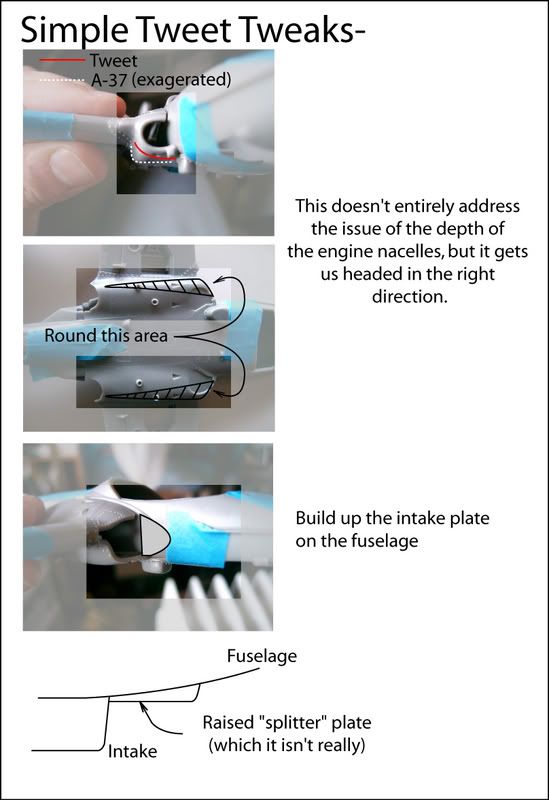

Impatient Pete Posted February 15, 2007 Share Posted February 15, 2007 (edited) Hey dudes, So I took a quick look and figured out a few major tweaks to the A-37 kit. This is by no means comprehensive, but just a look at the biggest issues to those of us wanting a T-37. These are just a quick glance kind of thing. What are all of the changes needed? Doors, Cockpit, fin filet, etc... What do you guys think? Shall we make this a T-37 conversion guide? Pete Edited February 15, 2007 by Impatient Pete Link to post Share on other sites
Keith Diamond Posted February 15, 2007 Share Posted February 15, 2007 Looks like a good start to one! Anybody out there Tweet experts? I know some of the guys here, such as Murph, Waco, Pig and Hitch have had significant training time in it, what do you guys suggest? Link to post Share on other sites

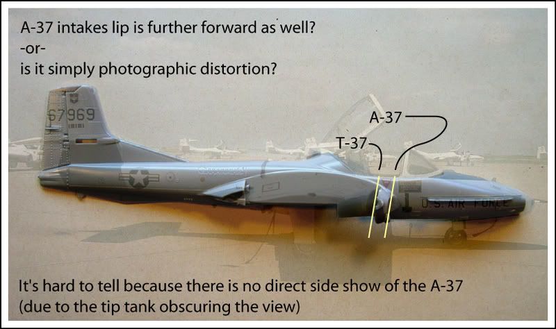

Impatient Pete Posted February 15, 2007 Share Posted February 15, 2007 (edited) Great pic! I did a little comparison here: Are the wings bigger on the A? I don't think so, but it looks like the intake is further forward and so it seems like the wing LE is as well. I think it makes sense that the intake is further forward. It seems like the reason that the T-37 whistles so badly is that the air entering the engine makes a severe turn after entering the intake. Does the A-37 whistle as loudly? One possible explanation could be that the intake is further forward and so the change in direction is less harsh? Or maybe I just think too much? Anyway, two ?'s: Is the intake really further forward on the A-37, and is the wing the same (dimensionaly)? Pete Edited February 15, 2007 by Impatient Pete Link to post Share on other sites
