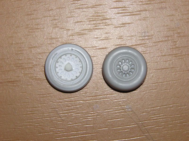

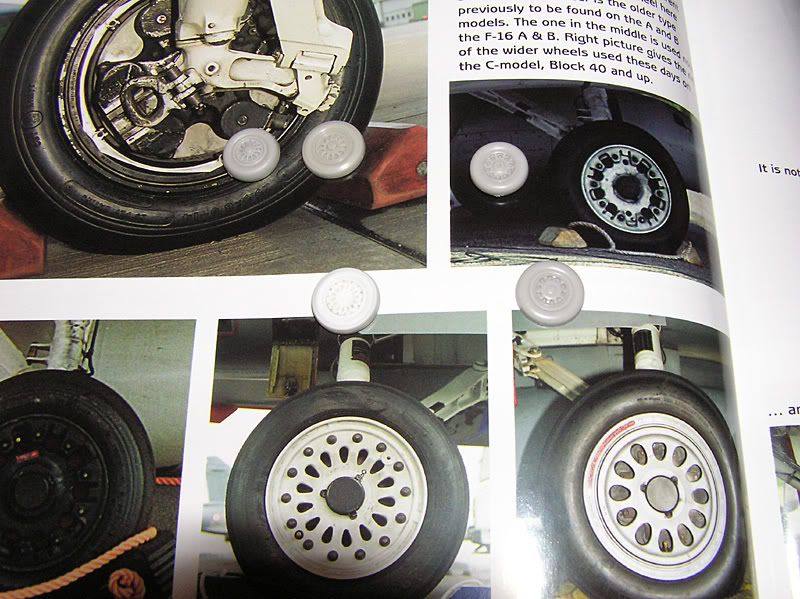

doctorpepper Posted April 26, 2007 Share Posted April 26, 2007 ok, here's some progress. i took all the F-16 wheels i could find to do a comparison. from the data from Michelin at http://www.airmichelin.com/pdfs/MIL_F16X.pdf, the F-16 blk 30 wheel is 25.5", and the blk 40/50 wheel is 27.75" in diameter. picture: clockwise from top left: hasegawa blk 50 wheel, tamiya blk 50 wheel, hasegawa A/B wheels, hasegawa F-2 kit wheels, and the blk 30 wheel i made. you can see that the hasegawa wheels and the Tamiya wheels are quite different in size, and from the data above, dividing by 48: the Tamiya blk 50 wheel is spot on, while the hasegawa wheels are woefully small. the hasegawa A/B wheels don't even measure 25.5" in scale, so i don't know where they got their measurements from. What i'll be doing: i'll be taking the WSS from the tamiya blk 50 wheel and implanting it into my wheel hub. for accuracy, i will only use the tamiya sized wheels, so they will require some fitting to fit onto Hasegawa kits. drPepper Quote Link to post Share on other sites

jefropas Posted April 26, 2007 Author Share Posted April 26, 2007 Doc, Those look great! I'm glad my post got some people's "wheels" turning. I think it would be great to make all those different types of wheels. Can you please post a pic of the Block 30 wheel alone, its kind of hard to see in the pic being all white. I will load up my Paypal account ASAP!! Thank you very much. Jeff Quote Link to post Share on other sites
doctorpepper Posted April 26, 2007 Share Posted April 26, 2007 Doc,Those look great! I'm glad my post got some people's "wheels" turning. I think it would be great to make all those different types of wheels. Can you please post a pic of the Block 30 wheel alone, its kind of hard to see in the pic being all white. I will load up my Paypal account ASAP!! Thank you very much. Jeff it's in the casting pot.. doing a mold. so that i don't lose it and have to redo it or something... Jason - what's the status on your wheels? don't want to be clashing with you. drPepper Quote Link to post Share on other sites

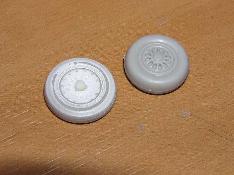

doctorpepper Posted April 29, 2007 Share Posted April 29, 2007 wheels done - side by side comparison with hasegawa's blk 50 wheels now to cast up this half, join it together, and put a bulge at the bottom like it was weighted... maybe even figure a way to attach brakes to the hasegawa gear? Quote Link to post Share on other sites
