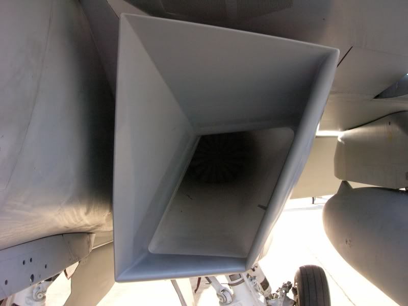

Chris Kethan Posted May 2, 2007 Share Posted May 2, 2007 I've determined that I HATE sanding intakes! I've built a 1/48 Hasegawa A-7E and F-8E and I didn't really like sanding them, but at least I could get sanding sticks in there. These intakes on my Revell super hornet are a beotch. It seems like I have been working on them for a week, and they still aren't done. Numerous coats of tamiya putty and Mr. Surfacer and hours of sanding......I don't really want to use intake covers. My question is this... does anyone have a picture of where the demarcation line between the white and grey is inside the intake? I have been unable to find one online and I don't want to buy a ref book for this build.. TIA, Chris Quote Link to post Share on other sites
raptor22 Posted May 2, 2007 Share Posted May 2, 2007 Oogles of Googles... Quote Link to post Share on other sites
Dan 88 Posted May 2, 2007 Share Posted May 2, 2007 http://www.alert5.com/gallery/VFA-106/1_ju...05_3_110?full=1 ....and HTH Daniel Quote Link to post Share on other sites
