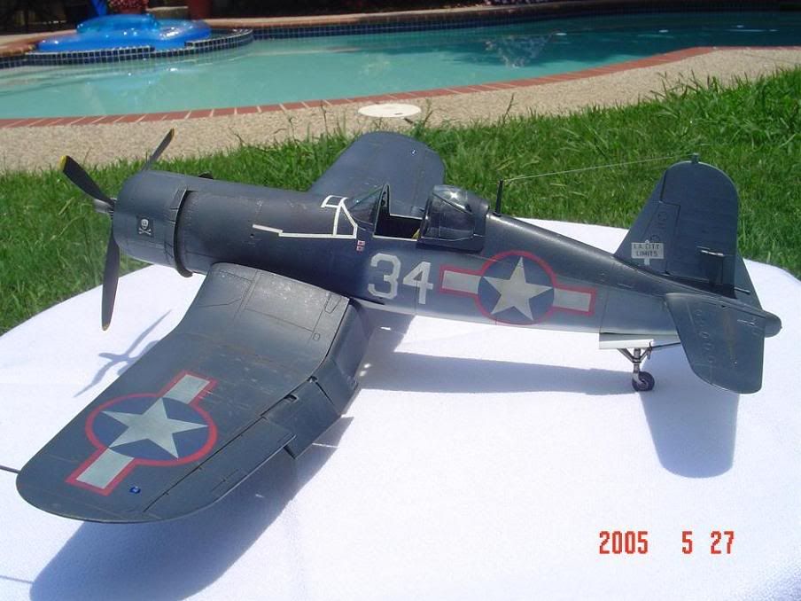

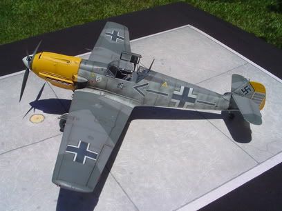

Chris Kethan Posted October 15, 2007 Share Posted October 15, 2007 I actually spray a light mist coat of the underlying color over the decals. It really fades the decals into the paint nicely. Here are my layers.. 1. Paint 2. Clear Coat 3. Wash 4. Clear coat 5. Mist coat over decals 6. Dullcoat Here's a couple of examples: HTH, Chris Quote Link to post Share on other sites
