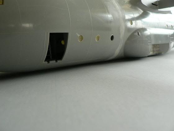

boscosticks Posted February 23, 2008 Author Share Posted February 23, 2008 (edited) okay so here it is.. the window isnt too big, and i had a ruler in place to help with the visuals and Edited February 23, 2008 by boscosticks Quote Link to post Share on other sites
Greenghost Posted February 24, 2008 Share Posted February 24, 2008 okay so here it is.. the window isnt too big, and i had a ruler in place to help with the visuals and You can use Micro Kristal Klear from Microscale to make a new window. Good luck. S. Quote Link to post Share on other sites
The Rat Posted February 24, 2008 Share Posted February 24, 2008 (and also, should i future the clear cement?) I just used some of the Testor's "Clear parts cement & window maker" on a recent project and the Future went over it fine. Quote Link to post Share on other sites
boats Posted February 24, 2008 Share Posted February 24, 2008 Bosco, try this. Drill a small hole in the center of the window, use a fine wire 10 inces long, put a knot near the center on the wire, put the wire through the window, then through the window port, pull the window up to the port and glue, after it drys pull the wire back out. I've had to do just the route I put before you, it shouls work fine. "Boats".. Quote Link to post Share on other sites
kap64 Posted February 24, 2008 Share Posted February 24, 2008 You could always do some surgery and cut out a section at the panel lines, put the window back in and glue the section back and fill the seams. Takes some work, but you will have your original window back. Quote Link to post Share on other sites
boscosticks Posted February 24, 2008 Author Share Posted February 24, 2008 should i just make those three window sets with the clear cement/window maker? im a bit worried now because i barely touched down on the window when it popped out, and if i have to remove those masks on the window.. it might pop several others out.. ? so im deciding whether or not i should just pop all of the windows out and just make all of them.. it should be clearer and more realistic than the thick windows that come with the kit, right? hmmm.. thank you again for all the advice and tips!! i appreciate them very much! Quote Link to post Share on other sites
