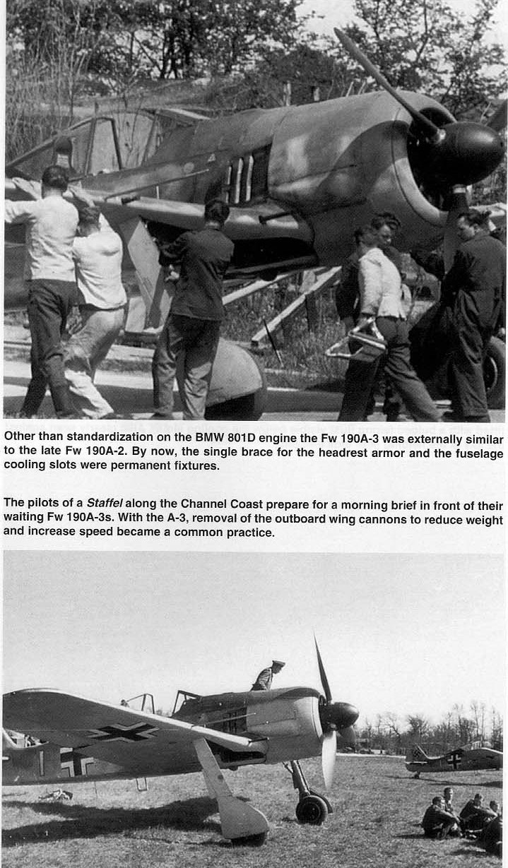

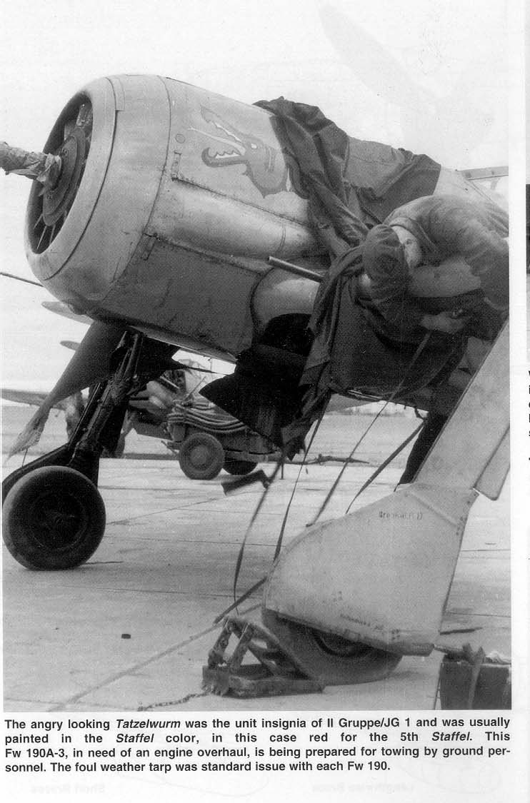

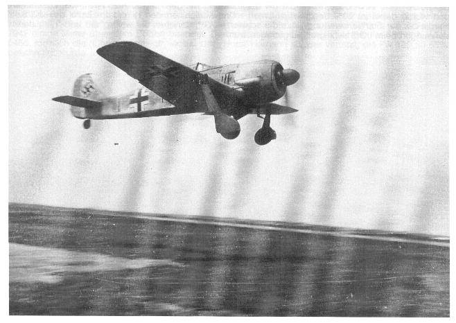

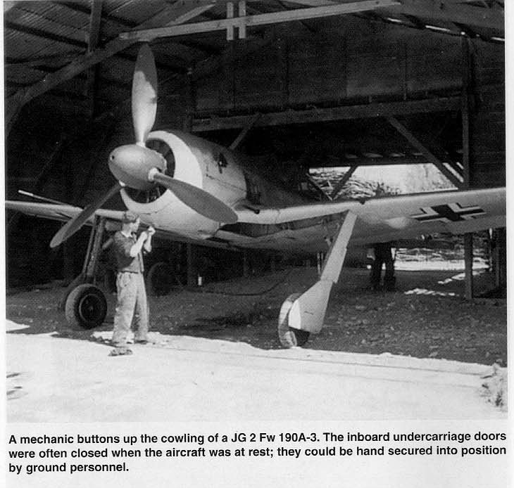

bad edd Posted May 26, 2008 Share Posted May 26, 2008 The A3 also had full enclosed undercarriage. The reason for the few clear photos is the fact that by default they were closed on ground and therefore very hard to spot. I found some pics in which the small doors can be seen: First three from Squadron Signal "In Action" book. Quote Link to post Share on other sites
