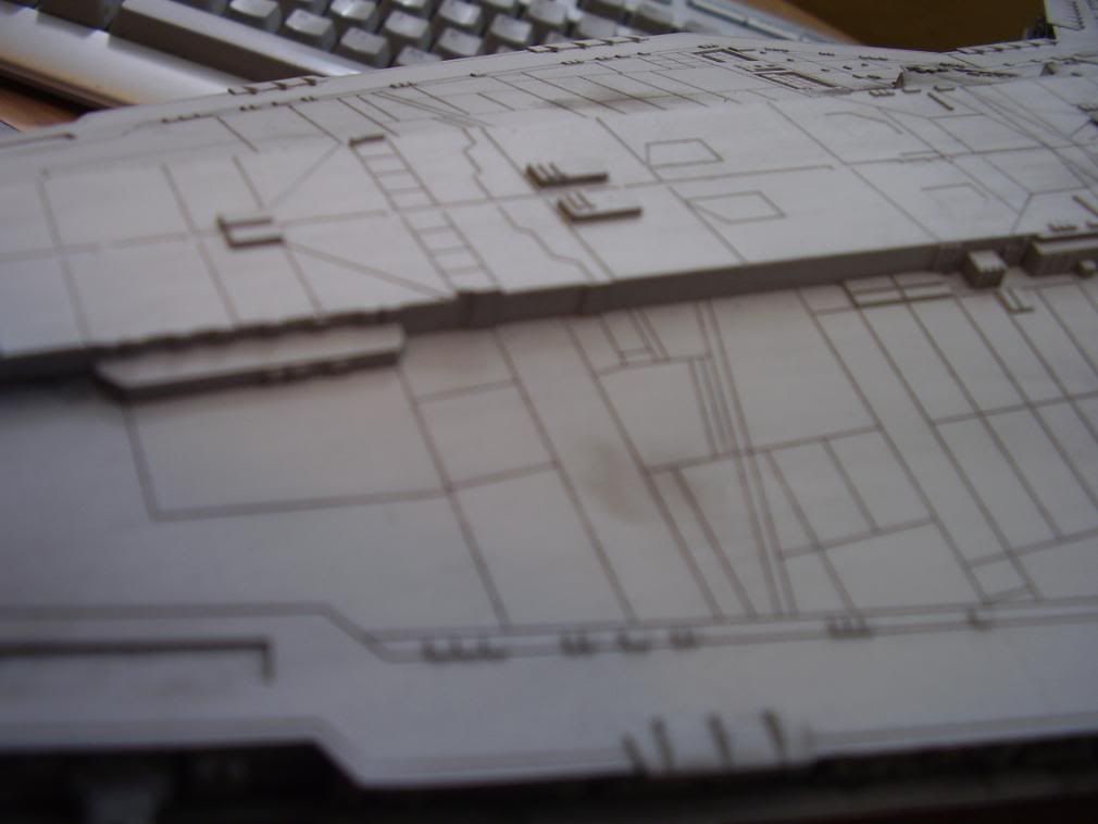

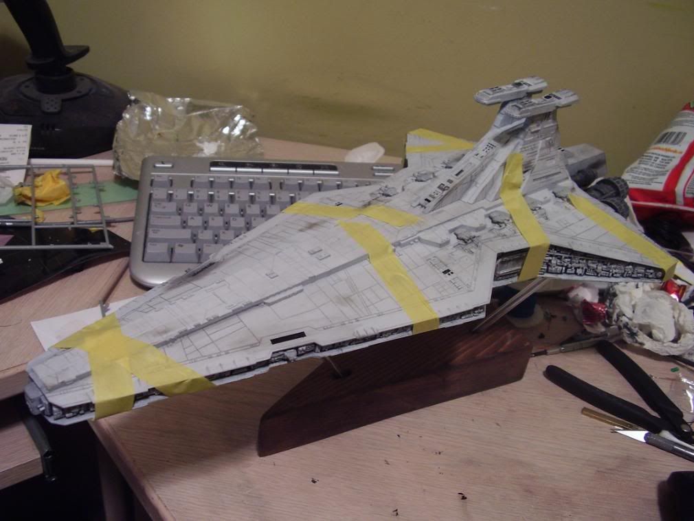

Parts fit is awesome, and taking a hint from bandai, nearly all parts join on natural panel lines, or are covered by additional detail parts. As you can see in the last pic, there's plenty of room inside the hull to fit all the lights and wires, so it should assemble really easily.

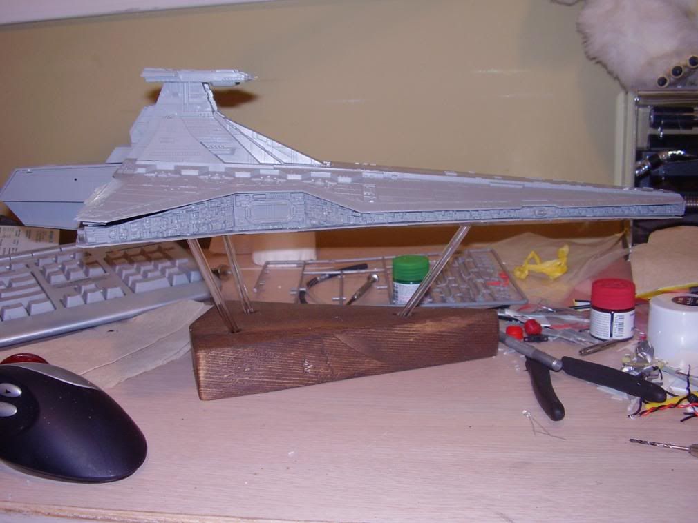

originally an old 2x6, I borrowed my dad's chopsaw to cut it into a Star Destroyer-esque shape and drilled three 1/4" holes so I could insert some acrylic tube which will fit into holes drilled into the lower hull to support the model. An added bonus of using this mounting technique is that because the acrylic tube is flexible, the ship's position on the base can be adjusted somewhat, particularly the pitch of the bow... though I will have to fashion some kind of stoppers to keep them from slipping out of their mounting holes. Power will be supplied via a hole drilled in the back end to accommodate the power plug and wires which will feed into the model through the bow support rod.
