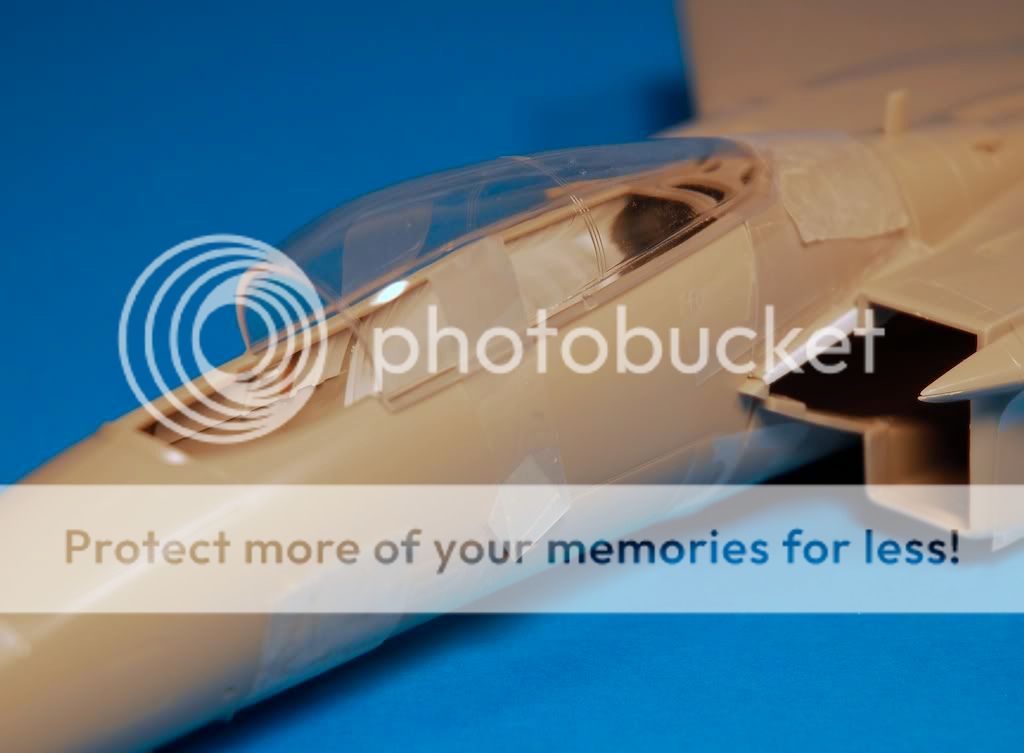

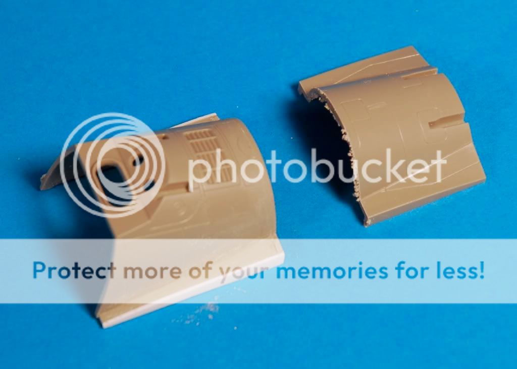

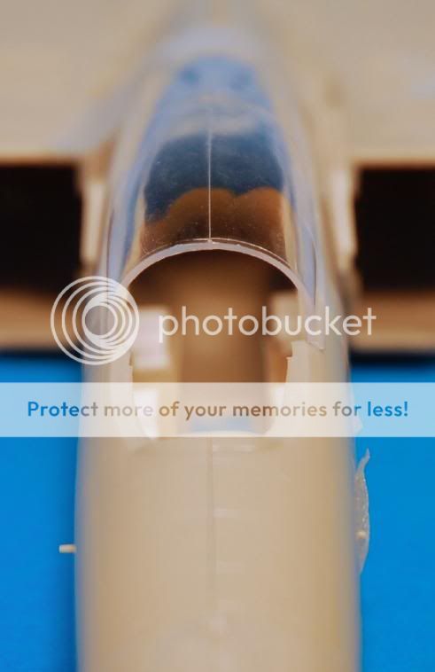

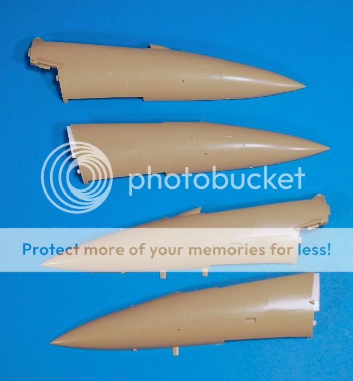

Cliff C Posted August 14, 2008 Author Share Posted August 14, 2008 The second step was to fit the forward fuselage. This is the Revell kit pieces before and after. You can see that on two of fuseage pieces, the rear section has been removed. Here is a picture of all the pieces taped together. Still rough but not bad fit for the first test fit. The Hasegawa canopy fits very well. The front of the canopy is slightly wider than the fuselage but that will go away once I attach the rear deck section under the canopy. Thanks for taking a look. -Cliff Quote Link to post Share on other sites

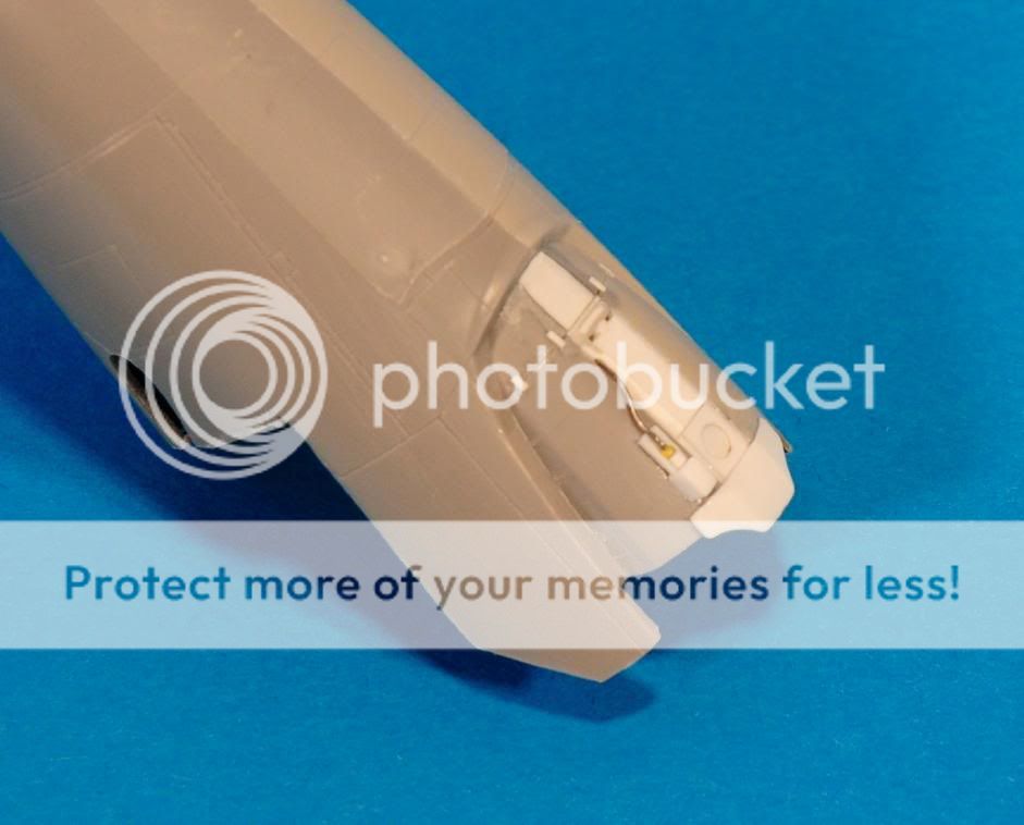

Cliff C Posted August 15, 2008 Author Share Posted August 15, 2008 For the IP cover, I removed the one off the Revell E and started with the Hasegawa as a base to add more detail. Once I had the basic detail, I removed the IP cover from the Hasegawa kit. Here's the rough fit on the Revell kit. I'll need to wait until it's permanently attached to add the rest of the detail. Quote Link to post Share on other sites

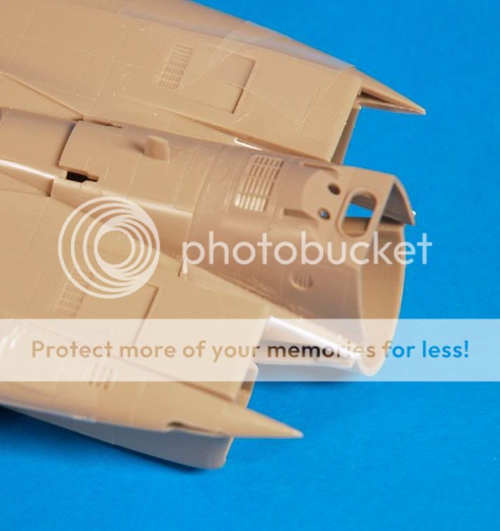

galfa Posted August 15, 2008 Share Posted August 15, 2008 Follow the link: http://partsrparts.homestead.com/F15tailcones.html In other words: Revell exhausts are too long. Galfa Quote Link to post Share on other sites
brahio Posted August 15, 2008 Share Posted August 15, 2008 Follow the link:http://partsrparts.homestead.com/F15tailcones.html In other words: Revell exhausts are too long. Not at all! Did you read the article? Tamiya exhausts are too long, not Revell. And anyway the link to 1/32 tailcones comparison is useless for this 1/48 build :) Quote Link to post Share on other sites
galfa Posted August 15, 2008 Share Posted August 15, 2008 Not at all! Did you read the article? Tamiya exhausts are too long, not Revell.And anyway the link to 1/32 tailcones comparison is useless for this 1/48 build Yes indeed. Revell 1/48 F-15E is a scale-down edition of the 1/32 Tamiya tool. As a result, for the sake of accuracy the 1/48 Revell exhausts need to be shortened. Same is true about the 1/48 Aires exhausts. Do you own check. Given that the actual aircraft parts measure 21,0 inches: 1/32 = 0,65 inches (1.67 cms). Instead, Tamiya exhausts are 0,87 inches, 0,22 too long (0.60 cms). 1/48 = 0,44 inches (1.11 cms). Instead, Revell exhausts (and Aires) are 0,58 inches, 0,14 too long (0.40 cms). Galfa Quote Link to post Share on other sites

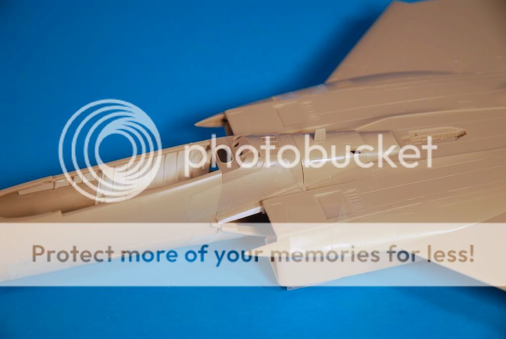

Cyrus Tan Posted August 15, 2008 Share Posted August 15, 2008 Hey Cliff...good to see your work here! :D That's a clever idea! I'm not an Eagle expert, but the only problem that I can see with this combo is that the speed brake won't be entirely accurate. On the real aircraft, the back end of the speed brake actually rests on top of the airframe (not recessed) like in the kit. Only the front half is recessed. Even Hasagawa got this wrong. The old Monogram kit is the only one to my knowledge that actually got this part right. Other than that...it's coming along well! See ya around. :lol: Quote Link to post Share on other sites
tomcatter727 Posted August 16, 2008 Share Posted August 16, 2008 This is going to be a great model. I must say, the aggressor camo is very cool looking. I'm not an Eagle expert, but the only problem that I can see with this combo is that the speed brake won't be entirely accurate. On the real aircraft, the back end of the speed brake actually rests on top of the airframe (not recessed) like in the kit. Only the front half is recessed. Even Hasagawa got this wrong. The old Monogram kit is the only one to my knowledge that actually got this part right. Huh, didnt know that. As long as hes doing it brake down, all he has to do is shim it in the rear a little to make it stick out. Quote Link to post Share on other sites
