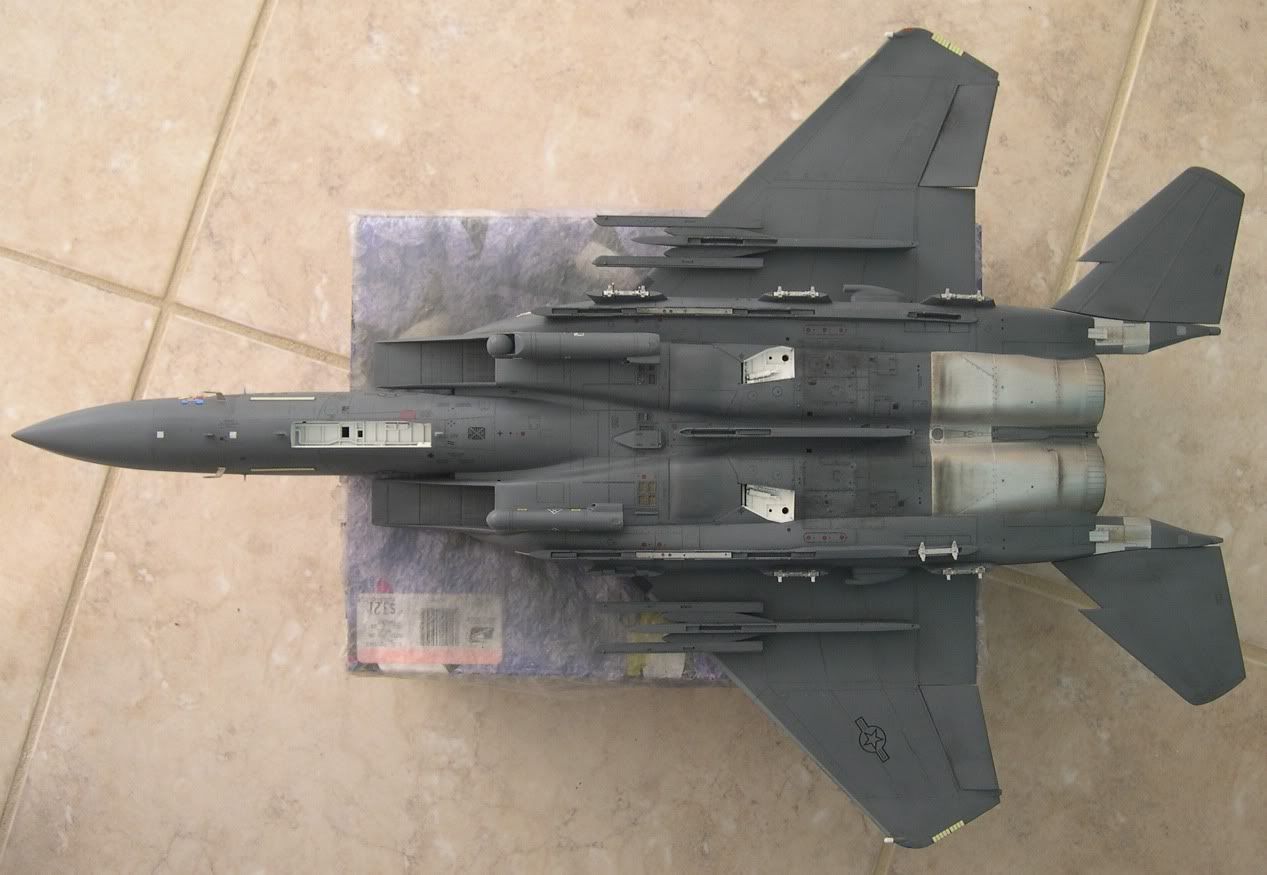

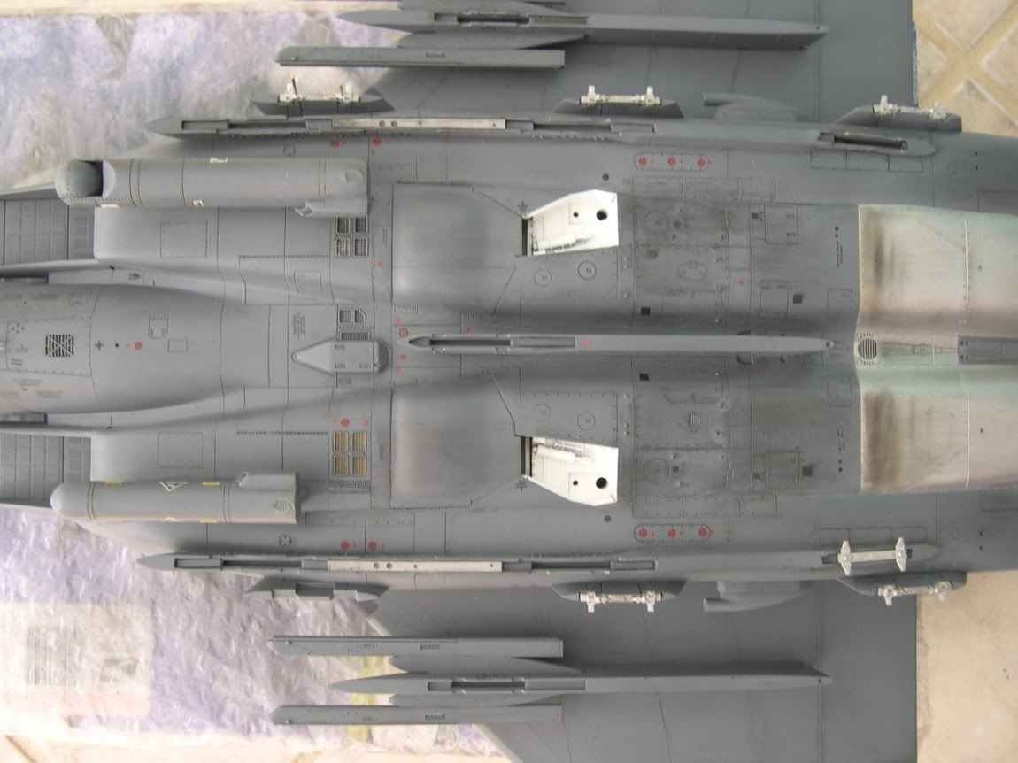

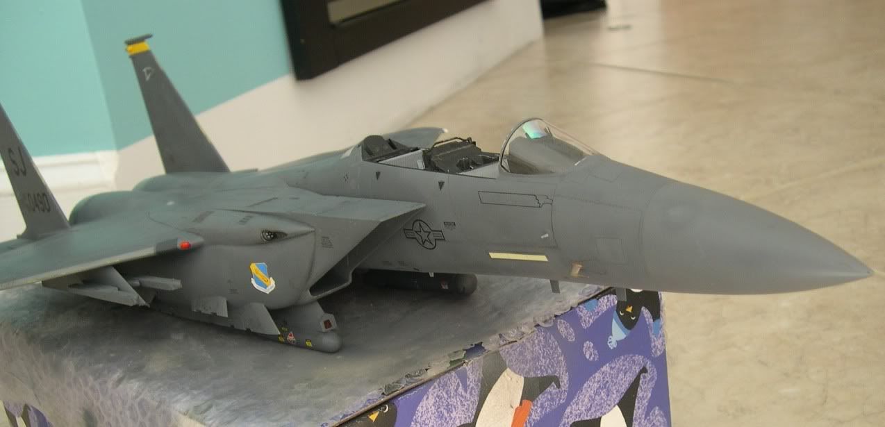

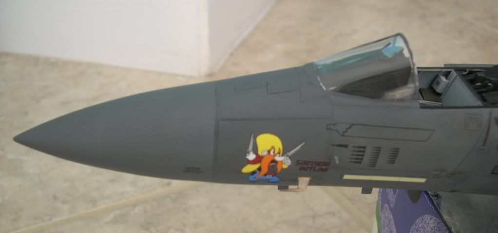

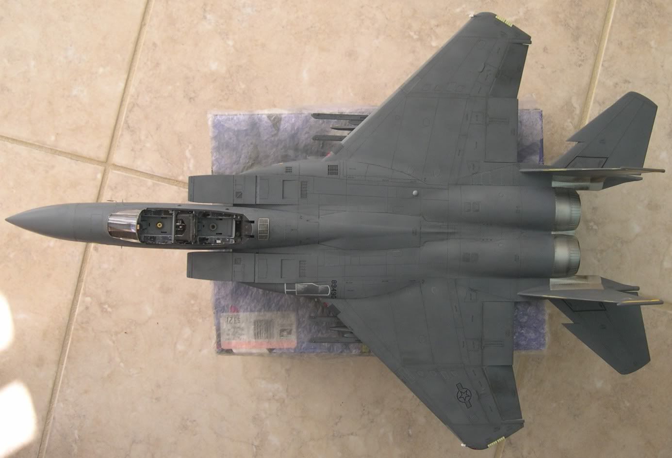

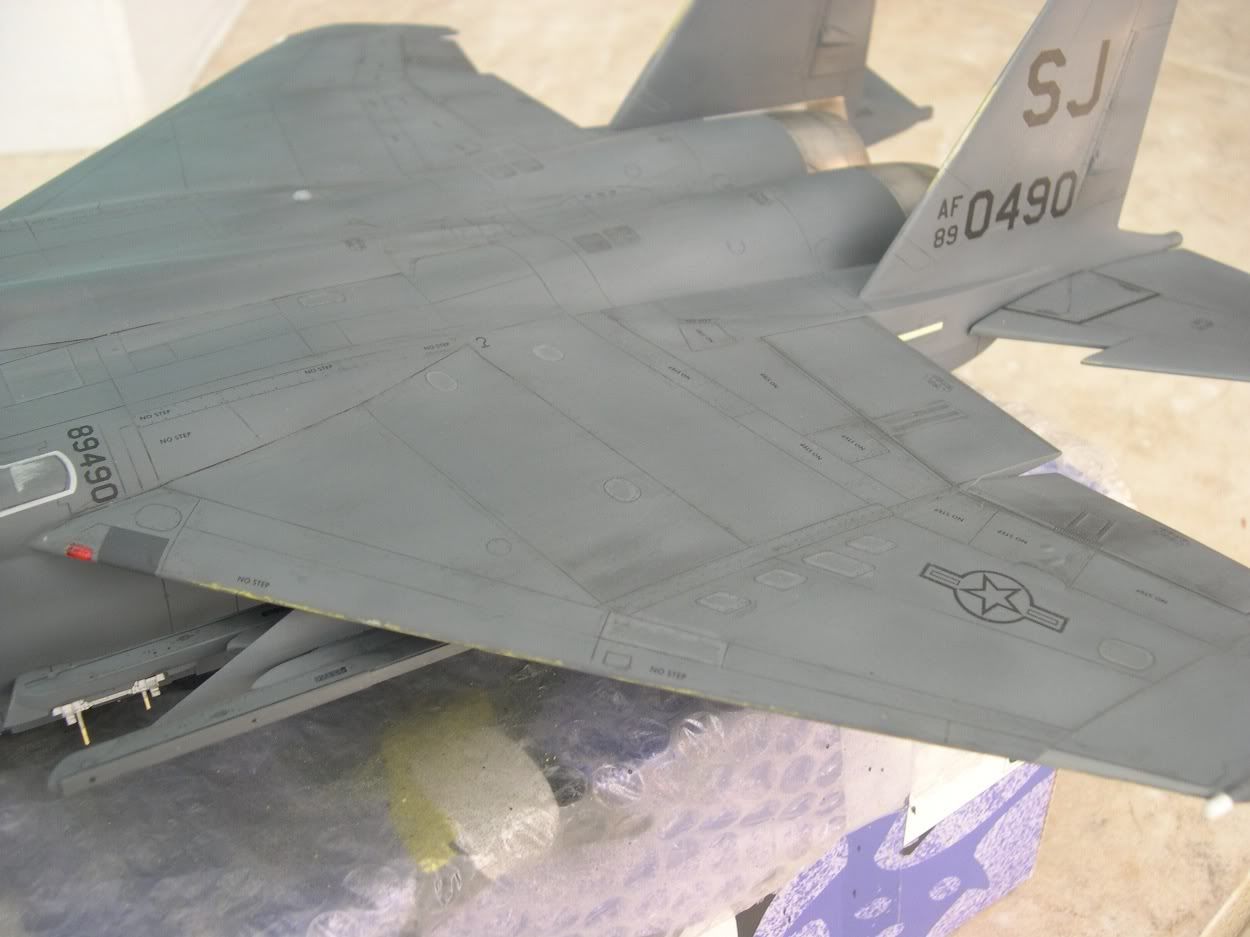

Marcel111 Posted April 4, 2009 Author Share Posted April 4, 2009 Progress on this kit seems to be very slow, and lately, I haven't had all that much time to work on the kit. Nonetheless, here is an update. Please critique and point out any mistakes. ... notice how the HUD changes appearance depending on the light direction... I tried to replicate the heated metal appearance of the pitot by brush-painting the tip with Humbrol Steel. I used the Eduard slime lights, I thought they would be a pain to apply, but things turned out ok. Hobbydecal dry transfers were used for much of the stencil data, they generally went on very nicely, although in two instances I lifted the underlying paint during application. I extended the paint chipping all the way to the lower intake leading edge (after a lot of reference checking), although I kept things very subtle. Next up are the wheel wells and the undercarriage. I don't really enjoy that part of the build, which is why I have pushed that off until now. Marcel Quote Link to post Share on other sites

strikeeagle801 Posted April 4, 2009 Share Posted April 4, 2009 Looking good. One small critique. You've got the GPS dot too far back. It should be in the middle of the panel immediately forward of where you've got it, towards the center of the airbrake, not the back. Other than that, looking good! Aaron Quote Link to post Share on other sites
geedubelyer Posted April 4, 2009 Share Posted April 4, 2009 Cracking update Marcel The paint chipping looks so good. You've obviously spent a great deal of time studying reference pictures and it shows. The underside weathering also looks very convincing with more dirt and grime showing aft of the wheel bays. Good stuff. The irridescent effect on the HUD is smart. It's a kick watching it change colour as you move around the model is n't it? I never get tired of that effect. ^_^ I like the difference in tones along the leading edge of the wing. One thing that you could do to improve the look still further is to slightly alter the red leading edge lights a little. Tamiya have them as large glass reflectors but the Mudhen versions are more of a rectangular shape. If you want to redo them simply stick a small rectangle of masking tape over the red and re-spray the grey over the top. It would only take a minute and would make your build ever more realistic looking. Just a thought......... :D I'm already looking forward to the next update. Quote Link to post Share on other sites

Marcel111 Posted April 5, 2009 Author Share Posted April 5, 2009 Thx for the encouragement, guys! Ken, thx again for your earlier advice on the paint chipping. Gerald, always good to hear back from the master... now that I have looked more closely at the red lights, I see what you mean, that will be an easy fix... consider it done. Aaron, thx for the heads-up. I'm sitting here scratching my head as to how I managed to misplace that dome, since I spent quite some time looking at where exactly it is meant to go Not sure I will fix it, that would require a lot of effort and I must say I'm getting worn out by this project, I've been on it for a full year now. Marcel Quote Link to post Share on other sites
