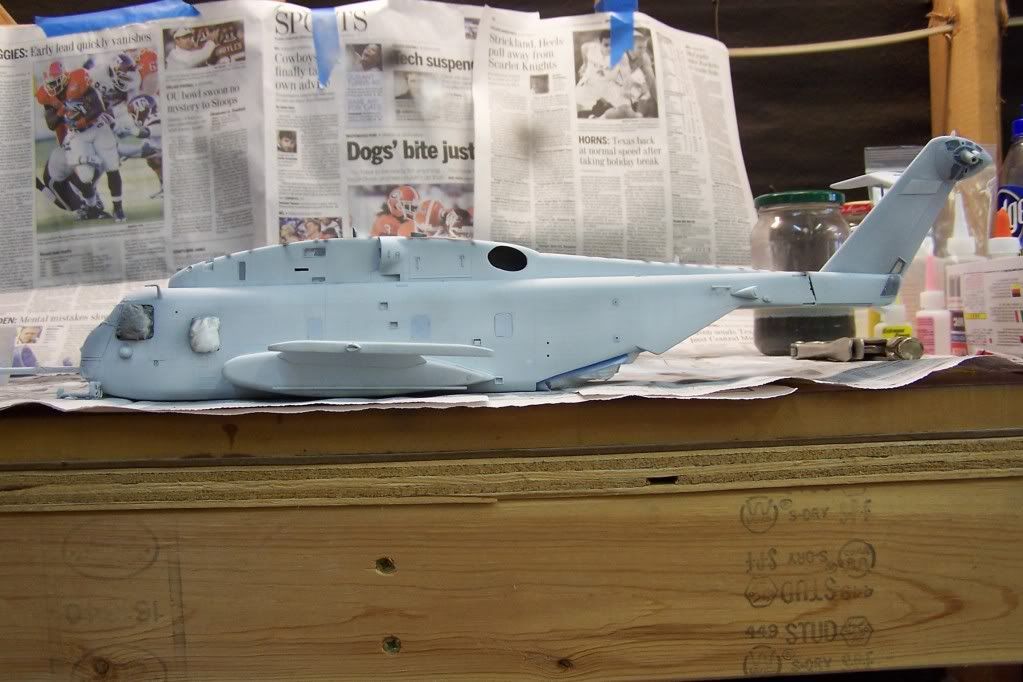

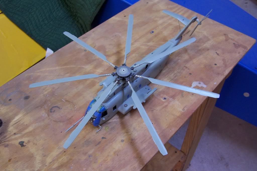

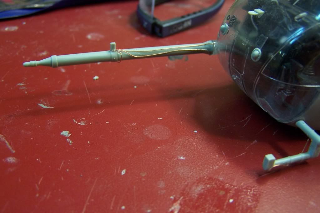

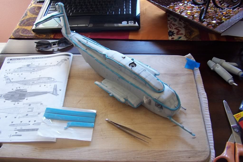

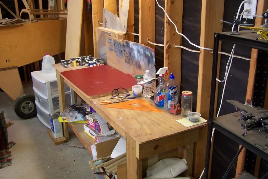

slick95 Posted August 22, 2009 Author Share Posted August 22, 2009 Thanks a lot guys! Here is one final update... The -53 is in the box right now, headed on a deployment to the closet. And one more of a rather sad and lonely looking work bench. It'll be a while, but the -53 will be back. Thanks everyone who has watched so far! SLICK Quote Link to post Share on other sites

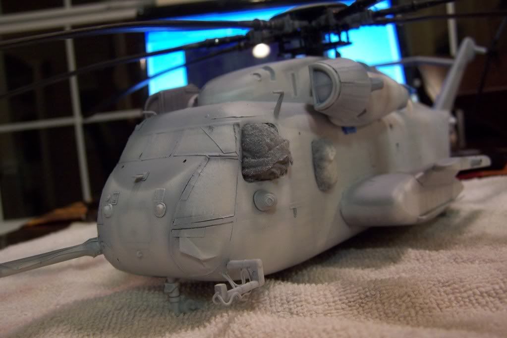

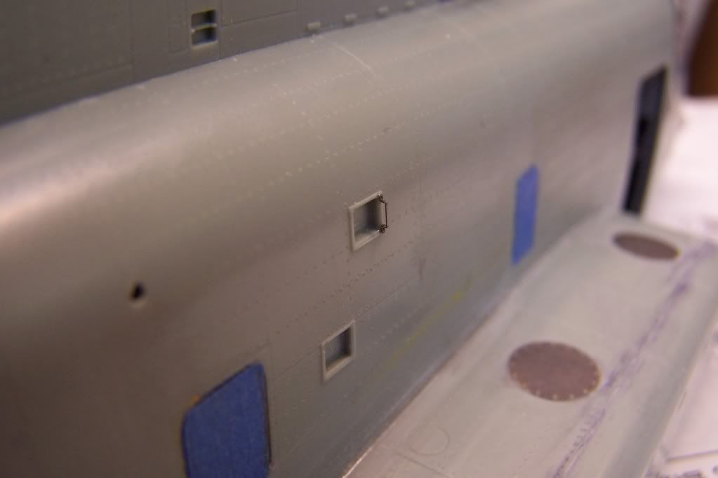

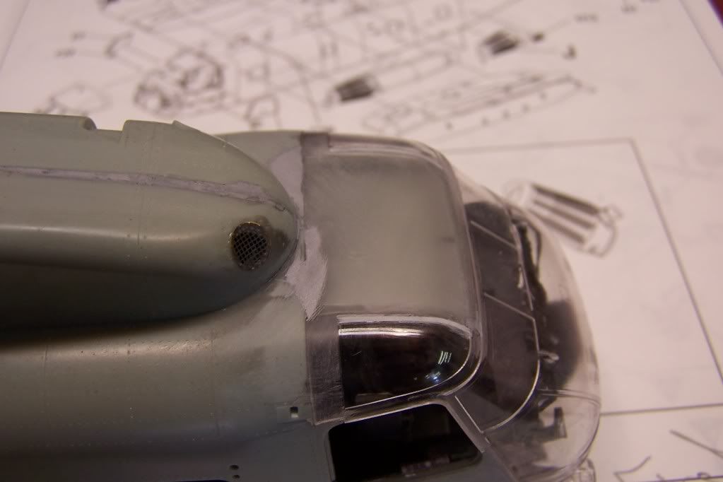

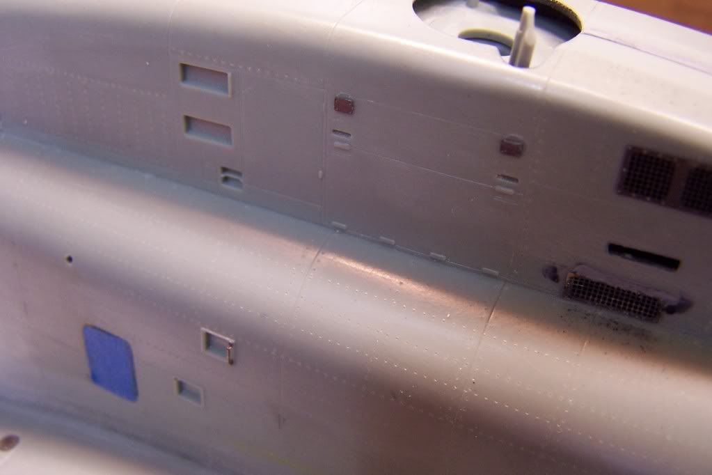

slick95 Posted December 24, 2009 Author Share Posted December 24, 2009 It's been a really long time, but in the past few weeks I've had a bit of a break from school...and now that it's Christmas time I've actually pulled this build back out and made some big progress! Some of the recent progress has been adding the majority of the external PE to the fuselage. I've also been doing a lot of filling, sanding, and re scribing lost panel lines. Here is the -53 in it's current state. Hopefully the majority of the remaining updates will be a bit more interesting. I should be painting the bird soon! SLICK Quote Link to post Share on other sites

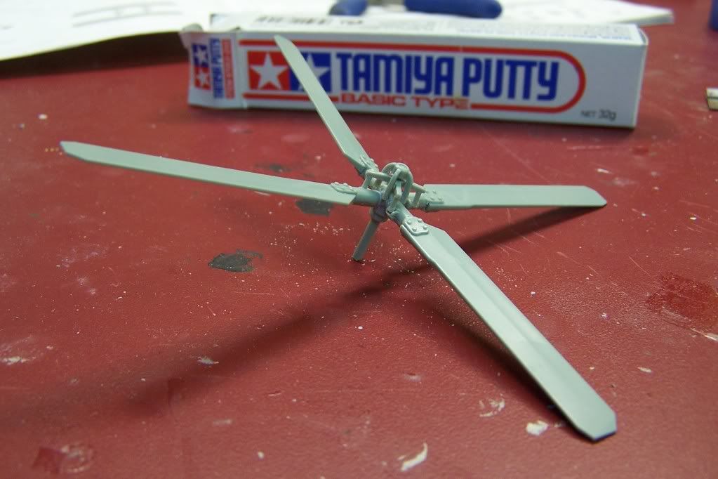

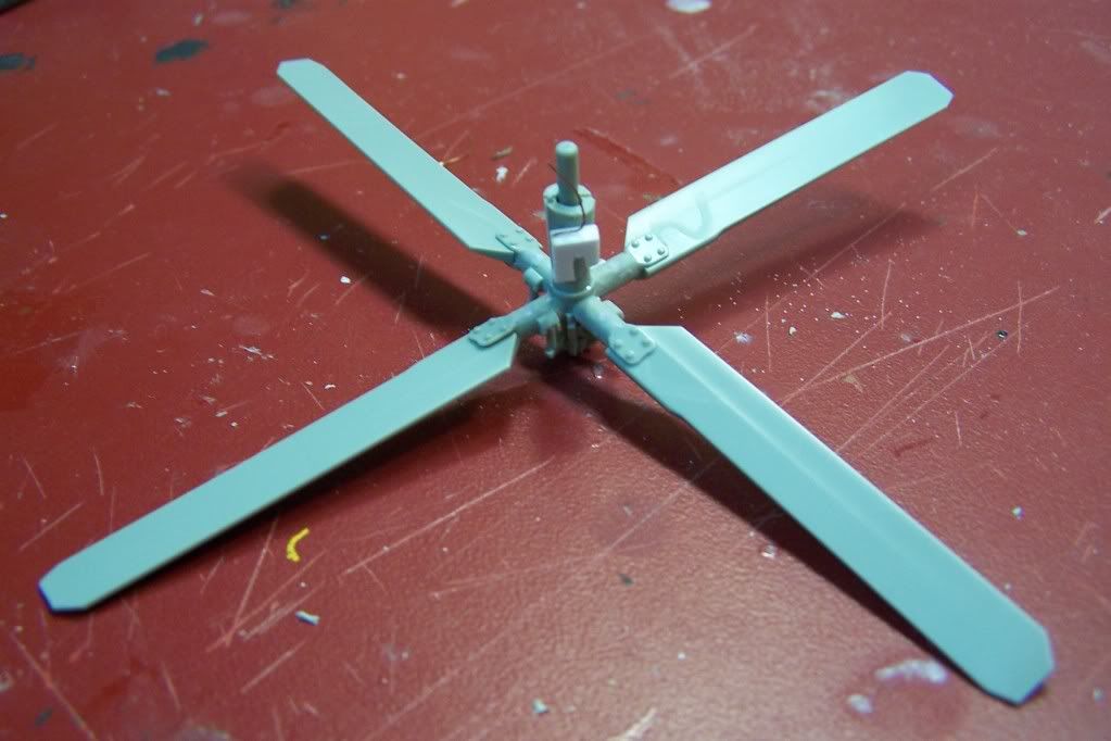

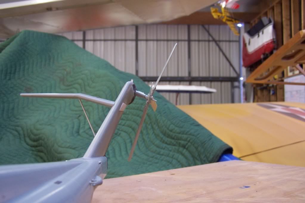

slick95 Posted December 26, 2009 Author Share Posted December 26, 2009 Thanks a lot everyone for the support! I'm happy to be back in the saddle again as well. Well, the past few days (mind you there have been lots of Christmas activities) I was able to get a lot of small sub-assemblies completed as well as the tail rotor. However, after going back and studying some of my ref. pics. I plan on cutting the tail rotor blades at their flapping hinge points and making them droop a bit like in the following pictures. http://farm3.static.flickr.com/2376/219268..._13654f3480.jpg http://i.pbase.com/o4/29/500829/1/53322007._MG_3712.jpg http://farm3.static.flickr.com/2362/234617..._53f4140196.jpg It's the second aircraft in this link: http://farm3.static.flickr.com/2711/410364..._08869fce5b.jpg Now, onto some pics! Thanks for looking! SLICK Quote Link to post Share on other sites

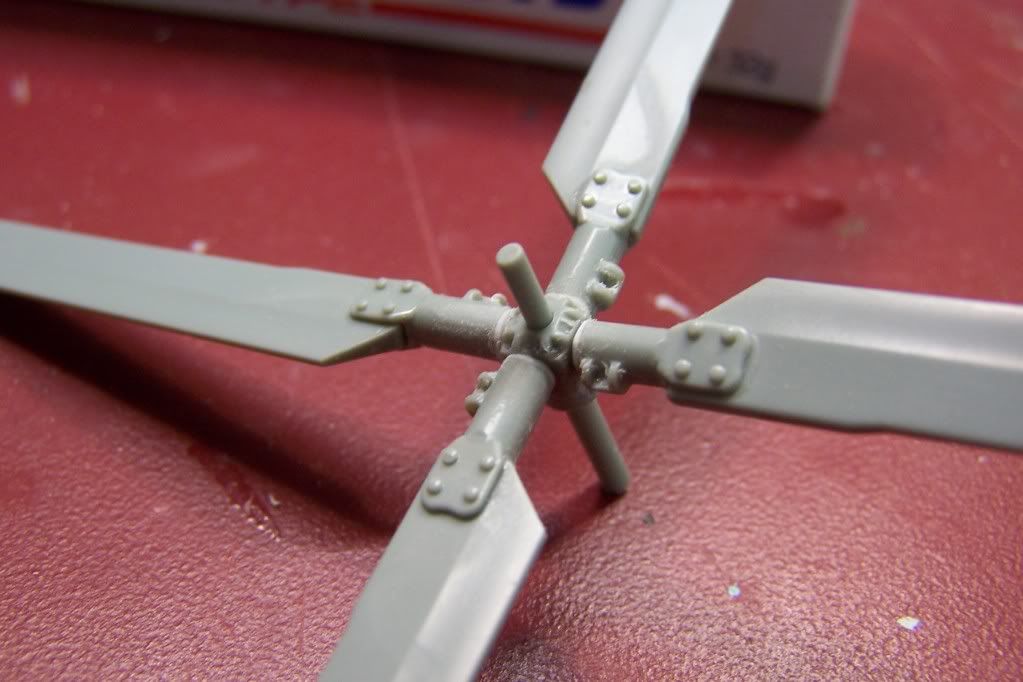

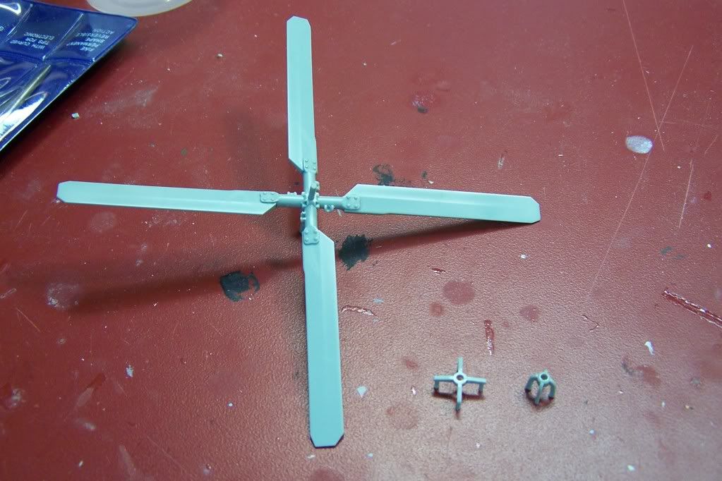

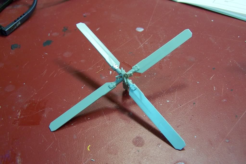

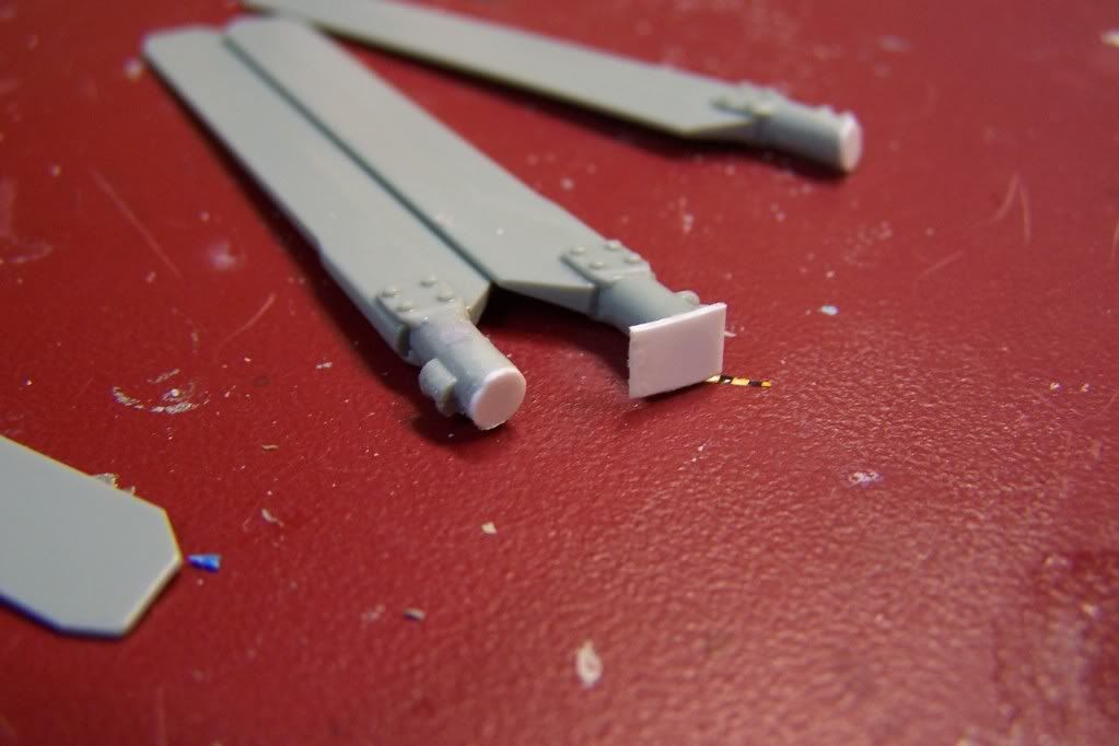

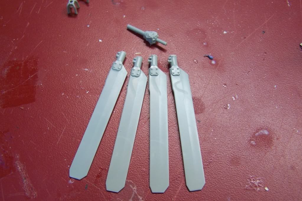

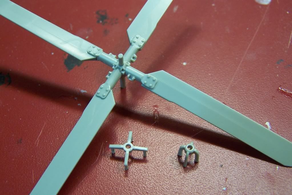

slick95 Posted December 28, 2009 Author Share Posted December 28, 2009 (edited) Thanks a lot guys! It is great to be back building again. I made some progress yesterday. At the moment I'm just finishing up some little details before painting begins. I was able to make it out to the LHS and pick up the required paints as well as my first Russian aircraft for a future build...an Su-25. First bit of update...some surgery on the tail rotor. I needed to begin by very carefully disassembling the already complete tail rotor. I also pulled the blades out and turned them around because I had glued them in place the wrong direction. Disassembling the tail rotor... I then sawed off all the blades at their flapping hinge locations. Then, to take into account the the material the saw had removed, I added some thin fillers to the blades. After putting in the fillers I lightly sanded and angle to them in order give the drooped look. The blades glued back onto the rotor hub... A quick check to see if the droop looks correct... I then filled the gaps with some small drops of thick CA and carefully sanded the rotor hub smooth before adding the pieces back onto the tail rotor. Afterwords, I did a bit of dry fitting and noticed that my main rotor blades were not drooped nearly enough. A pan of boiling water and about half an hour later I had drooped blades... Until next time! SLICK Edited December 28, 2009 by slick95 Quote Link to post Share on other sites
Schwarze 1 - The Vulture Posted December 28, 2009 Share Posted December 28, 2009 I love what you've done on the rotors. Did you just dip the rotor on boiling water and then used a bit of weight to make them droop? Are the drooping tail rotors applicable to Pave Lows as well? Quote Link to post Share on other sites
slick95 Posted December 29, 2009 Author Share Posted December 29, 2009 Thanks a lot for the complement. Yes, for the most part that is exactly what I did. I dipped the first blade into the boiling water (maybe 15-25 seconds) up to the root of the blade then removed it from the water and applied pressure on the blade tip with my fingers until I obtained the desired droop. Then I used that blade as my control and drooped the rest according to the first blade. If the blade gets drooped too much just put it back in the water and bend it back the other direction. It really is a pretty easy technique. As for the tail rotor on Pave Lows, the blades (as on nearly every helicopter) do have flapping hinges just like the -53E. However, the vertical stabilizer on the Pave Low is not leaned over like on the -53E, therefore the tail rotor blades would almost never droop....ie. the Pave Low has a perfectly vertical, vertical stabilizer, and gravity would not pull the blades down. Hope this helps! SLICK Quote Link to post Share on other sites

jcasilimas Posted December 29, 2009 Share Posted December 29, 2009 Hi Slick, great job!!! I have a question, what kind of DYMO tape do you use for the ribets? Javier Quote Link to post Share on other sites

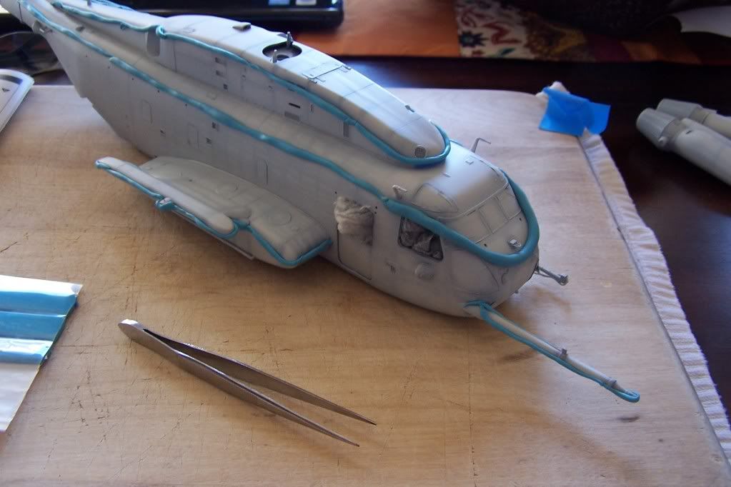

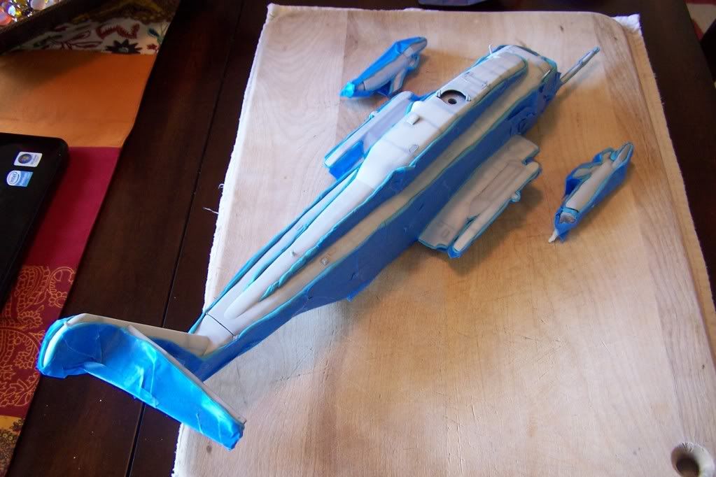

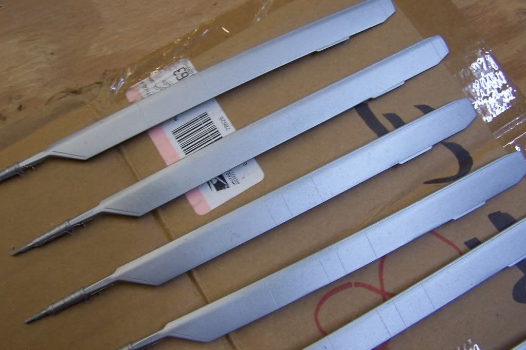

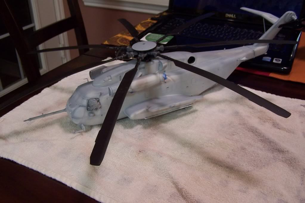

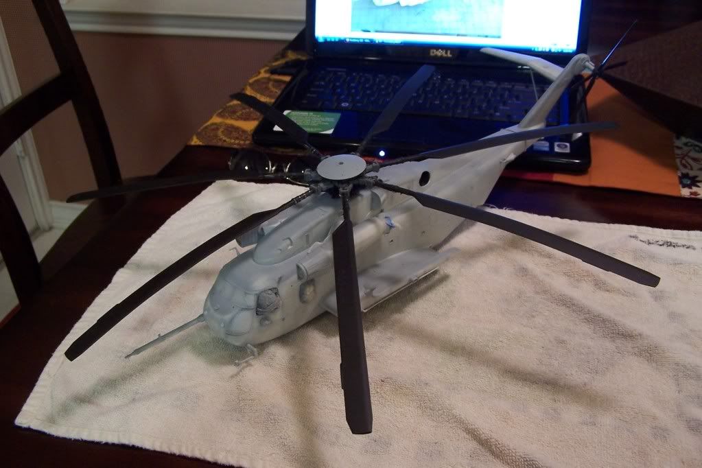

slick95 Posted January 4, 2010 Author Share Posted January 4, 2010 Thanks a lot everyone! Javier, I'm not sure if there are different types of DYMO tape, but what I had was a three pack box of the DYMO plastic labeling tape. The stuff works great as a straight edge! A pretty big update to talk about! Painting! I have completed all of the base coat painting and the next step will be to future coat before decals and weathering. Here are the blades in their silver base coat. I also started the fuselage by spraying the cockpit area black in order to show through the clear nose piece: ...and the fuselage in white primer: Here are the blades in their overall black coat. (I don't have pictures yet, but I did some work on the blades since, which I will show in the next update) Here is the fuselage in the light gray while being masked for the darker gray. And the final base coat pictures: Took about four days of painting to get to this point, but I'm really happy with the results so far. Hopefully I don't screw up the weathering..it's always a scary part of the build... Thanks for looking! SLICK Quote Link to post Share on other sites
AnthonyWan Posted January 4, 2010 Share Posted January 4, 2010 Fantastic paintwork Slick I assume you've taken some fine sandpaper to the blades and slightly worn down the black such that the silver showed thru? ^_^ Can't wait for more pictures. -Awan Quote Link to post Share on other sites
