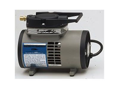

lgl007 Posted July 24, 2009 Share Posted July 24, 2009 Hi guys... So I have very successfully built 4 aircraft now using my Paasche single action airbrush without fail... Today while spraying all the white bits for my F-14B project the airbrush started spitting water... first time ever... ok so I kept brushing and again it happens. Actually it happened about 7 times. Takes about 5 seconds of straying to kinda get it all back to normal again... I have a Badger compressor and I do have a moisture trap as well... I was using Tamiya XF-1 with only a few drops of Tamiya thinners. Anyone know what the problem may be? Now, I did notice alot of condensation on the inside of the moisture trap... more so then ever before... but I'm at a loss folks... any help you guys can provide to cure this problem would be most appreciated... Here's my equipment: Badger 180-1 Compressor: Paasche R-75AR Moisture trap/pressure regulator: -Greg Quote Link to post Share on other sites

Edgar Posted July 24, 2009 Share Posted July 24, 2009 Any moisture will come out of air all the time it's under pressure. The air in the airbrush hose is still under pressure so moisture is still likely to come out of it, even though it's been through the moisture trap on the compressor. It always pays to have a condenser-style moisture trap in your hose, as close to the airbrush as you can get it. Edgar Quote Link to post Share on other sites

nzgunnie Posted July 25, 2009 Share Posted July 25, 2009 Where in the system is the water trap? If it's right at the compressor the air will still be warm and holding the air. The moisture will not be removed. You need to have the water trap at the other end of things, as close to the airbrush as possible. This will allow the air to cool, and the water to condense and be trapped. Quote Link to post Share on other sites
stevearado Posted July 25, 2009 Share Posted July 25, 2009 I had the same problem with a similar compressor (Paasche). I had the regulator/moisture trap along with the in line trap near the brush and still got water spots. I ended up buying another compressor with a tank, a no longer have the problem. Quote Link to post Share on other sites

johanl Posted July 25, 2009 Share Posted July 25, 2009 (edited) Maybe you can try this ? I had that problem too. now, before I start airbrushing I disconnect the hose from the airbrush and let the compressor run for a few minutes while holding the hose in a straight line down under an angle. After a minute of so the water thats in the hose, condensed from the previous time I used the airbrush, starts coming out. (the hose is 4 m long). (If you hold your hand at a distance (1 inch) from the hoseoutlet, you can feel the water.) When the water stops coming out I connect the hose again to the airbrush and start. Never had the problem (spitting water while airbrushing) again. So, in my case, the water that was coming out of the airbrush was condensed water from the previous time that collected in the hose. Johan Edited July 25, 2009 by johanl Quote Link to post Share on other sites
lgl007 Posted July 25, 2009 Author Share Posted July 25, 2009 Hi guys... Thanks for all your responses. Going to try Johan's method first to see if that's the prob... failing that I'll have to think about other more invasive methods of trying to fix the problem as per all your various noted methods of dealing with the problem at hand... Thanks again guys... cheers! -Greg Quote Link to post Share on other sites
