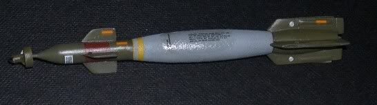

otis252 Posted August 27, 2009 Share Posted August 27, 2009 I've wonered about using that paint for USN/USMC bombs in 32nd scale. What do you think? Chuck Quote Link to post Share on other sites

Marcel111 Posted August 27, 2009 Author Share Posted August 27, 2009 I've wonered about using that paint for USN/USMC bombs in 32nd scale. What do you think?Chuck I've actually done it and it works really well. The bomb in question will go onto this hornet, I'll post a pic as soon as it's done. Quote Link to post Share on other sites

Marcel111 Posted August 29, 2009 Author Share Posted August 29, 2009 Thx for the additional comments, guys! Chuck, I have used the same method to simulate the fire retardent coating on Navy/Marine bombs, have a look below. The bomb is of course not finished yet but you get the idea. I used several coats of ordinary paint over the textured paint to dull the effect, since those coats don't seem all that rough. Incidentally (and somewhat miraculously), notice how it is still possible to apply a decal over that rough surface if Future is used as the decals softening solution. Cheers, Marcel Quote Link to post Share on other sites

chuck540z3 Posted September 16, 2009 Share Posted September 16, 2009 (edited) Great progress so far, which is especially interesting to me since I think this will also be my next build. One suggestion, which I'm sure you've done already, is to hit those bombs with Future again to smooth out the decal edges prior to dull coat. I used the stippled glue method for the ablative coating on Navy bombs before, but your method is WAY better. Edited September 16, 2009 by chuck540z3 Quote Link to post Share on other sites
Marcel111 Posted September 18, 2009 Author Share Posted September 18, 2009 Great progress so far, which is especially interesting to me since I think this will also be my next build. One suggestion, which I'm sure you've done already, is to hit those bombs with Future again to smooth out the decal edges prior to dull coat. I used the stippled glue method for the ablative coating on Navy bombs before, but your method is WAY better. :D Thx Chuck! Thx for the heads up on hitting the bomb decals again with Future, I may actually have overlooked that, haven't touched the bomb in months. In general, I only have two key suggestions with the kit (both things I screwed up): Get a resin intake set that doesn't have the intakes throttled (you've probably got hose already) and don't drop the flaps past the underside of the fuselarge (I'm sure you're on top of this already). Cheers, Marcel Quote Link to post Share on other sites
