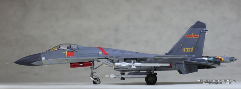

Fantastic work, as usual Haneto - you are now the Flanker Man :thumbsup::thumbsup:
This is in no way a crticism of your work - its more about the ICM kit - and that Hasegawa canopy.
I know you all think that the Airfix canopy is too small - but I reckon that with the Hasegawa canopy, the ICM Flanker one is now too big !!!
It is only slight - but check out these two photos............
The first is Haneto's excellent ICM Flanker.....

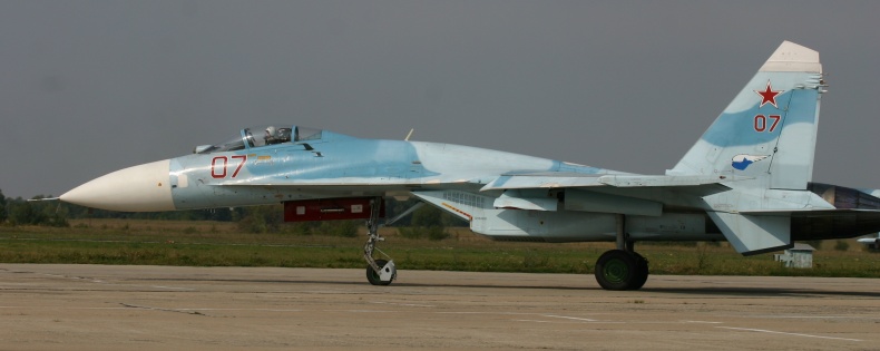

.... and this is the real thing - as close to a side view I have got....
It isn't much - but I reckon that Hasegawa canopy is too tall....
What do you guys think ???
Cheers
Ken
PS - I just noticed the curve of the spine - never noticed before that it is also wrong - Airfix & ICM
Yep,you are right,Ken!
The Hasegawa kit canopy is too tall which I reliazed in my last Airfix built.
So I chose to make the master and vacform the canopy myself.
Here is the result:
But one thing,ICM did the nosecone correctly(compared with Slylark's real thing references.)
I insert 0.5mm plastic sheet on the upper half of the nosecone during assembling and after sanding you can get the problem solved.
The too large Hasegawa windshield/canopy makes the nosecone looks a bit small while the size is correct on ICM kit.
