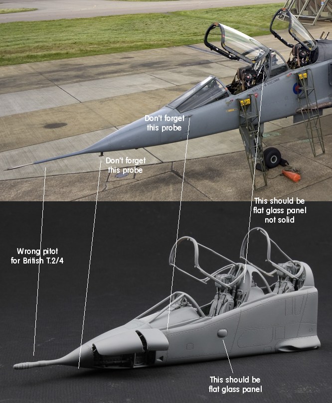

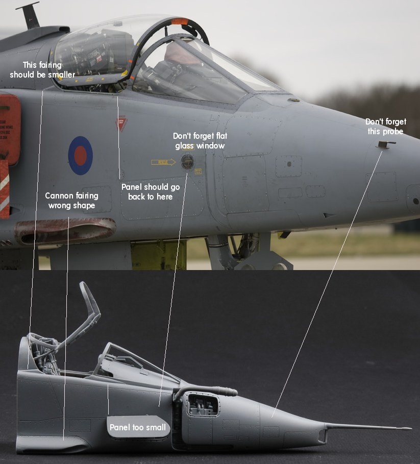

Eric F Posted November 16, 2009 Share Posted November 16, 2009 Song - this looks very good so far. A few small problem areas though: Hi Song, First of all, thank you very much for designing these Jaguar. A lot of french modelers have been waiting for long to have a new and correct Jaguar. This first result is realy good compared to the last 1/48 models. Congratulations Song! For my constructive remarks I use DamienB post to illustrate my coments: 1- I think about the cockpit where, in my opinion, the dimension between aft bulkhead and windsheald seems to be too short. It appears on the single seat master and on twin seat aft cockpit. As a result, canon fairing also seems to be too short. Solution should be perhaps to increase fuselage length by few millimeters at that place. 2- Windsheald seems to be too flat on single seat compared to the twin seat where they have a good shape 3- Regarding belly tanks, forward section has to be larger compared to aft one. 4- To help you to correct the upper side of air intakes, it seems that fuselage upper side (just aft air intake) is little bit too rounded 5- Additionnal air intake are closed (spring loadded to close position) when engine is not running. Finally these are hereafter some propositions for french Jaguar weapons. - Barax, Barracuda and Phimat CME - ATLIS lazer Pod - AS 30 missile - AS 37 anti radar missile - Bombs: SAMP 250 kg - BAT 120 - Magic II missile - GBU 12 Once again congratulations Song for the whole job you 've done so far. I hope my remaks will help you. Kind regards Eric Quote Link to post Share on other sites
Kriegsketten Posted November 18, 2009 Share Posted November 18, 2009 (edited) Just a note: the panel under the missing forward probe looks too close to the two smaller panels to the rear of it. And the panel itself should be almost in-line with the two rear panels. Which brings to the question is the nose too short? Or are the two rear panels (and everything else) too forward? I think a good side view is needed for a much better comparison. Cheers, Lawrence Edited November 18, 2009 by Kriegsketten Quote Link to post Share on other sites
Kriegsketten Posted November 18, 2009 Share Posted November 18, 2009 I've found one good image to compare - indeed the nose is shorter than it should be (quite prominent) - all the panels are misplaced because of this Also the glass area on the nose cone (under the titot tube) should be more slanted / angled - not 89/90 degrees angle. The upper slope of the nose cone just before the long titot tube is too pronounced also - it should be sleeker and a straighter slope. I can't post the image here, pm me so I can e-mail you the image of comparisons. It will help you get the shape proper. Cheers. Lawrence Quote Link to post Share on other sites
