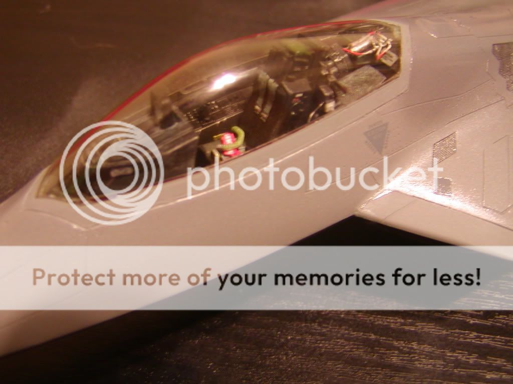

C-130CrewChief Posted November 29, 2009 Share Posted November 29, 2009 I like to temp install the canopy. Just like I read above. It works the best and leaves the cockpit protected throughout the entire build. In the end the canopy will be the last thing revealed. I use Elmers white glue to glue the canopy down. When I want to remove it I can easily flake the glue off. Curt Quote Link to post Share on other sites
