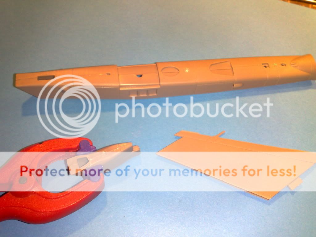

I started with the Sufa on Christmas Day.
Heres the spine and tailfin.

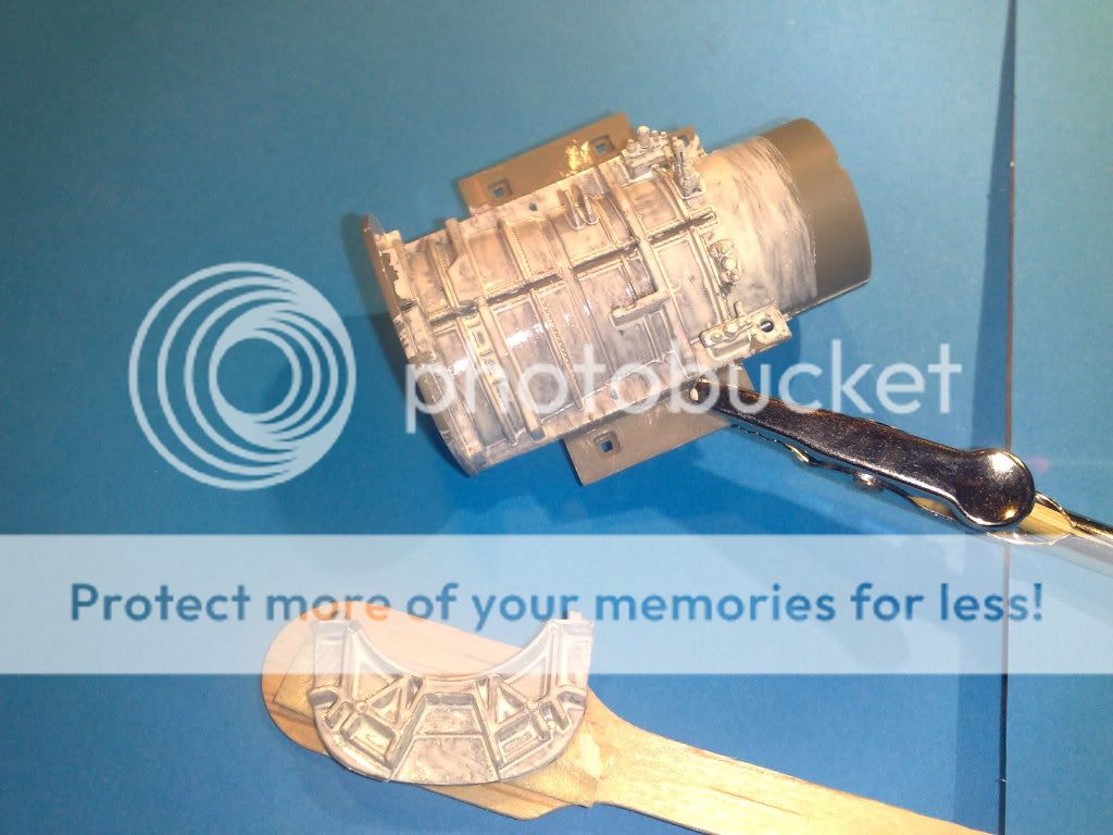

And the inlet. There were huge ejectorpins in the intake that took sometime to get rid of.
This is now fully painted and I've started on the mainlandingear well.

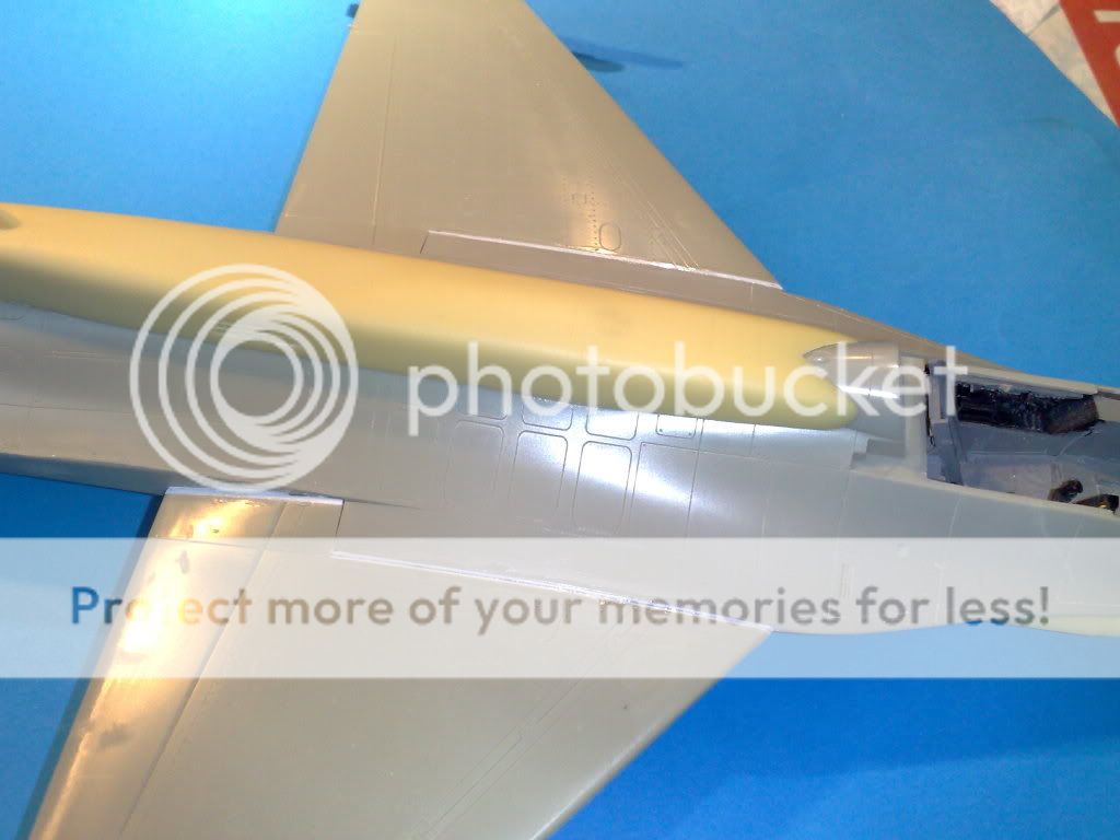

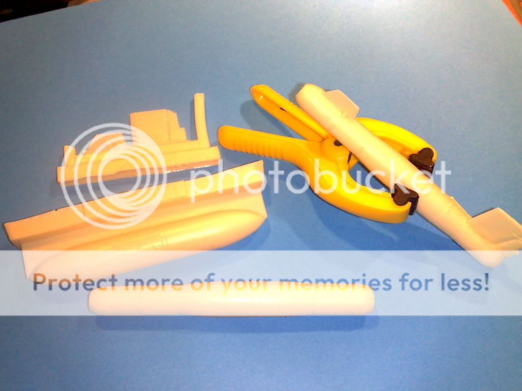

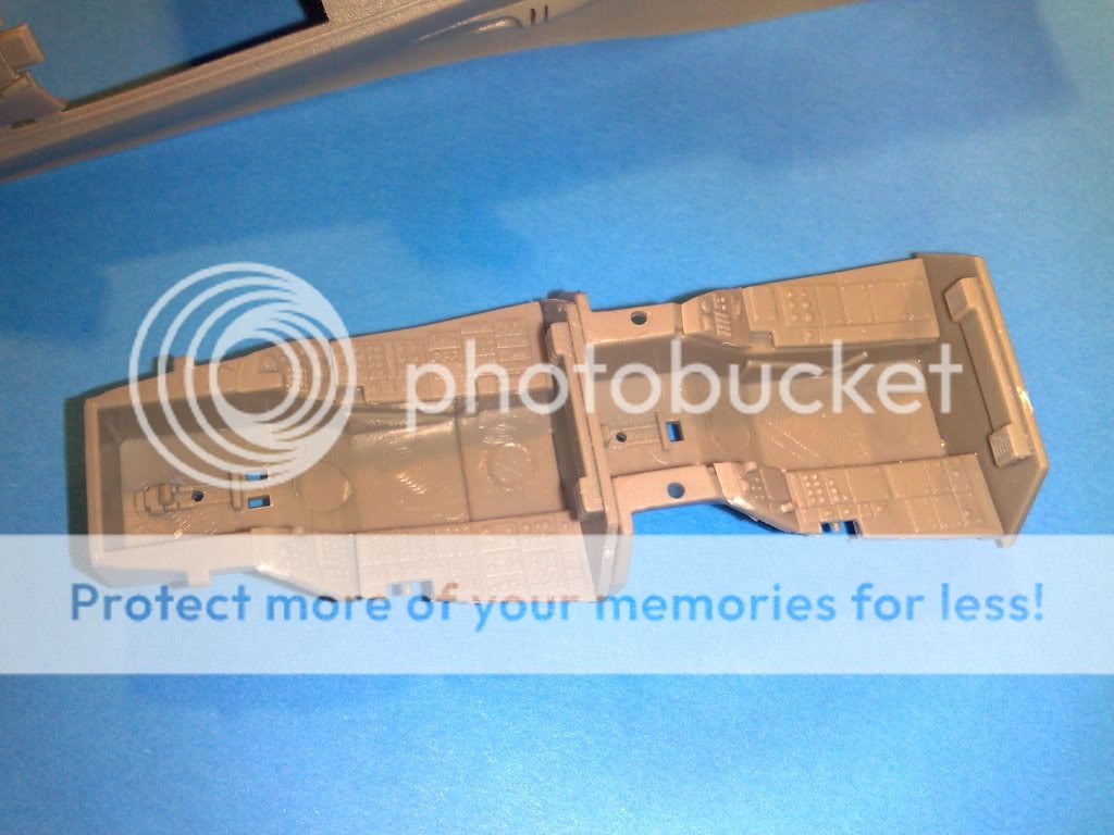

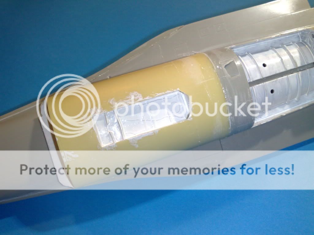

I've also put the Airwave spine in place on one of the D's. This one is the block 40 from Scorpion Sqn.
I'm also using an Aires cockpit on this aircraft.
I had to cut away quite a lot of material to get it to fit inside.
I did cut away a little to much on the kit, but that will be fixed later with some plasticard.

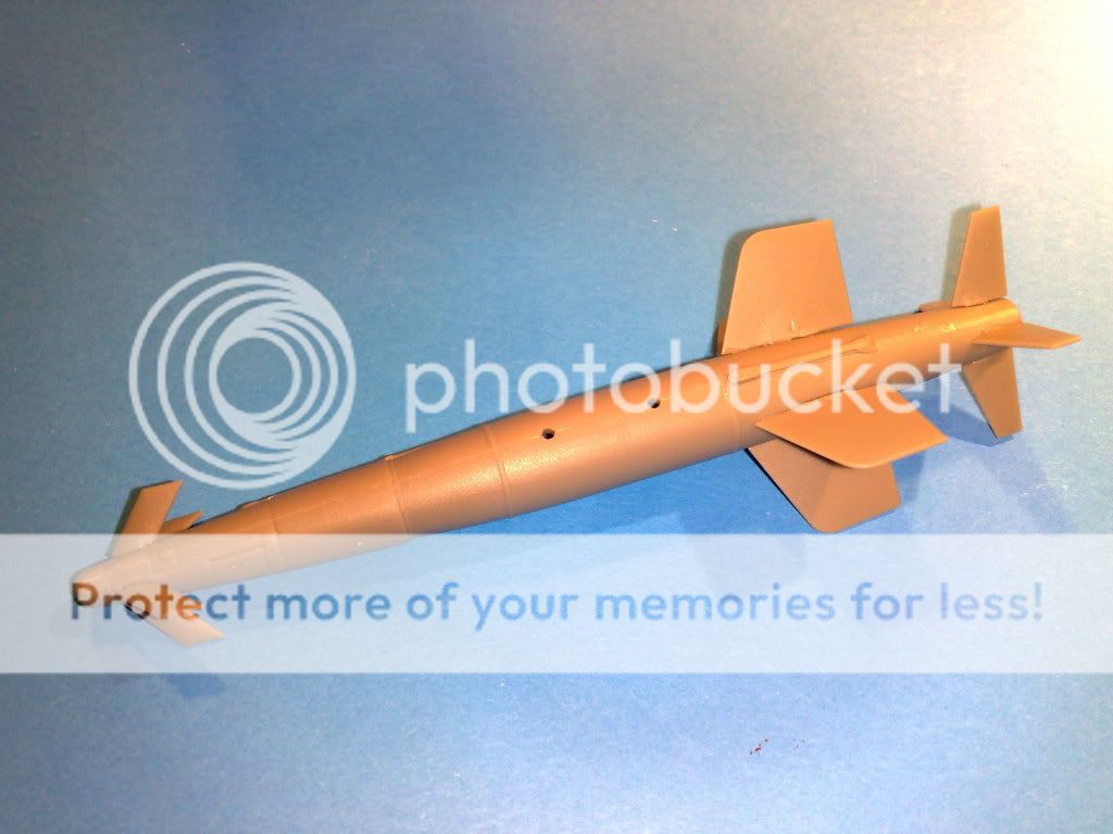

The GBU-15 I'm using for the Valley Sqn F-16D block 30 is from Isracast and they are absolutely stunning.

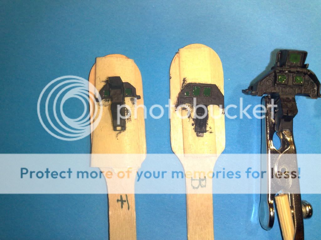

First out a comparision of cockpits.
The one to your left is Kinetics and the one to your right is from Aires.
The Aires cockpit is really beautiful, but the Kinetic isn't that bad.

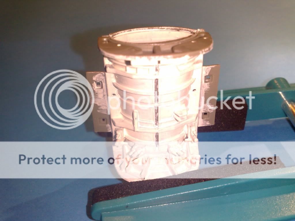

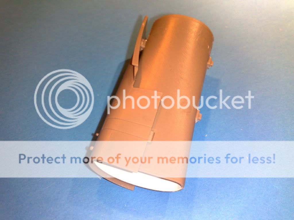

I've also put the intake for the Sufa together.
I couldn't get it to close fully, so I've inserted a small strip of .10 plasticard in the joint to get a clean fit.
It wasn't even .010 in width I had to sand the plasticard to get it to fit. I guess I could have just filled the gap with CA, but I don't like to sand CA.

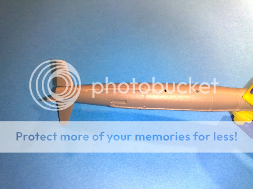

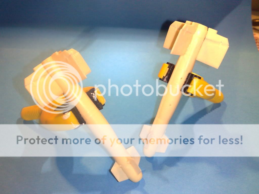

I have also started on the Spice bombs for the Barak C
I had to choose between Isras resin version of the platstic ones from Skunkwork. In the end I choose Skunkwork for the easier work on alignment of all the fins.
With twelve fins on each bomb it was much easier to work with styrene instead of resin.

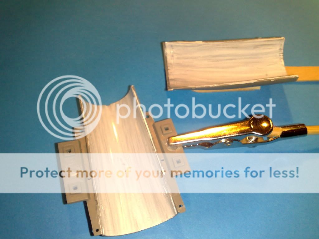

I've almost finished the intake.
It consist of 22 pieces altogether. And some are real small.
I did see the carpet monster at one time, but I gave him a swift kick and he disappeared back under the floorboards.

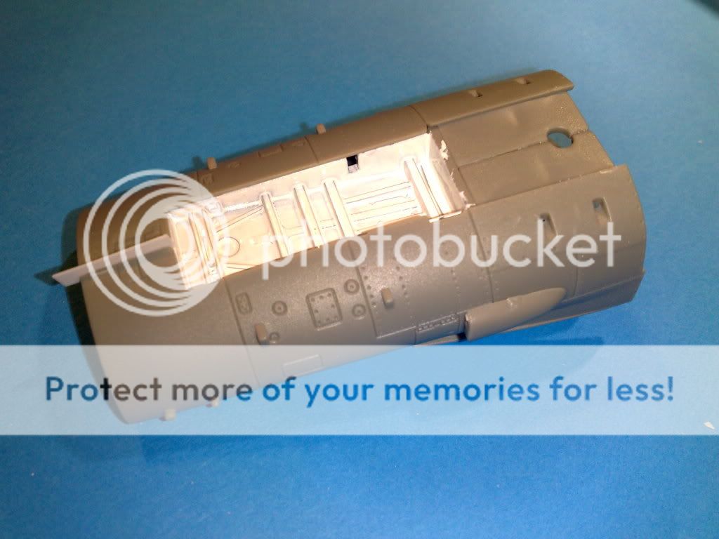

I've also got most of the mainlandinggear bay/intake together.
When all this has dried I can put it in the fuselage and continue with the rest of the landinggear bay.

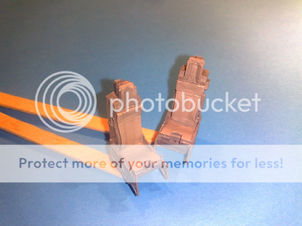

As for the Barak-D, I've cut the Aires ejectionseat from their castingblock and I've given them a first coat of grey.
Small thing really, but as soon as I can get the fuselage on the first two together I'll start the second Barak-D and the -C

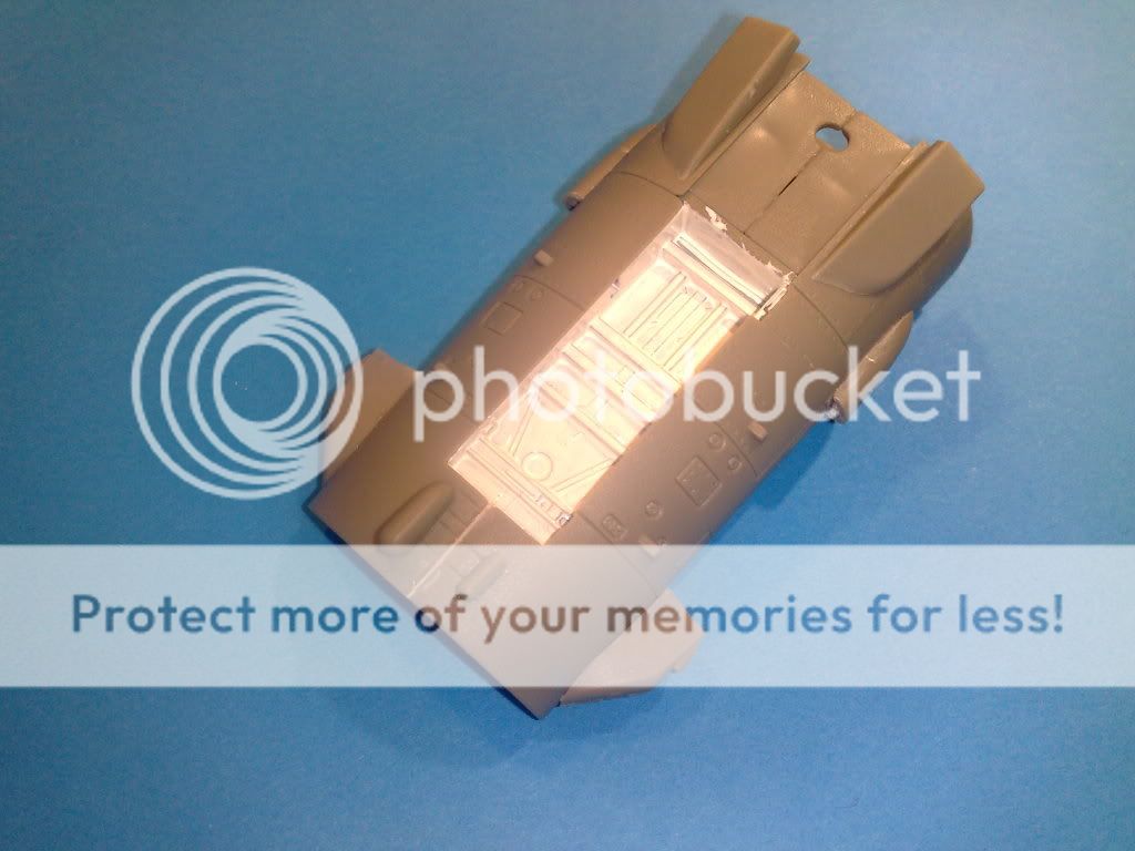

Hey I can't help it, here's another update.

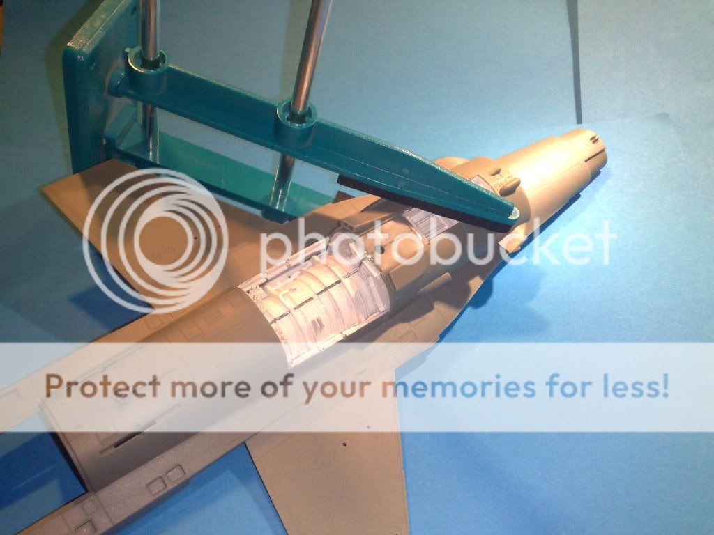

I've got the mainlandinggear bay glued to the fuselage.
After some fiddling the intake is also in place.
I had to thin down the sides where the intake meets the fuselage a bit to get a clean fit.

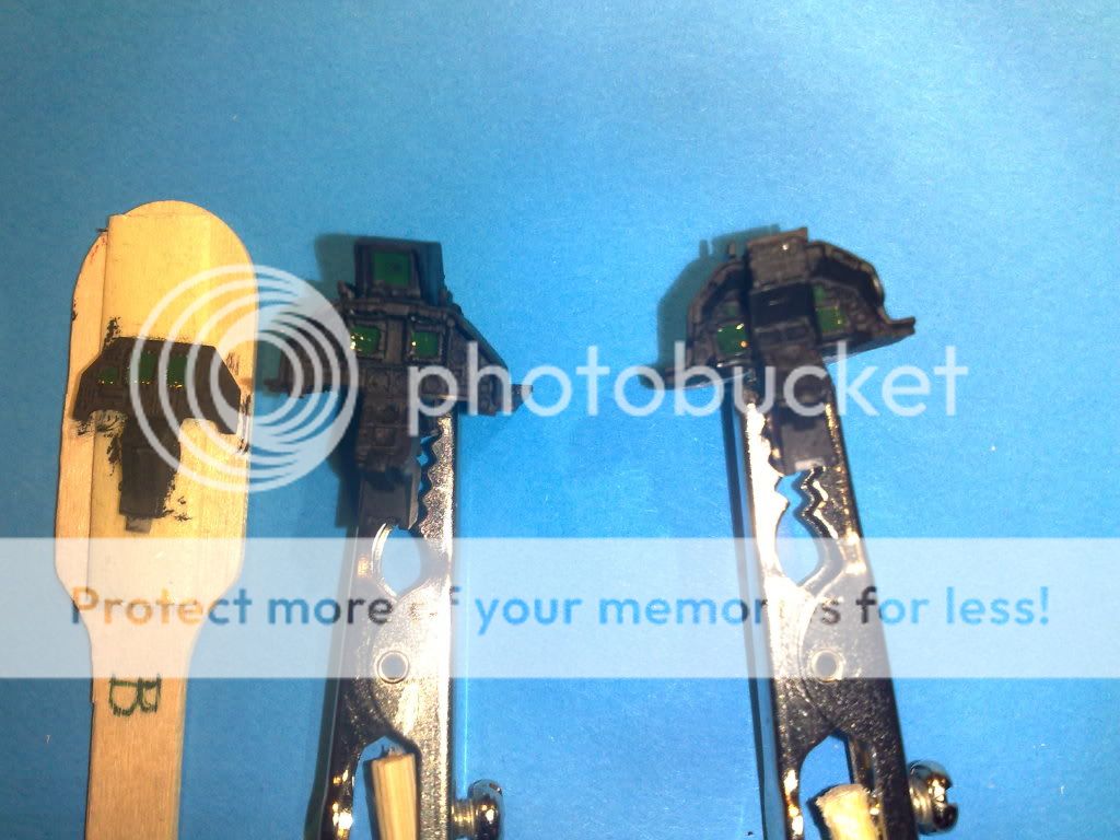

Now when that is done, I can concentrate on the cockpits.

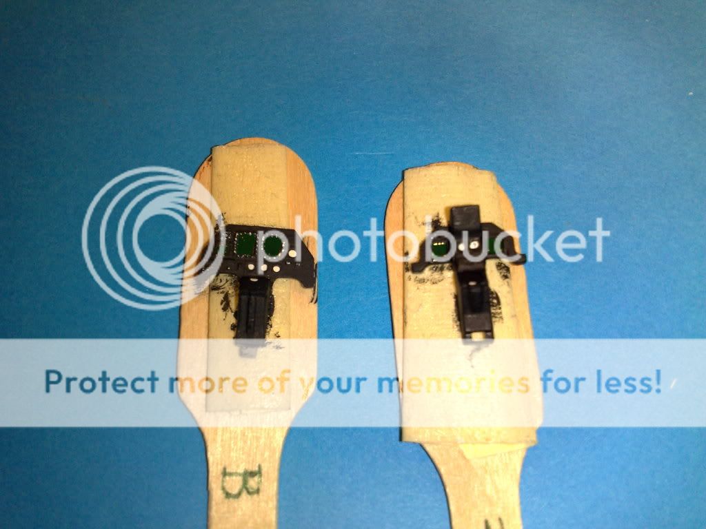

First a light drybrush of grey to get some more details out. Next I'll put some more colour to some nobs, just get it interesting.
I've also painted the cockpit screen dark green.
With this speed. I hope to be able to mount at least one cockpit tomorrow.

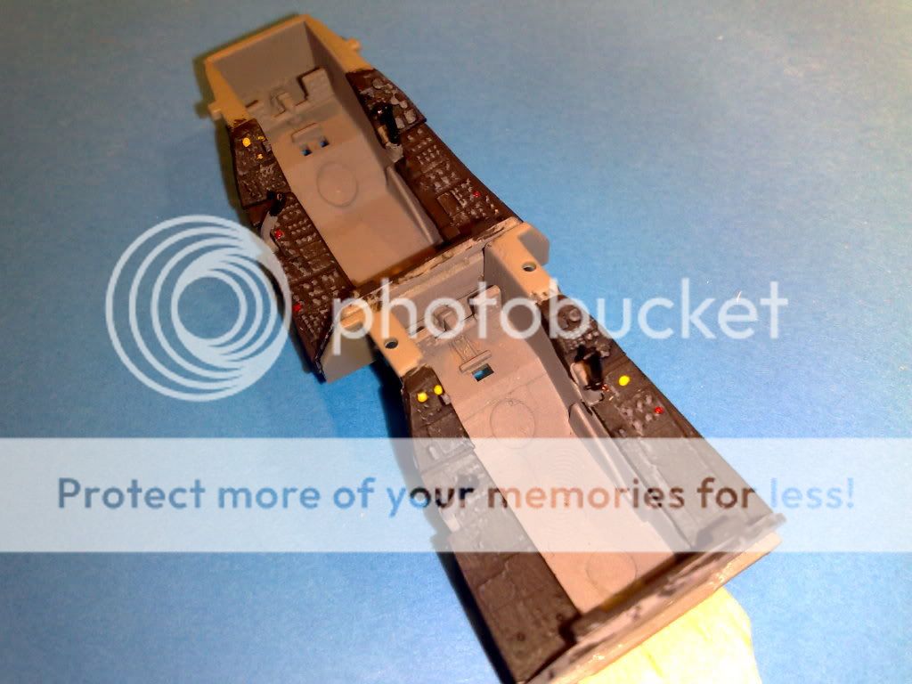

Hi Gang,
I'm done with the Sufa Cockpit.
I've painted the IP's and put all the little fiddly bit inside the cockpit.
Mounting the cockpit to the fuselage was no trouble.
I even started on the seats. And here is when trouble strikes.
The main part, sides and seat are to be glued togehter at was should be 45degree angles where the parts meet.
But no such luck. I've spent about an hour just too glue three parts together.
There are some ejectorpinmarks that has to be removed, and some flash also.
Memo to myself - Next Sufa buy some resin seats.

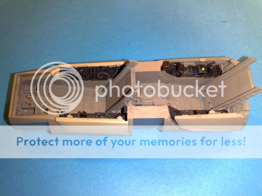

Hi, I've been busy today.
I've got the CFT's on and some more antennas.
I've also put some more work on the Aires cockpit for the first Barak D,
The side/wall consoles took me over two hours to get in place.
The wasn't exactly dropfit in shape. I've also put some more colour on the IP's.
But I see that I have to re-do the front seat one.
Since I'm not feeling fresh enough I'm staying home from work tomorrow as well.
Perhaps I can finish the cockpit then?

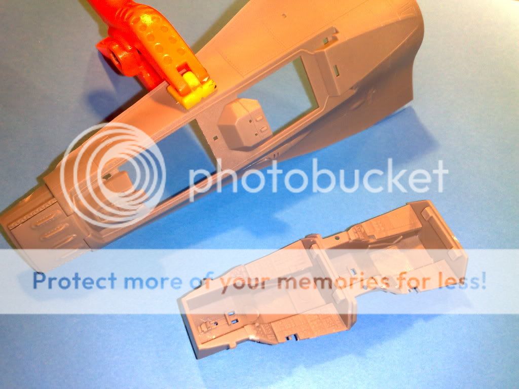

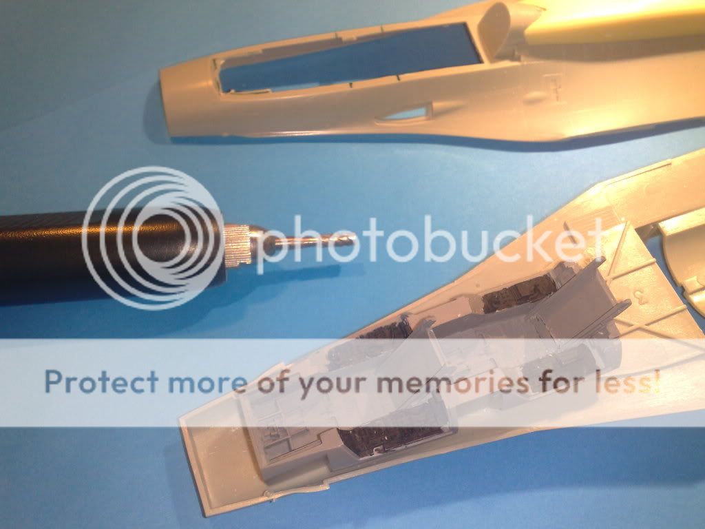

Hi again,

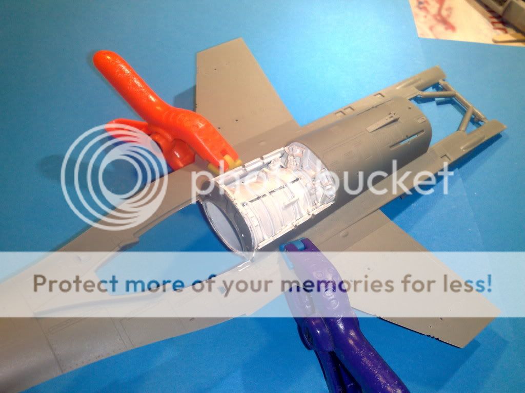

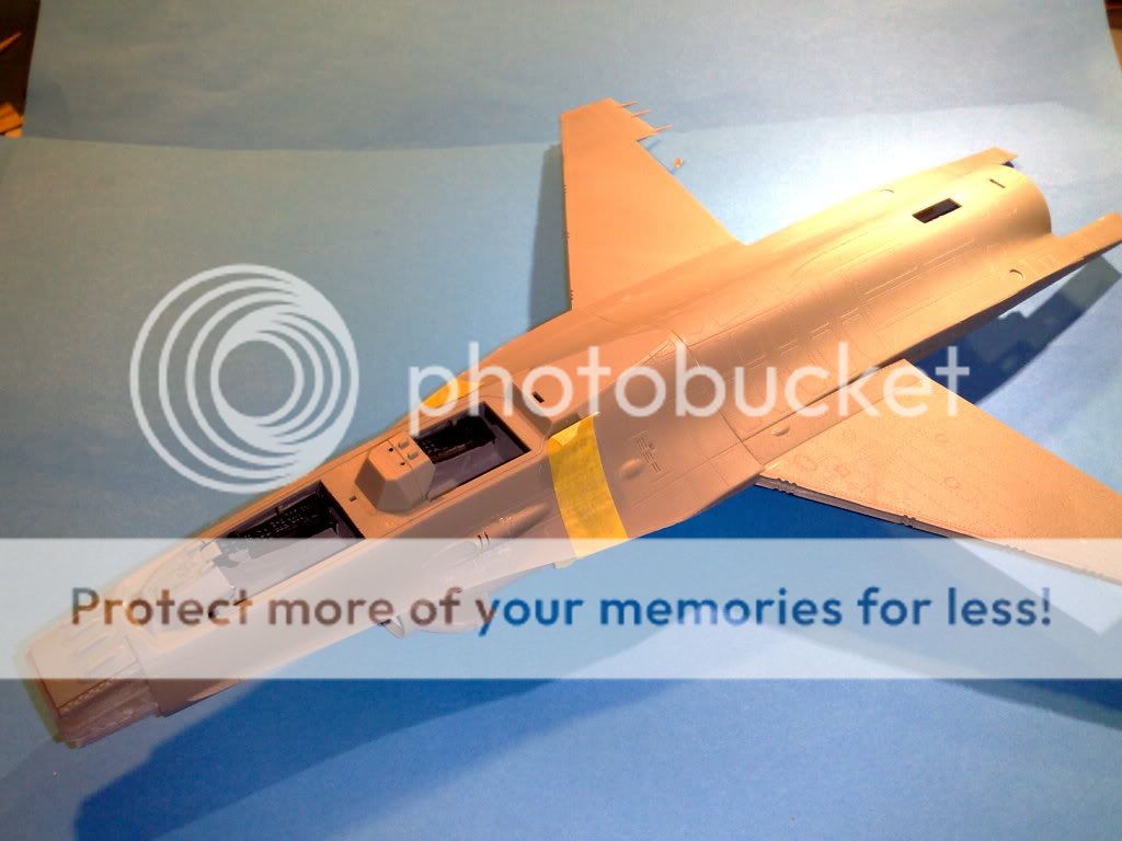

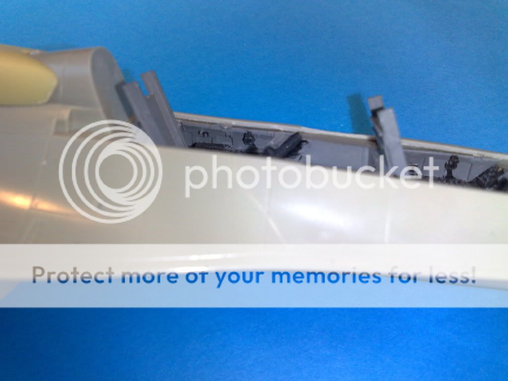

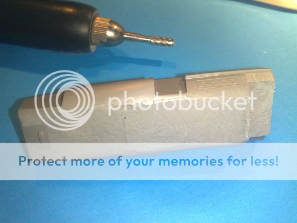

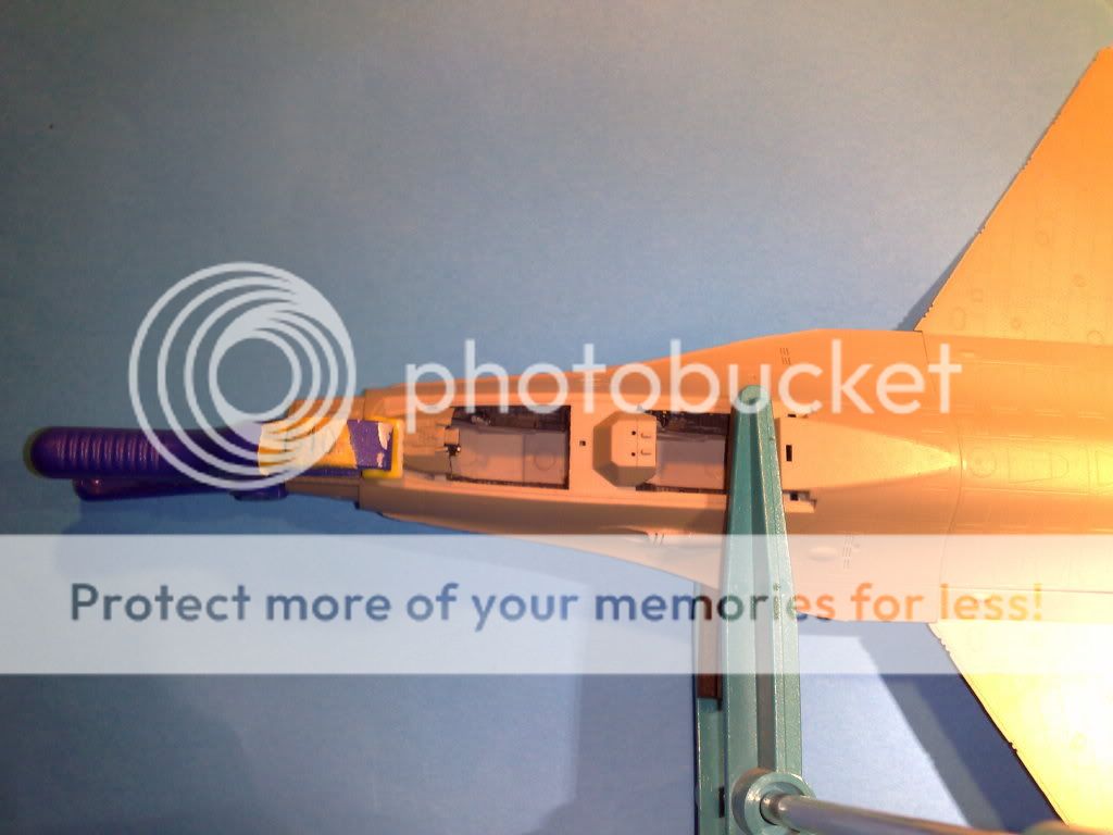

Yesterday I spent mostly trying to get the Aires cockpit to fit inside the fuselage.
I can tell you that it wasn't the easiest battle I've fought. It took me some hours of sanding and grinding before I could close the fuselage.
And another thing that strikes me as odd is the plastic of this Haswgawa kit. Its rockhard and very brittle, almost like resin.
Actually the fuselage cracked in two places as I was sanding.
The plastic is also in another colour than normal. The sprue containg fuselage and wings are of this harder almost resinlike plastic. But the sprues containing exhaust inlet cockpit etc is normal plastic. But it seems to take glue as normal so I guess I just have to bit a bit more careful so I don't break something more.
The crack I got in the fuselage was easy mended with some Tenax.

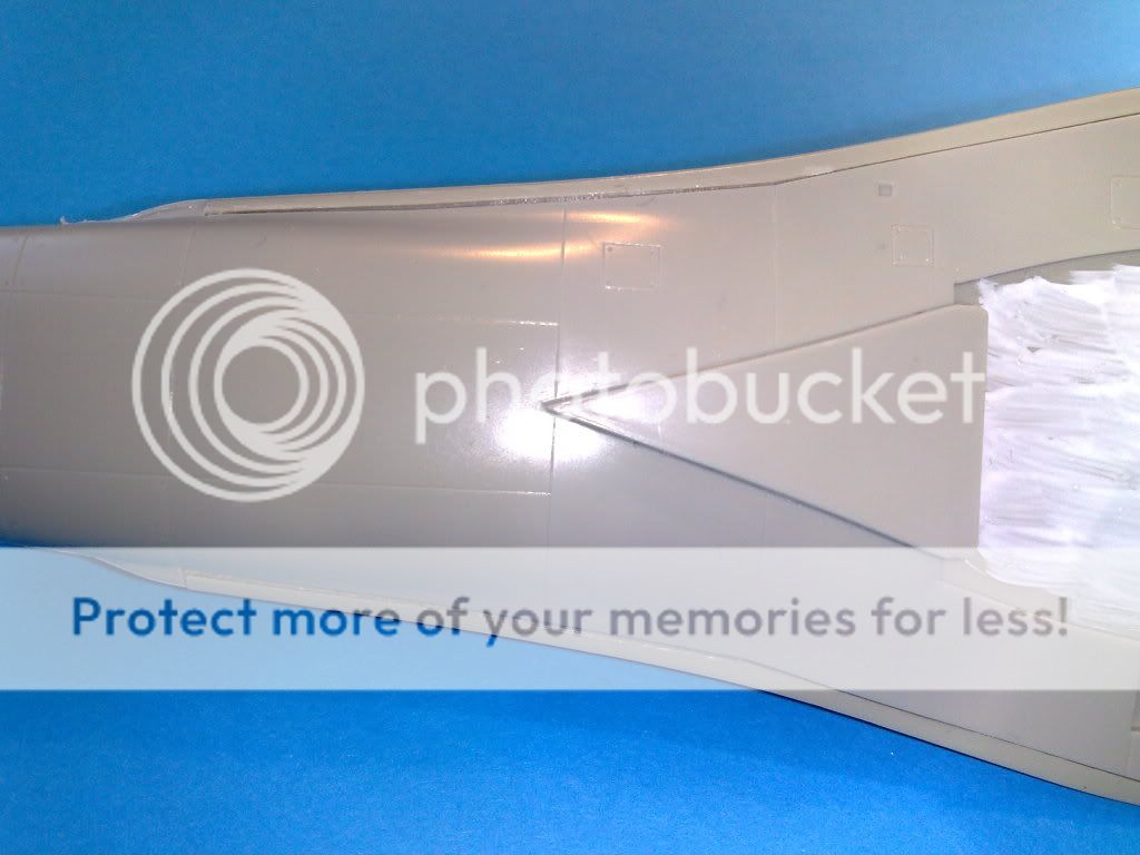

And I didn't get the fuselage to close fully on the underside so I have some gaps to fill. This is my third Haswgawa F-16 and I've had this problem on all of them.
Now I'm off to start the C-model. Tamiya-time so it should be fun..... :cheers:

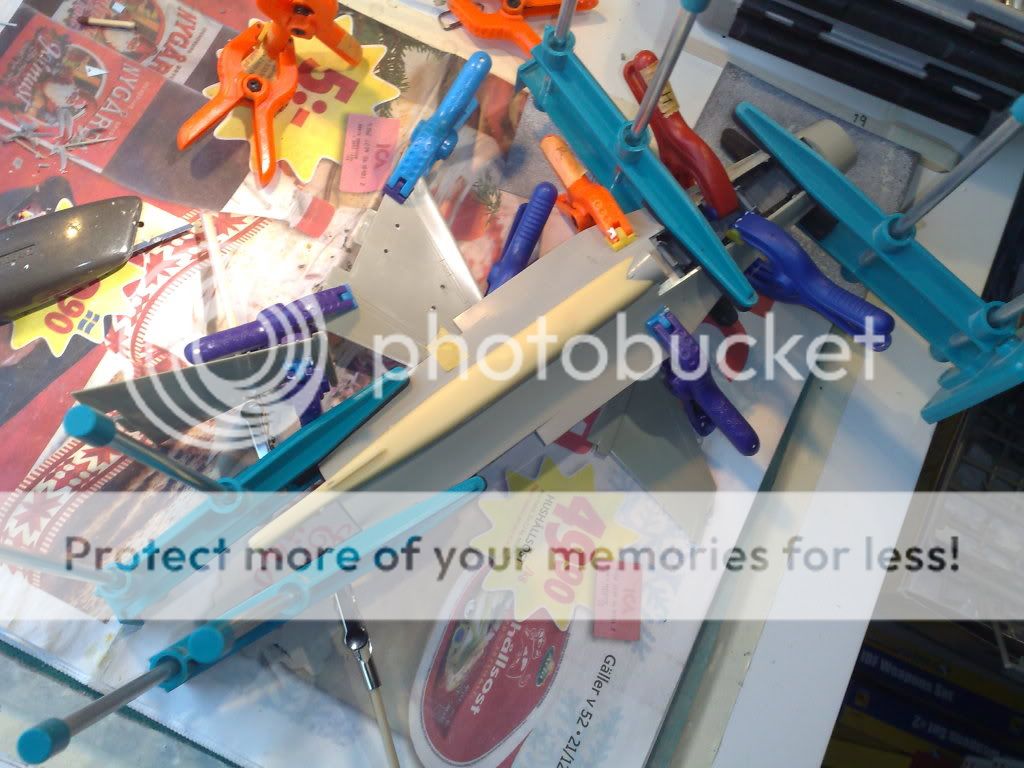

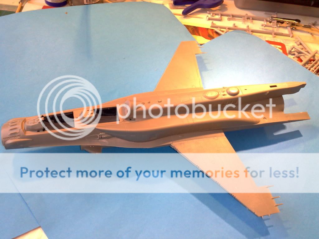

Hi, I didn't start the Tamiya C.
I continued on the Haswgawa D instead.
I would like to have the wings and fin mounted before I start the next one.
As for the wings. They dont fit!
I had to add some plasticard strips on the wings to get some fit.
Otherwise I will have a very nasty step to get rid of.

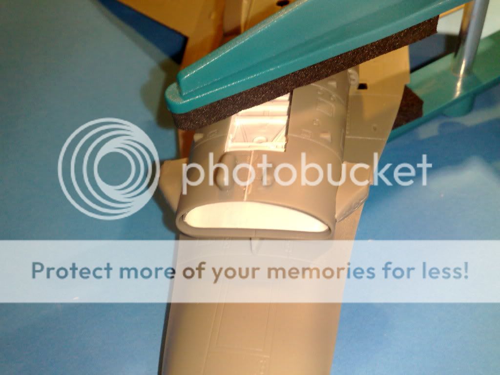

I've also fitted the Airwaves inlet to the fuselage.
That battle was almost like the Aires cockpit.
I had some gaps, but some strips of plasticard took care of that.
Perhaps I'll get the wings on by tomorrow.......

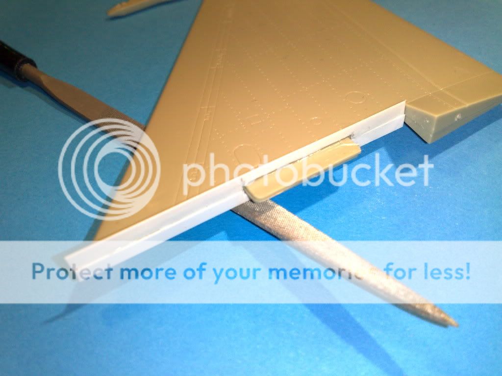

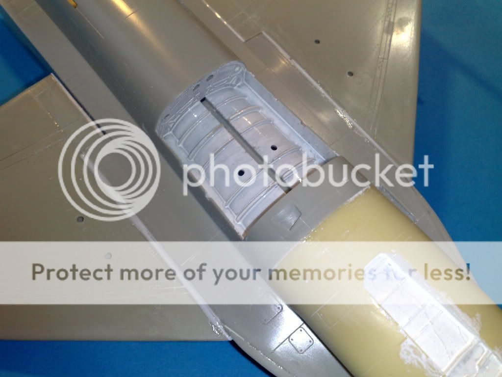

Hi again,
I think I've got the wings to fit now.
I've filled the gap with .10 and .05 strips until it was gone.
Last time I built a Haswgawa F-16 I filled the gaps with putty and I took fore ever to get an even fill.
Ã'm quite satisfied with this result.
