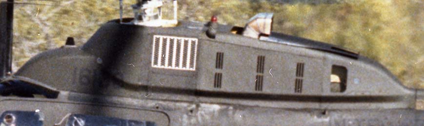

 Thanks for the colour tips. I messed around with the pic for a minute and came up with this version of it. Not fully correct but a bit closer to the real colour of the helicopter than the first version of this pic.

It sure would. I need to pull out my 1/72 Italeri kit and see how difficult that engine cowling modification might be. Nice paint scheme and the air data boom adds further interest to the model.

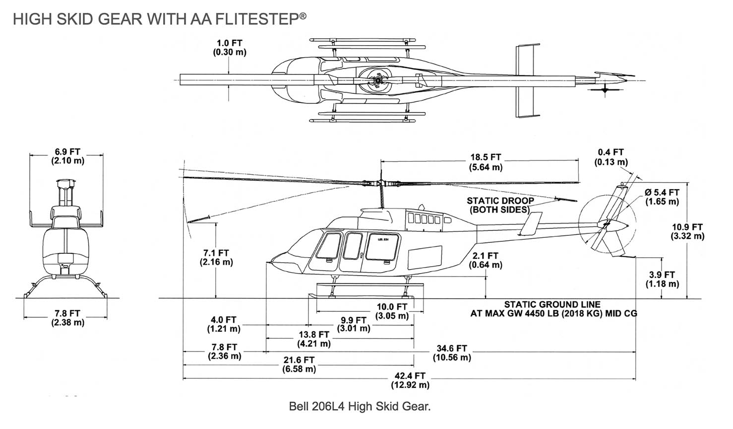

The engine cowl is essentially that of a 206L, similar to the 206L-4
This should give you the images you need to do it, along with a 3 view plan.  The rub comes in duplicating the "overhand".   I've been debating doing it in 1/35 using one of the kits MRC gave me when I helped with the OH-58D KW kit.  I don't think any of the AHIP birds were fitted with ATAS sets, that was wishful PR  marketing on BH's part.
https://ravenaircraftsales.com/aircraft/bell-206l4/
The drawing is right out of BH marketing on the 206L-4.  The only variance between the AHIP prototypes and the 206L, in engine cowl outline, is the exhaust stack.  the bird is set up for sling work, the bubble window on the pilots side allows the pilot to hang his head out to see the load for pickup and drop off.

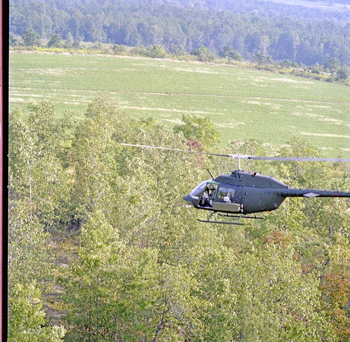

The AHIP birds didn't fly (to my knowledge) with ATAS systems.
The OH-58A's had ATAS units tested, but it never got out of the testing stage.  The first dedicated ATAS systems installed on OH-58's was the OH-58CS (S for Stinger) and the AH-58D Prime Chance birds.  The AH was later dropped as "Big Army" did NOT want the bird referred to as an Attack platform, and it was more politically palitable to refer to it as a "OH" bird.  Those launchers are represented in the MRC kit.  So your only options are to get the MRC 1/35 kit.  Or the OH-58A and convert it to an HO-58CS RG (Round Glass).  You would have to scratch the instrument panel, engine cowls, IR exhaust stacks, and oh by the way, the ATAS launcher...
A word on the somewhat available 1/48 kits, at a cost, none are completely correct.  All the 1/48 OH-58A kits have the Bell 206 rotor system.  They lack the swept tip caps.  You can get out the sand [paper and turn a 206A rotor blade into a 206A-1 rotor blade with a little bit of work.  The OH-58A was certified by the FAA as the 206A-1.
If you do an OH-58A and build an accurate OH-58A rotor blade (add about 4" to the blade and Scarfe it) , you will also have to add a few inched to the tail boom, as the OH-589A tail boom is slightly longer than the 206A/B tail boom.
The attached shot is the only ATAS launcher I can find (in the files Ray Wilhite has provided), with an ATAS launcher, admittedly a kludged together unit...
The shot of the AHIP is really a retouched shot of a mockup.  I can't find any evidence this aircraft in this configuration actually flew...  Again one of the shots Ray provided.
Another interesting image would be an OH-58A with 2.75" rockets.  The 6th ACCB tested the bird at Ft Irwin.  Unfortunately, I didn't have my camera with me when it showed up at "Bike" Lake.
Bryan

Thanks for all that info and the interesting photos. I had a dig through my OH-58A photos saved from the web and found this image of an OH-58A with a Stinger Pod fitted. The cameras fitted on top of it (as well as all the equipment in the rear compartment) indicate that it might actually have been a "live" pod and was used in testing the firing of the Stinger missile from the OH-58A. I reckon it is a second photo of the same OH-58A from your post above. It would be interesting to know the Army serial number for this Kiowa. It would make a nice and interesting little model.
(I'm not sure where I found this photo but it is possibly one of Ray's scans from the US Army Aviation Museum.👍)
AH-1G and OH-58 Oct 7 1981 CEP 52 AC 972 and 096 Stinger Project005
LD.

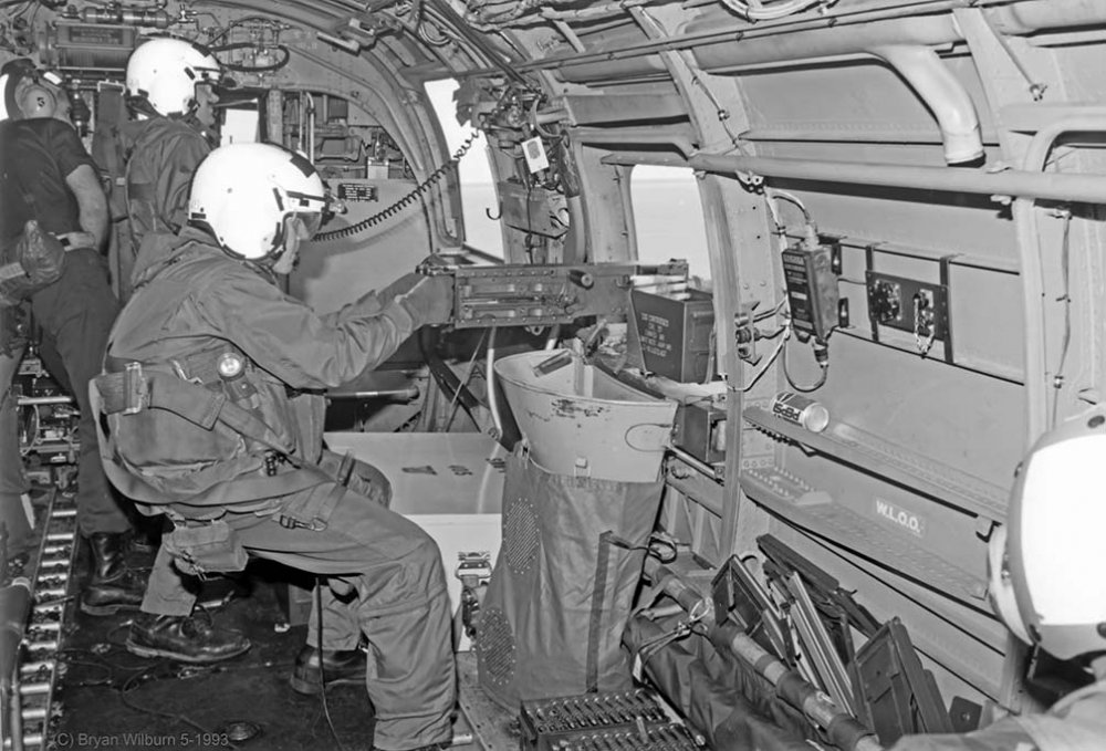

If you look closely you can see one of the .50 cases dropping into the collector.  The gunner instructor is standing behind the shooter.  They were nice enough to let be blow through a box of .50 Cal.  I was serving in a CH-47D unit out of Ft Meade at the time as a Reservist so getting on the bird was easier than a pure civilian.  Although I was there in the capacity as a "Journalist".  some of the shots from the trip on a tanker hop got published in World Airpower Journal.
The interior probably didn't change that much.  The Marines flew their birds without the sound proofing, the Army 47D's flew with it.

I may have the Ser No of the ship.  I'll check this afternoon when I get back from Denver.
Bryan

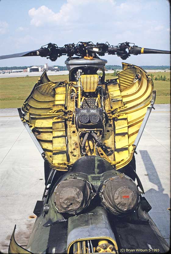

XSM area on a 46E.  the State Dept also flew a couple of bailed 46's from (I think) the USN.  Columbia also flew some in the Sand Box for support.

The S/N of this bird is 69-16096. It was Larter converted to an OH-58C, RG - Round Glass.  Written off (Read crashed) 3/31/92.
Bryan

That’s cool you got to put rounds down range. About 3 yrs after your photo, I had short ride on one in 29 Palms before playing tag in the desert, I think from 364, Purple Foxes. After we embarked, the bird dusted us. We did that twice. Felt like it took months to remove all sand embedded from the rotor wash. I remember that not only from the flight (felt like we punched our way through the air) and rotor wash but we were also given practice grenades that day. The day before when a practice grenade was thrown my direction on patrol by a Sgt, I didn’t know we had them. 😱😱A grenade spoon makes a distinctive sound. I needed a minute afterwards.

Every time we crossed the border into Iraq we would drop down to 50' and test the guns.  My ruck lived under the left waist gun.  Needless to say the gun gas and various particles rained down on it.
When I got back to the states in late 2003 I would use the ruck to travel.  Then they swabbed it for explosives and security went berserk, it tested positive for explosives.   Security showed up and they were really nervous, and really didn't appreciate the smile on my face as they unloaded the ruck and laid everything out and poked an prodded.  They finally confronted me and I sort of chuckled, that really set them off, and I explained how the ruck got covered in explosive residue.  While they didn't like the story they had no choice but to let me board the plane.

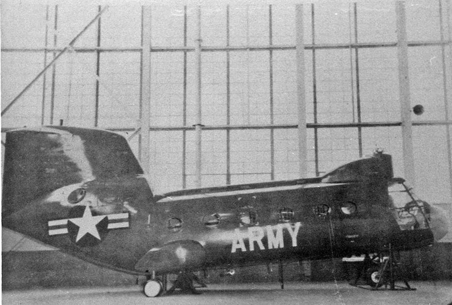

There were two different versions of the YHC-1A tested by the Army.  The first was a 1700 SHP bird, the second with bigger engines was powered by 2440 SHP, Boeing records indicate it was a "Converted YHC-1A".  I'm going to assume (not always the best) that the original bird(s) got bigger engines.  I have shots of two different birds, 85514 & 85515. There was at least one mockup of the HC-1 at Boeing, painted OD, and ARMY on the side of it.   As shown above in an eralyer post was a bird with a CH-47A, 85516
The shot on the WEB site of 85515 with "WELCOM TO" on the side of it was taken at Ft Benning related to Project "Man" held at Benning 1 - 4 May 1960.  A label on the back of that shot indicate the weight was 28,400 lb, cruises at e130 kts, max 150 kts, taken on 3 May 1960.
The bird that ended up at NASA Langley was NASA 533.  It also looks like the Army birds lacked an APU that can be found on the later USN & USMC birds, its the small bump out on the vertical housing.  The Canadian AF CH-113 Labrador birds initially did not have an APU, the Canadian Army CH-113A Voyager birds did.  The Army birds also lacked the larger sponson fuel tanks.  The giveaway as to which it was, is the Voyager's had 4 additional nose windows above the chin bubbles.  This was so the Army pilots could better see the landing areas on ships.  After Unification the AF birds got APU and they all got painted the same color.  but they kept the nose windows.
Bryan
Thanks for that info.
LD.
