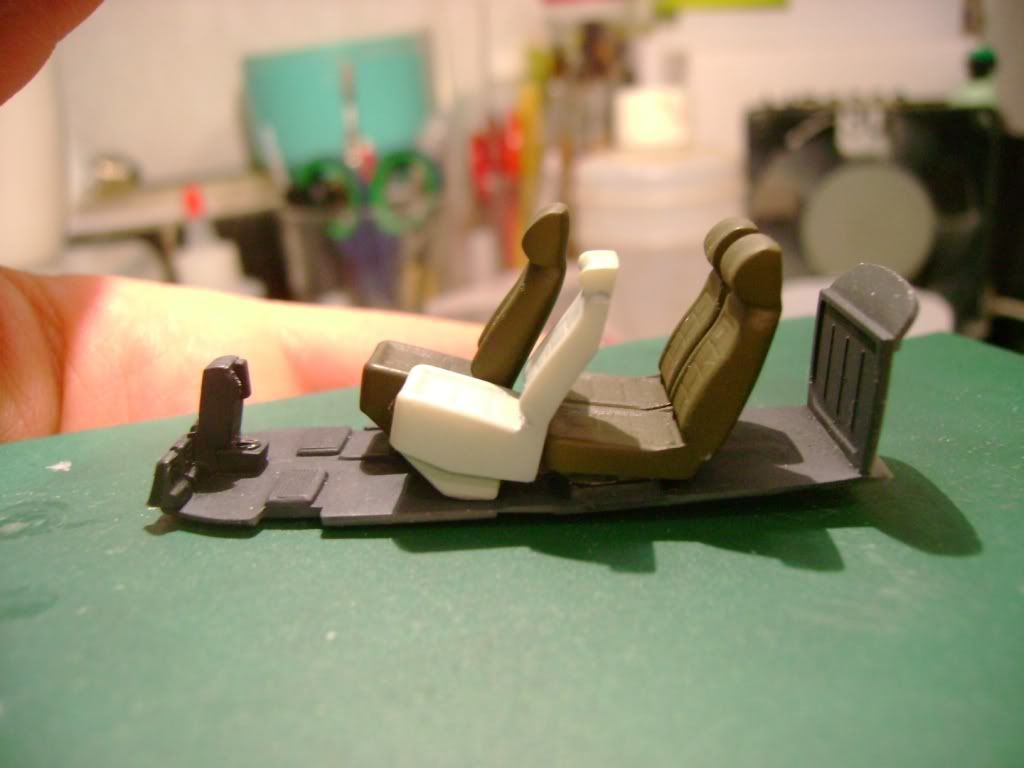

EL REY Posted March 4, 2010 Share Posted March 4, 2010 (edited) Hi, friends!, this time I show you a proyect in scale 1/50, a chinesse kit, Minicraft Cessna 172. But I want to arrive to this: A mexican air force plane (light observation airplane), Cessna 182 skylane, well, let's go! A firts step is to modify the floor and seats. Look at the change on the seats, color and headrest, were modified. After is necessary to modify the rear window too. On the skylane is so: Using the front window of the 1/72 uh-1n from Aeroplast, I get the correct one. Sanding and polishing, I finish it. Edited March 9, 2010 by EL REY Quote Link to post Share on other sites

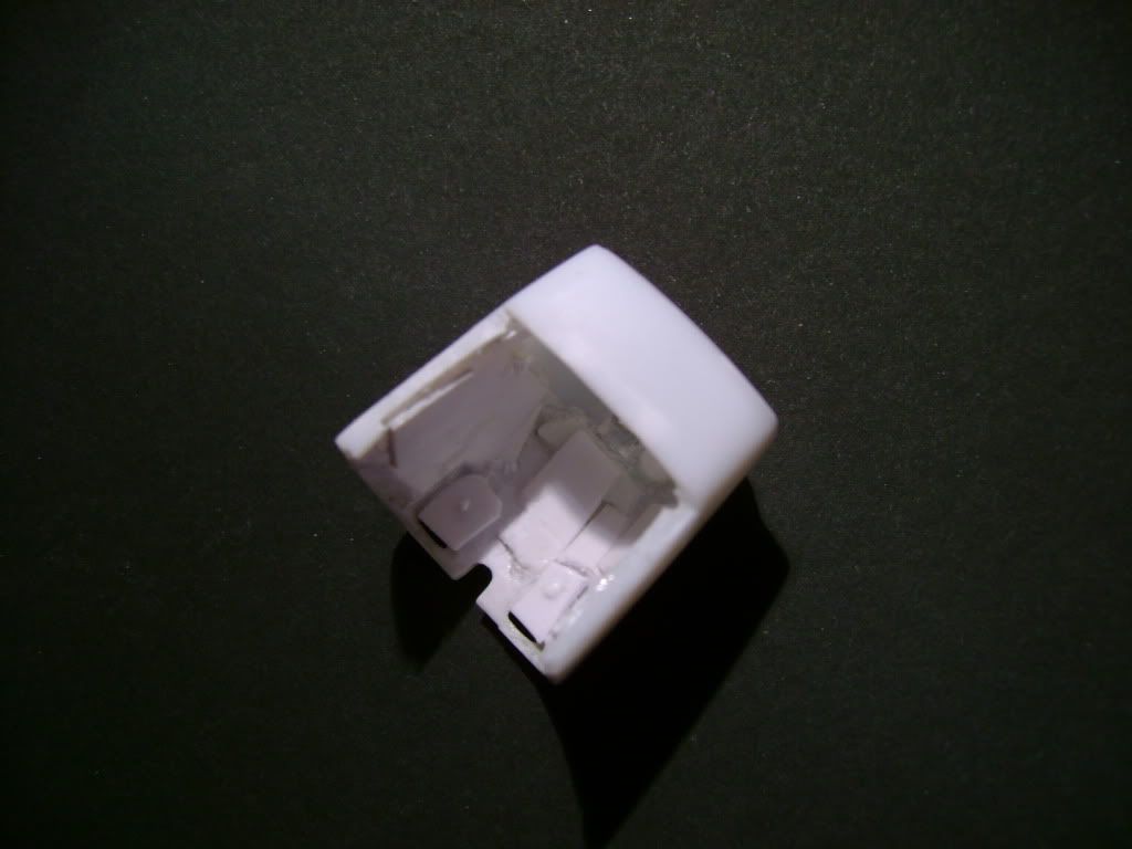

EL REY Posted March 4, 2010 Author Share Posted March 4, 2010 A very interesting point to need so much work, is the cowling, on the kit is so: The conversion: With a great imagination, superglue and much styrene. Quote Link to post Share on other sites

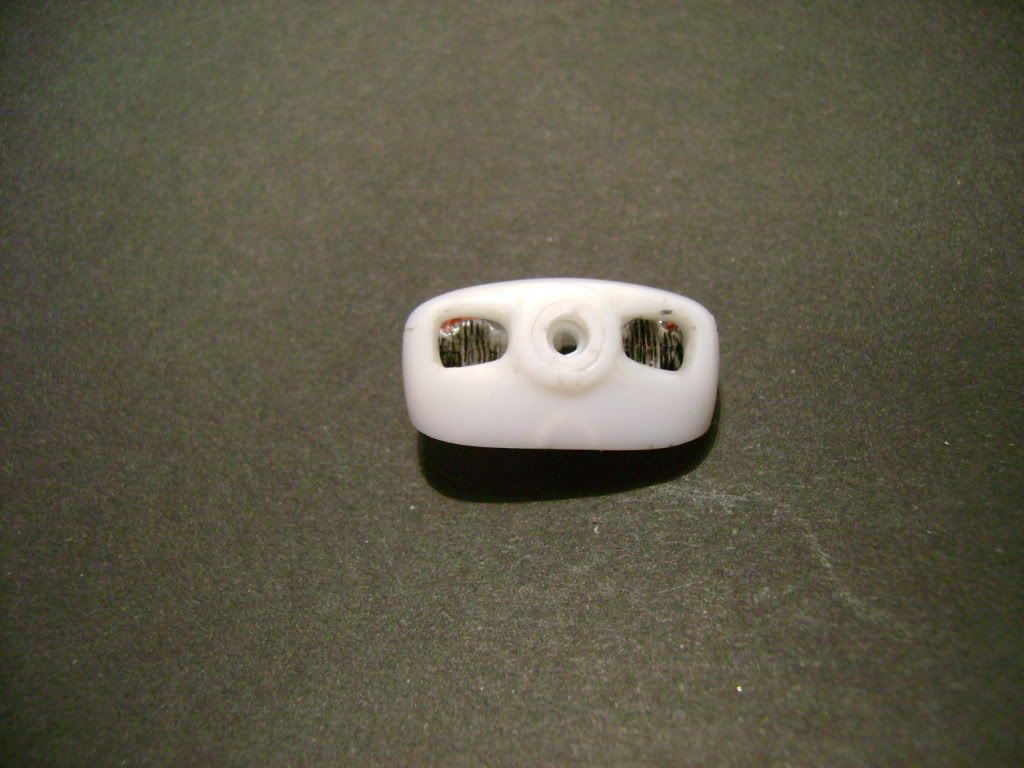

EL REY Posted March 4, 2010 Author Share Posted March 4, 2010 Well, let's continue. Once join the fuselage, I prepare the lights on the wings, I drilled a clear sprue, I sand and polish And make a cavity for the lights, these are from Greif. My friend super glue finished the detailed. Look at into the cowling, I have had that increase weigth in great quantity. Really this kit is a sh*/#. Quote Link to post Share on other sites
