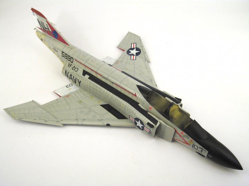

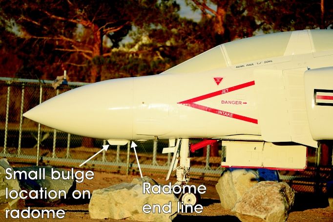

f4h1phantom Posted August 12, 2013 Share Posted August 12, 2013 (edited) Hi everyone! Today I masked and painted the black parts on the airframe. Nose cone, anti-glare panel, etc. Check out the photos. Hi Zoli, I love all the work you have done. I feel however I should point out that you have made a little mistake misplacing the part that goes under the nose. It should be placed under the radome, not in front of the landing gear well on the underside of the airframe. Check the picture below to see what I mean. I think the mistake is easily corrected and it is my hope you won't take offense by my mentioning it. My only intention is to help you notice it before the model is finished so it can be as accurate as possible, as that seems to be your goal. Apologies beforehand is my post causes you any irritation. And by the way, I am in the process of trying to finish one of those kits myself! It is the original Esci kit which I started about the time it was released (was that in the early eighties?) as an OOB quick build that was meant to be sold at a local hobby store. I have rescued it from the box of doom and am planning to get if finished as an F-4D for my collection now. It will be nowhere as detailed as yours, but I will be happy if it just looks nice when done. I teared out the original cockpit and will replace it with a Monogram one. That'll do for me! Here's a cople of pics of it as it stands now: Your build will serve as inspiration no doubt! All the best, Jorge. Edited August 12, 2013 by f4h1phantom Quote Link to post Share on other sites

f4h1phantom Posted August 13, 2013 Share Posted August 13, 2013 (edited) Hi Jorge!I will leave it as it is now, Cheers, Zoli Hi Zoli, I perfectly understand your decision as it is probably the wisest thing to do! No expert here, just another Phantom Phan! :lol: Looking forward to your next update. Keep up the good work mate! Yours truly, Jorge. Edited August 13, 2013 by f4h1phantom Quote Link to post Share on other sites

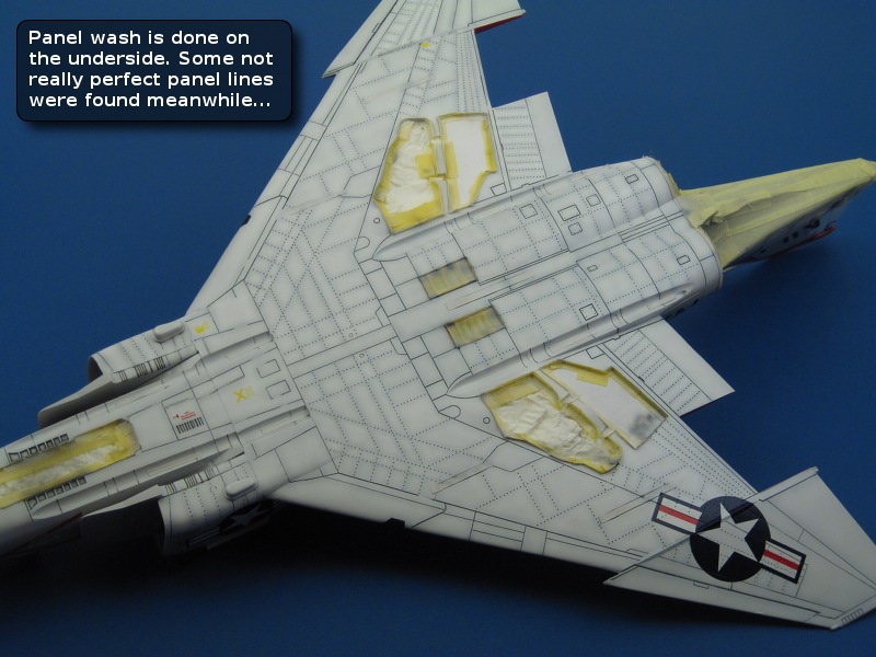

ZAgocs Posted October 20, 2013 Author Share Posted October 20, 2013 Hi everyone! This is time for another progress report on this Phantom. Slowly I am getting closer and closer to the end. Hi Zoli, I perfectly understand your decision as it is probably the wisest thing to do! No expert here, just another Phantom Phan! :lol: Looking forward to your next update. Keep up the good work mate! Thanks, Jorge! What an amazing build! Great work, sir! Thank you, JackMan! This is a lovely build, Zoli. Great work. I love the paint job - very well executed. I look forward to seeing the end result. Thank you, Ian! I hope nothing serious will happen until I put this into the display case... BTW, during the decaling process the model was dropped... Thanx Zoli for a masterful job of teaching old dogs new trix, by that I mean your class on pre-shading and painting has given many, with me at the top of that list a new hope for still better builds with the inspiration you have given and so eloquently illustrated; the finale is something I will await with anxious patience. Thanks for the kind words Clif! I hope you will like the final result! Progress: I finished putting on the decals. I was lucky with the very first insignia on the underside, but somehow all the other decals resisted my every attempts to force them into the rivets and panel lines. Gunze Mark Softer was used and it softened the extremely thick decals well - but when a decal is completely dried, it came out of the rivets and lines again and covered the details. As a final solution I had to cut them along the panel lines and "re-rivet" the areas covered by the decal. It was a painfully slow process... :( On top of that - I am not a Phantom expert but comparing the instruction sheet and real life photos with the decals it seems to me that the stencils are more 1/32 scale than 1/48. I took a photo of the nose part - please check it yourself and add a comment... Anyway I put them on as I want to finally finish this bird after three years... As I wrote earlier, the model was accidentally dropped during the decaling process, but only the middle part of the canopy had broken off. It is held by the masking tape now, but I have to remove the masks, glue the part back before clear coating. Photos: Cheers, Zoli Quote Link to post Share on other sites

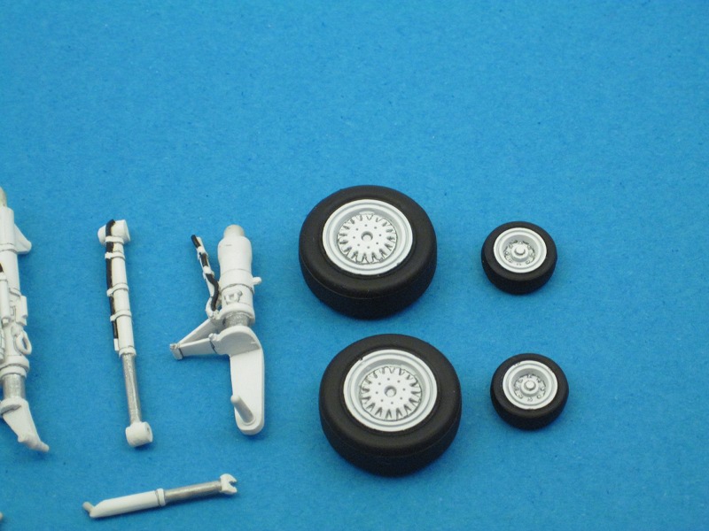

ZAgocs Posted October 22, 2013 Author Share Posted October 22, 2013 (edited) Hi! Some more little progress was made... So nice! Thanks, sharkey! Hűűű bakker, ez nagyon kemény... Zoli, that is the most beautiful Navy Phantom I've ever seen. Knowing the basic kit from Italeri the level of execution you've made is Phantastic. It's time to sit together to make a happy modeling day. I have a lot to learn. Regards,Laz Hi Laz, thanks a lot! But I have to say I have seen many Phantom models much better than this one - anyway, this one is the ESCI/Italeri offer at all. On the other hand, it will be the best Phantom in my display case... ;) Modeling together: be my guest - distance is only 150km, this is almost nothing for you... So, onto today's progress pictures - landing gears and some cosmetic issues are done. Thanks for looking. Cheers, Zoli Edited October 22, 2013 by ZAgocs Quote Link to post Share on other sites
DanW Posted October 23, 2013 Share Posted October 23, 2013 I think you have been using the Tamiya mat white for the under site. Is the Gunze Mark Softer so great that you could place the decals on the mat surface? Thanks, Dan Quote Link to post Share on other sites
ZAgocs Posted October 23, 2013 Author Share Posted October 23, 2013 I think you have been using the Tamiya mat white for the under site. Is the Gunze Mark Softer so great that you could place the decals on the mat surface? Thanks, Dan Hi Dan, yes, I used Tamiya Flat White but the surface received a layer of Tamiya Clear before the decals were applied (as you probably noticed on the images clear coating is one of my weakest skills). Decals were applied onto this clear coated surface using Gunze Mark Softer. And yes, it is a great product, I have used it many times without problem - this time the problem was the thick decal film. Cheers, Zoli Quote Link to post Share on other sites
DanW Posted October 23, 2013 Share Posted October 23, 2013 Hi Dan, yes, I used Tamiya Flat White but the surface received a layer of Tamiya Clear before the decals were applied (as you probably noticed on the images clear coating is one of my weakest skills). Decals were applied onto this clear coated surface using Gunze Mark Softer. And yes, it is a great product, I have used it many times without problem - this time the problem was the thick decal film. Cheers, Zoli Thanks Zoli. I need to try it then. I usually use the Micro Set/Sol stuff and wonder which product is better. Quote Link to post Share on other sites
