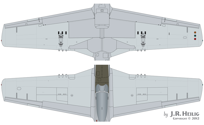

sabre45 Posted February 5, 2017 Share Posted February 5, 2017 Hoi All, Â This is the place to be. I have a lot of P/F-51D Mustang in the stash. Saw the wing drawing from Mr. Heilig (Very useful and nice). But some colors. Cockpit: standard interior green for WW.2 But to build a Korea War F-51D is it still green or black? I painted a F-51D with a black cockpit. I remember a P-51D in the AF Museum in The Netherlands with a black cockpit. ex-AURI. Â Still looking for a nice method to fill in the panel lines. I try thinned white glue, but it was a total disaster. Will try now some automotive putty. Some in put please? Â Han Quote Link to post Share on other sites

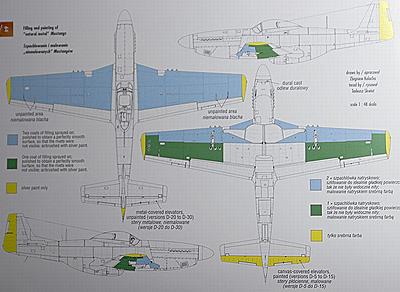

tourist Posted July 11, 2019 Share Posted July 11, 2019 Here's an update that may help understand the way NAA finished Mustang wings. It was put together by John Terrell. One could reproduce the exact same thing on their models for more accuracy. Let's just keep in mind the obvious fact that a real wing and a model kit wing are very different starting points. Â Quote Link to post Share on other sites
One-Oh-Four Posted August 16, 2019 Share Posted August 16, 2019 On 5/10/2014 at 7:57 PM, tourist said: The subject of Mustang wings seems to confuse many modelers and endless speculation hasn't helped. It is in fact fairly simple, the wings themselves weren't covered with putty, some putty was applied in the appropriate panel lines, then primer (two layers towards the LE) and finally paint. This didn't crack, or fall off or disappear when rubbing off invasion stripes etc... For this reason it didn't need to be reapplied all the time and your uncle or others don't remember it. As surprising as it may sound NAA knew what they were doing and they didn't spread buckets of cracking putty on Mustang wings! On the beautiful Tamiya kit however, because of the visible "rivets" one will need to apply a lot of putty in order to accurately reproduce a smooth WWII P-51 wing. Here's what you want: Â Guys, Â What I've been wondering about; early P-51D's received camouflage paint on top of their wings (on their operational air bases) in the summer of 1944. This was removed after some time. Wouldn't the removal process also damage the alumini(u)m paint? If so, was the wing repainted in alumin(i)um or just completely stripped of paint, primer and -possibly- putty? Â Cheers, Erik. Quote Link to post Share on other sites
