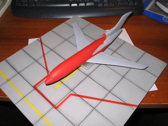

pttaa Posted January 17, 2011 Share Posted January 17, 2011 (edited) Fischer, GO FOR! I did some year ago on AIRFIX -200 and add some extras drom AUTHENTIC AIRLINES (NOSE, INTAKE #2, ENGINES ...) and was one of my best best experience, you have to try and test your skills! OOB is for KIDS, real modelers play with plastic! :D Edited January 17, 2011 by pttaa Quote Link to post Share on other sites

pttaa Posted January 19, 2011 Share Posted January 19, 2011 What Jennings said. It is much more than just a fuselage stretch. Just like a Hornet to Super Hornet is much more than just new intakes. You pretty much need a whole new #2 intake (it is not just ovalised, it's also shorter and tilted), and new wing-body fairings. David I used on my the intake from AUTHENTIC AIRLINES and you cant get better then that, is just perfect!!! About the wing body fairings i use the reference from the BOEING reference guide for the 727 and was easy. Fischer, If you want to build a -100 (love this plane) without converter my advise is go to the Kurt 727, is a jewel, and for the prices the old "AIRGHFIX" and REVELL go on ebay now, is better invest a little more and get a REAL 727!!! My 2 cents only! Quote Link to post Share on other sites
