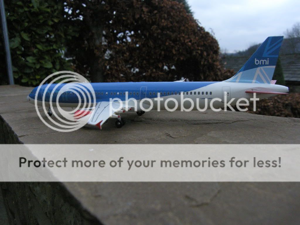

RICH W Posted January 20, 2011 Share Posted January 20, 2011 hi i have done the A319/320/321 in the bmi livery for masking i would recomend the the really thin about 2mm width masking tape that you can bend arround corners i got the best result using that . similar to this on ebay http://cgi.ebay.co.uk/Masking-Tape-Micro-4...=item53e56b6bbf As for the Blue take no notice of the Revell colour guide i got the best match by mixing Revell 52 with a little bit of white paint the model all white first then mask off the blue heres a picture of the finished A321 model i did using 2 sets of Revell decals hope this helps Richard Quote Link to post Share on other sites
piescoffer Posted January 21, 2011 Author Share Posted January 21, 2011 (edited) That looks great! - I hope mine turns out that good. How did you paint the blue - did you brush or spray? Also - did you fill the window holes in before painting? Thanks for the advice by the way Edited January 21, 2011 by piescoffer Quote Link to post Share on other sites
RICH W Posted January 21, 2011 Share Posted January 21, 2011 That looks great! - I hope mine turns out that good. How did you paint the blue - did you brush or spray? Also - did you fill the window holes in before painting?Thanks for the advice by the way yes i always fill the windows its better then you get the correct window configuration using the window decals , i sprayed it using my Airbrush , you will get a lot better finish Airbrushing than brushing it on Richard Quote Link to post Share on other sites

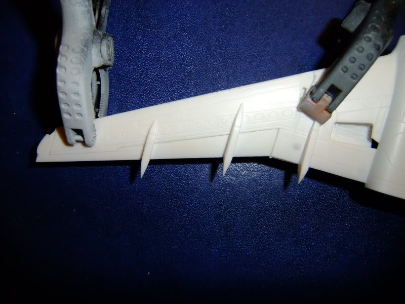

piescoffer Posted January 22, 2011 Author Share Posted January 22, 2011 Is there a way to strip the paint off plastic models? I wasn't sure if this was possible. Also, I glued the top and bottom wing sections together but there seems to be a thin gap on the rear at either side where the flaps are - I'm not sure if this should be there because there are small raised pieces of plastic inside the wing itself that hold it there, but wasnt sure if should have ground them off prior to glueing - any ideas? If not I will have to fill them. Quote Link to post Share on other sites
Wild Weasel V Posted January 23, 2011 Share Posted January 23, 2011 Hi there! I'm not quite sure what you mean by raised pieces inside the wing - are you referring to the locating pins on the lower wing section? The two wing halves should fit together snugly with no gaps at the flaps. The assembly should look something like this: Or do you mean at the trailing edge of the inboard flap where the upper and lower halves meet? If you have a gap here then it should be filled as the inboard flap is one piece. Also, to correctly represent the A319 wing configuration (as above) you need to make sure you remove the small flap fairings and fill the lines for the double slotted flaps. These are only seen on the A321 so need to be deleted for the rest of the family: On to the painting, the blue can be matched by using the provided decal on the kit's sheet. It's the big triangle near to the RH fin logo. The colours on the sheet are a dead on match for the actual livery (I have paint swatches) so can be safely used for mixing your own. The Ensign red on the cowlings and horizontal stabiliser is identical to Xtracolor X014 Red Arrows red. To strip paint you can use various chemicals; the most popular is oven cleaner but various others are used: brake fluid, other cleaners or something like Modelstrip http://www.hannants.co.uk/product/MODSTR01 . If you have a look round the Tools & Tips forum there's plenty of options listed. I hope this helps. If you have any other questions on the kit just ask away! Jonathan Quote Link to post Share on other sites

piescoffer Posted January 23, 2011 Author Share Posted January 23, 2011 I had no idea that building a model from a box would be so complicated - I noticed in the instructions that it said to remove the small flap fairings and couldn't understand they would put them there and then instruct to remove them. I guess they need cutting off with a knife - not sure how neat I will be able to make them look. On the note of filler I was going to purchase a tube of the humbrol model filler - is that any good or should I go for something different? Thanks for the advice so far - think I will need to purchase some more stuff before I continue - need a weight for the counterbalance, a new modeling knife, filler, an airbrush - not sure if to go for a small one that attaches to a can of propellent of if to invest in an electric compressor - any advice on this? Cheers Quote Link to post Share on other sites
Ben Brown Posted January 23, 2011 Share Posted January 23, 2011 Revell uses the wings for their other 'Bus kits, and the A321 has the extra flap fairing. Not too hard to remove. You can cut them off, then use a sanding stick to smooth everything out. I bought a pair of cutters from the hardware store for about 5 bucks and they are great for removing parts from the sprues or cutting things like flap fairings off of models. Here is the expensive one from Micro Mark. Mine looks just like that for less than half the price: http://www.micromark.com/PROFESSIONAL-SPRUE-CUTTER,9277.html Not sure about the Humbrol filler. You'll get about 500 different opinions on the best filler. Squadron's shrinks as it dries, so you may need multiple applications. I wouldn't be surprised if Humbrol's does, too. Some people like 3M's glazing putty for cars because it doesn't shrink as badly. Any of these should be used in a well-ventilated room. You should apply thin layers, because the solvents will attack the plastic and soften it. A two-part epoxy putty can work well, too. It's just more labor-intensive to use. For tiny cracks or scratches, I use liquid typewriter correction fluid. Dries fast and sands easily. I'd avoid the cans of propellant. They get cold as you use them, which very quickly lowers the line pressure. You'll get a lot of opinions on compressors, too. I use a noisy 2-gal hardware store bargain because I'm a cheapskate. Helpful hint for white airliner models: if you can find some, prime with Tamiya's white primer from the rattle can. It covers well, dries fast, and you can mask over it and go on with your next color. It saves you the step of priming, then going back with multiple coats of gloss white. HTH. Ben Quote Link to post Share on other sites
