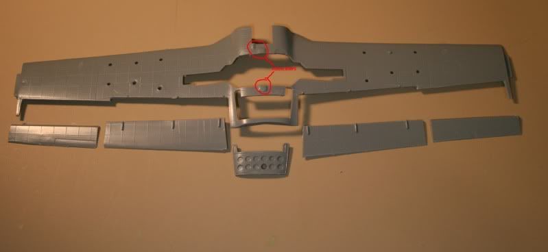

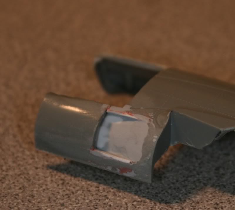

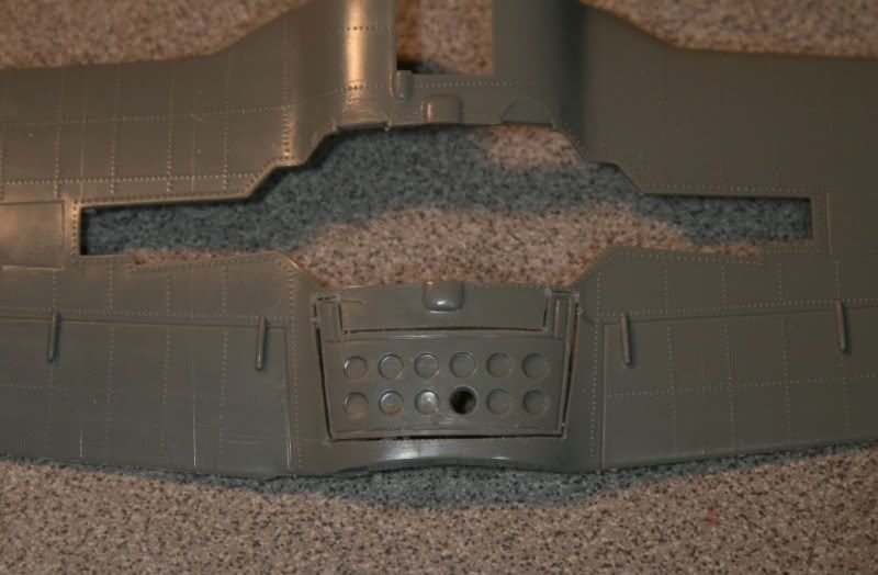

drhornii Posted February 5, 2011 Share Posted February 5, 2011 (edited) Old kit with BB cockpit, Lone Star wheel bays, side cowlings, wheels, Quick boost engine and Squadron Vac canopy. Test fit of side cowlings First step in cleaning up oil cooler vent second step in cleaning up oil cooler vent Carefully cutting speed brake section, will make housing later Wing sections cut, note bumps (circled red) for operating gear doors need to be removed, fill back sides of bump then file outside flush. Edited February 5, 2011 by drhornii Quote Link to post Share on other sites

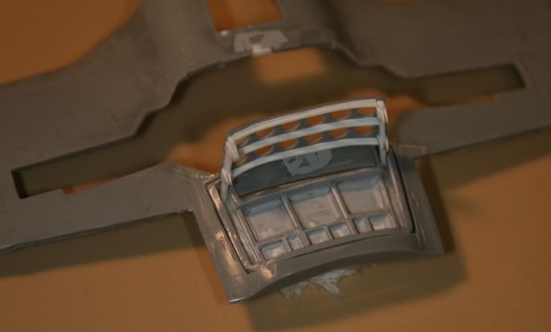

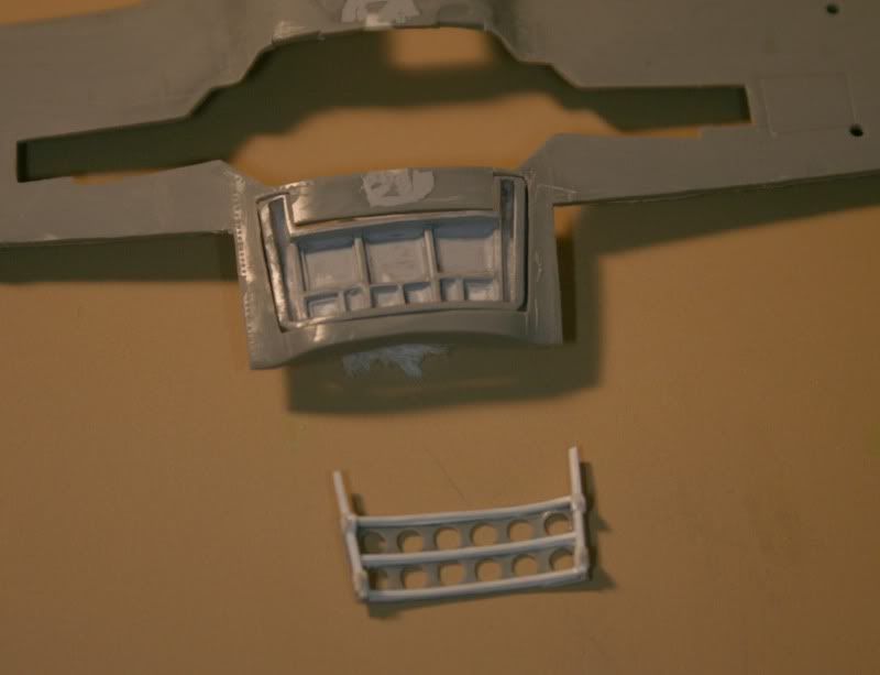

drhornii Posted February 12, 2011 Author Share Posted February 12, 2011 (edited) Fuselage update set all fared in, had to fill some pin holes and incorrect cowl door actuator hole. Also, all the raised rivets were removed and the groove (to indicate the black area to hide oil stains) is not there on the real AC so it was filled with fine plastic rod & sanded smooth. Since this photo was taken, the exhaust piped were removed since the resin parts were chipped. Wil add plastic tubes for exhaust later. Next I decided to pose the speed brake open so I am building the master and will cast these details soon. Still need to clean it up a little and add the hydraulic actuators. The hole for the SB housing is intentionally over sized and will be fared into the belly of the wing. Edited February 12, 2011 by drhornii Quote Link to post Share on other sites

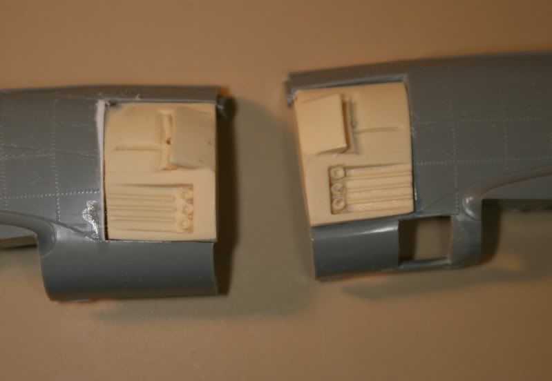

drhornii Posted February 19, 2011 Author Share Posted February 19, 2011 First castings, I got a little heavy with the primer on the masters.... Quote Link to post Share on other sites
