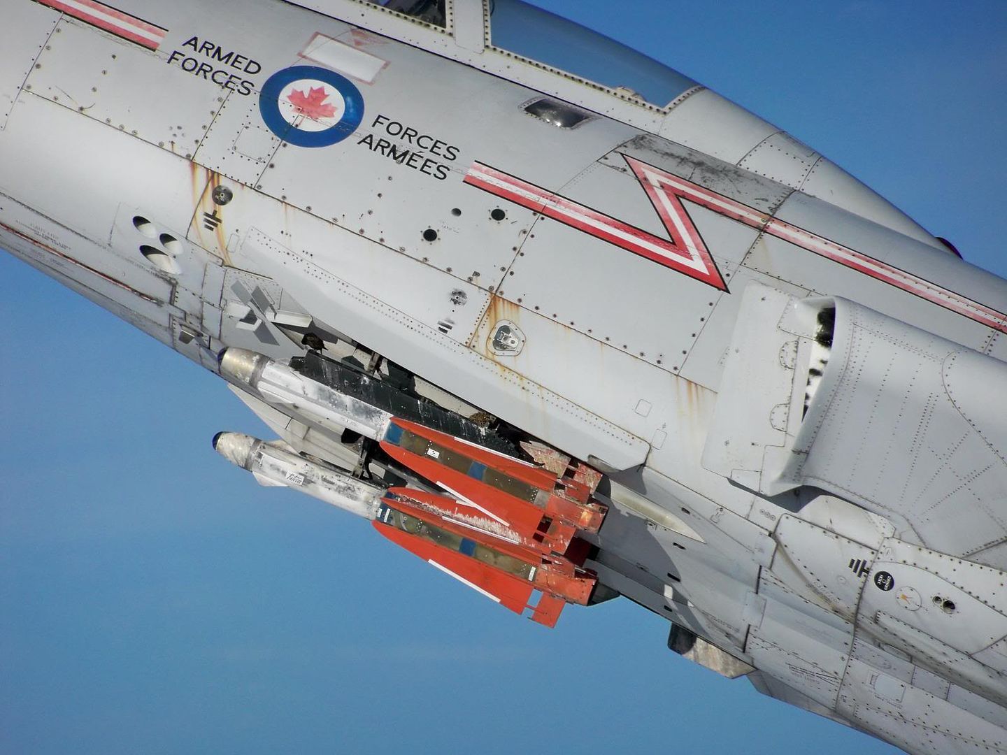

Here's a few of some badly weathered Falcons on the Bagotville museum example.
My favorite preserved Voodoo, as it hasn't yet been repainted by well meaning volunteers
Thanks for the pics, Ian! They're of great help.
