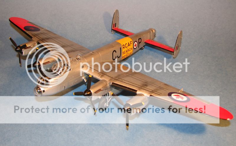

Your Lanc's coming along well. I built one a few years back as KB904 in the first Lancaster SAR scheme, circa 1948 (notice the different roundels on the wings).
I also modified the kit even further by completely filling in the kit-supplied mid-upper turret plug and made a new patch out of 0.005" styrene in the correct late Mk 10 location for the mid-upper turret (further forward, since it was fitted with the Martin 250CE instead of the Frazer-Nash FN50).

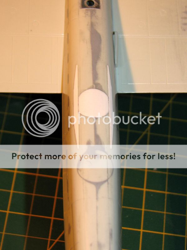

Need a little input guys. I think I figured out the best way to represent the different position for the turret plug on the upper fuselage, Ill just scribe a circle in correct position for the Mk 10 using the kit turret fairing as a template, Ill then putty the seams of the original plug and scribe new panel lines as needed. That should be fairly easy.

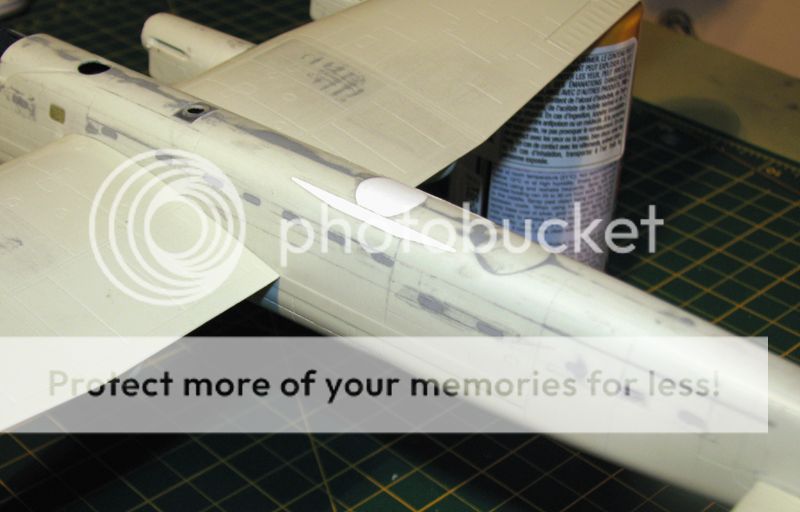

I thought of that on mine too, but it was a royal pain in the butt trying to scribe a circle on a curved surface.
That's why I went with the styrene patch using the kit turret plug as a template.
The patch on the actual aircraft overlaps the hole (ie: not flush) so it's not that bad if you use thin enough styrene. I sanded mine down a bit so the edges weren't as pronounced.
You can see here that the patch and the plug are the same diameter:
Don't forget the stiffener strips on either side of the patch too.
They overlap the lower edges of the patch, but I just ran a razor blade across the overlap and removed the styrene on the patch below the stiffener strip. I hope this makes sense. :lol:

I also took some of Shane's (RCAF_100) advice regarding the patched over turret hole. Once I had puttied and sanded the seams, I cut out a disc of sheet styrene and thinned it out before placing it in position where the turret hole would have been on the Mk10 Lancasters. Once the glue had taken hold, I sanded some more til I was happy with the thickness of it. Tomorrow Ill tackle the re-inforcing strips.
