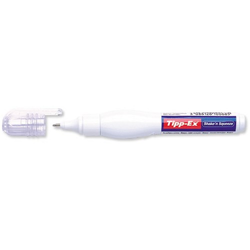

geedubelyer Posted June 3, 2011 Share Posted June 3, 2011 Hello Jannisary, very neat work on your Eagle so far. What I am looking for is some thin putty that can simply seal the seam up without sanding. Any thoughts? Another alternative might be typewriter correction fluid. Here in the UK it goes under the trade name "Tippex". There are also other brands available so you should be able to find something similar locally. Apply the correction fluid then wipe away with a moist Q-tip. I use acrylic paints which don't affect the cured correction fluid at all. If you use enamels I'd suggest trying a practice piece first to avoid any unexpected reactions. HTH Quote Link to post Share on other sites

Janissary Posted June 5, 2011 Author Share Posted June 5, 2011 Thank you everybody for the suggestions and feedback. I ended up using white glue to seal the seam and wiped off the excess with a wet brush. I think it worked out ok. Finally I am onto the more exciting part of the build. I applied Surfacer 1200 thinned with Mr. Leveling thinner. After fixing a few issues, I cleaned up the surface with an old tshirt and a toothbrush. I am now onto applying the colors. I started with Tamiya XF-4 with a little bit of white added. I also add X-22 to the mix to give some sheen to the otherwise flat paint. I plan to mask certain panels and paint them with different shades of the yellow. I will then move onto the green and other colors. These builds are a great inspiration to me: http://www.network54.com/Forum/620142/ Quote Link to post Share on other sites
