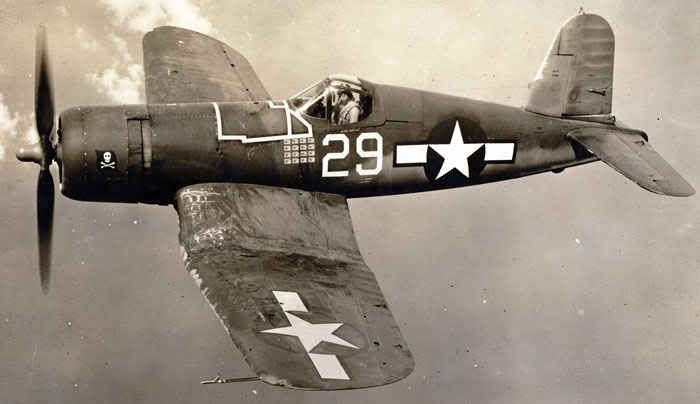

robw_uk Posted April 27, 2011 Author Share Posted April 27, 2011 thanks for the response... I guess I look at photos to give me what I want to see..... not sure as yet if the model will be USS Bunker Hill (the one with the yellow cowling front) or one based in Okinawa (Checkerboard nose/tail)... I have printed a number of photos that show a "difference" in paint eg: http://www.missingaircrew.com/images/corsair13.jpg http://i297.photobucket.com/albums/mm206/tomkwi/tomkwi2/F4UCorsair.jpg http://img.photobucket.com/albums/v730/fugari/CaptKirkpatrick.jpg enough to make me think there could be some fading/weathering etc.. also just noticed a huge mistake on my part... didnt open up the holes for the rockets - and all aircraft i see have them - ah crap!!!! Quote Link to post Share on other sites

robw_uk Posted April 27, 2011 Author Share Posted April 27, 2011 (edited) have reviewed again and yes the ones on carriers do look in good nick - which implies that the heavily weatehred ones (thae number 29 plane in the links i posted for example) would be land based.... therefore I will look at VMFA-312 based out of Okinawa and see what comes up there...... maybe "weathering the hell" isnt what I intended... but will do some more digging..... this shows a weathered one (ok not the same Sqn so will research its history) is this difference becasue this seems to be the tri-colout scheeme (was that paint more prone to fading than the Gloss Sea Blue? Edited April 27, 2011 by robw_uk Quote Link to post Share on other sites

greatgonzo Posted April 27, 2011 Share Posted April 27, 2011 All three pics shown are land based birds. 29 is a probably most famous pic of Ike Kepford's VF-17 Corsair. Kirkpatricks 'Palpitating Pauli' belongs to VMF 411. Different camouflage, different conditions though. But the latter one belongs to Okinawa campaign . Be sure the step is polished up to dead metal with ZCY showing only on the edges :). It's -1D You are building I understand? Quote Link to post Share on other sites
