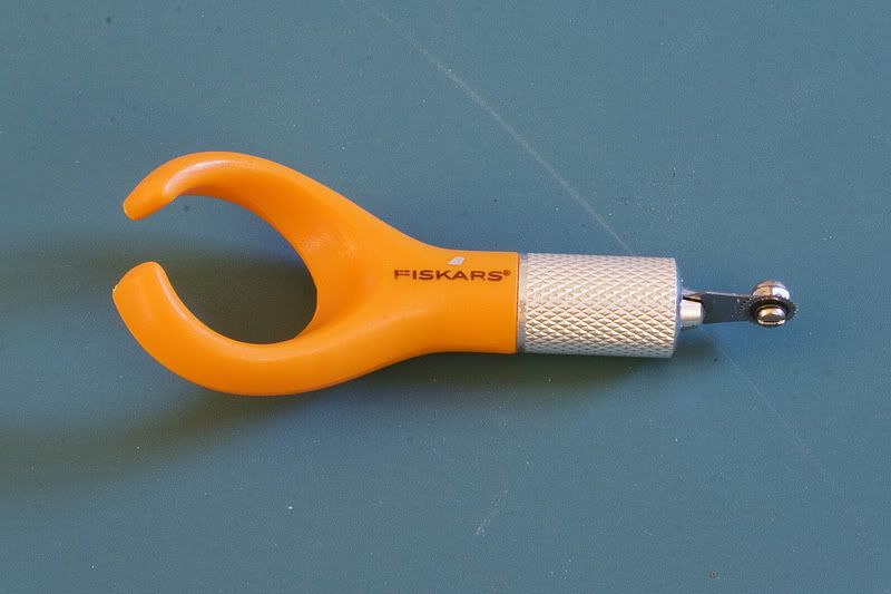

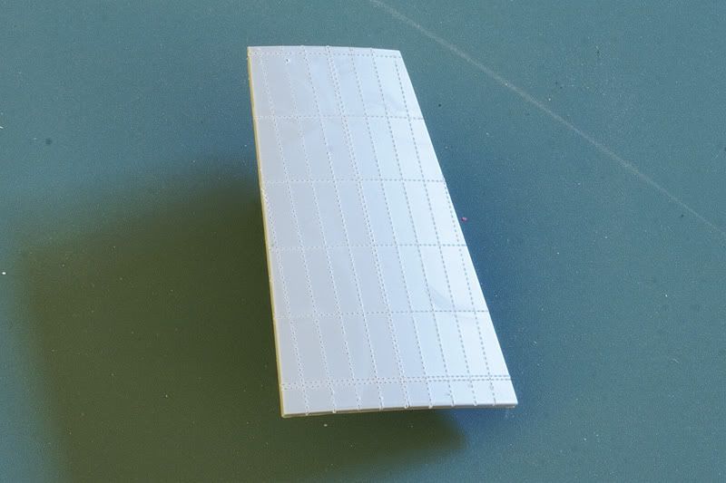

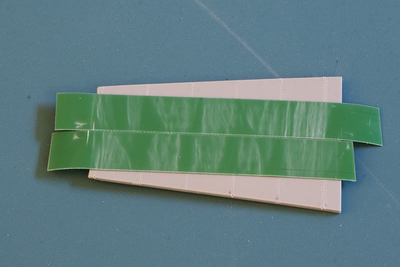

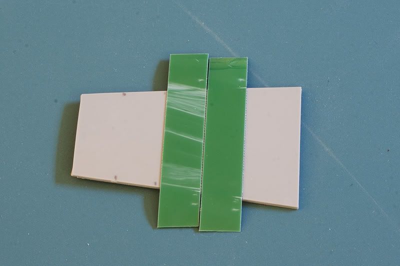

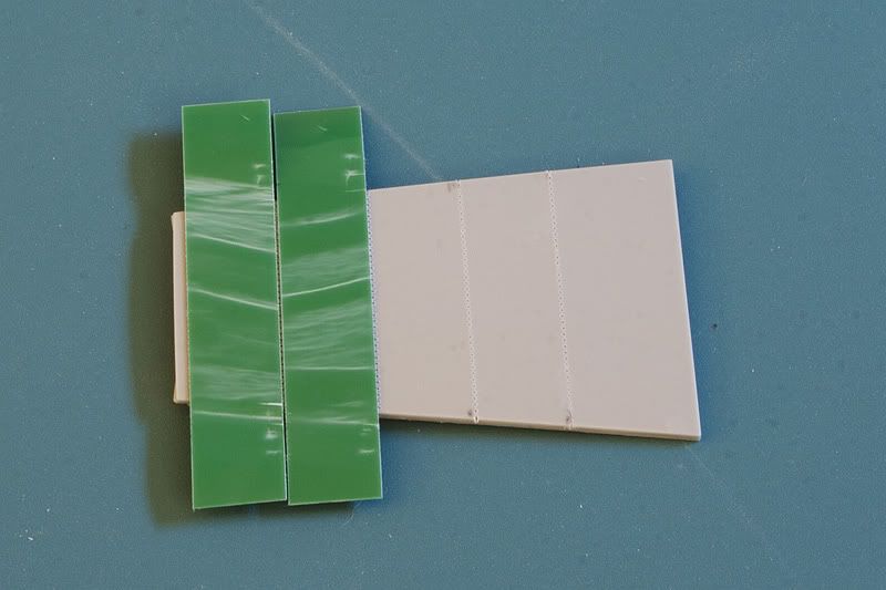

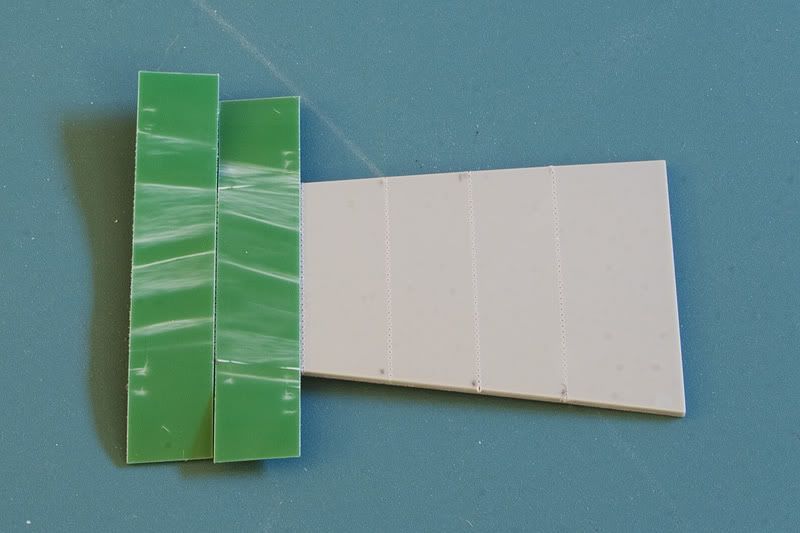

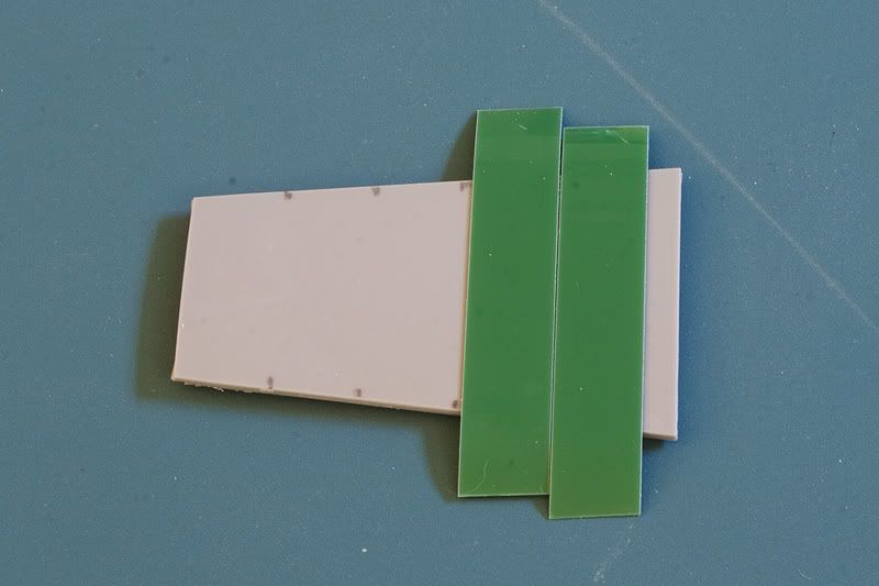

doupnik Posted July 22, 2011 Share Posted July 22, 2011 If you haven't given up on riveting here's what I did. I am using Rivet-R mini, here with a Fiskar handle. I use the smallest wheel. I've found that the Dymo tape works out pretty well for spacing. If I am not mistaken the vertical spacers on the real A/C are @ 48" and at 48th scale works out to .25" which is the width of the roll of tape. So I mark out the general position of the rows in pencil and cut two pieces of Dymo tape for alignment. Once I get one row down, I start leapfrogging the tape each subsequent row, double checking the alignment as I go. The lengthwise rows require a little more work. On this piece I started on the center and worked to the outside. Once I got the center line down I used a compass to measure out each line. At the end of it all I go from here- to here- Hope this help. mason Quote Link to post Share on other sites
