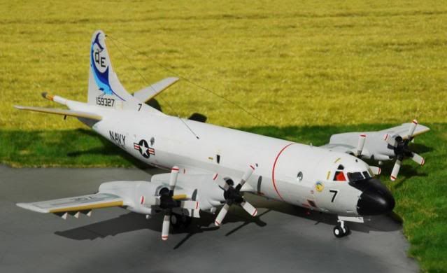

Started this about 1987-1988 and got the main construction complete. Put it in a box to wait for better airbrushing skills. Sat until July 2011.

This build is going back and forth with my M1A1 for the NA Forces in Europe GB, so it may not be too speedy. Thanks for looking.

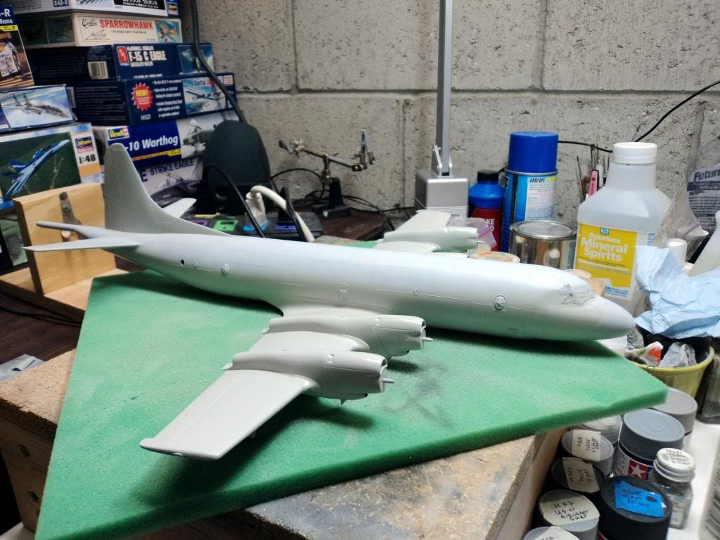

Putty after primer, repeat ad nauseam. Seems the 25 year old seams in this thing keep wanting to open up again. More Tamiya Super Thin, please! :explode:

OK, this beastie is all together and the seams seem to have stopped opening up. Primer on, now Light Gull Gray (Testors acrylic):
