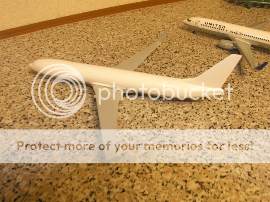

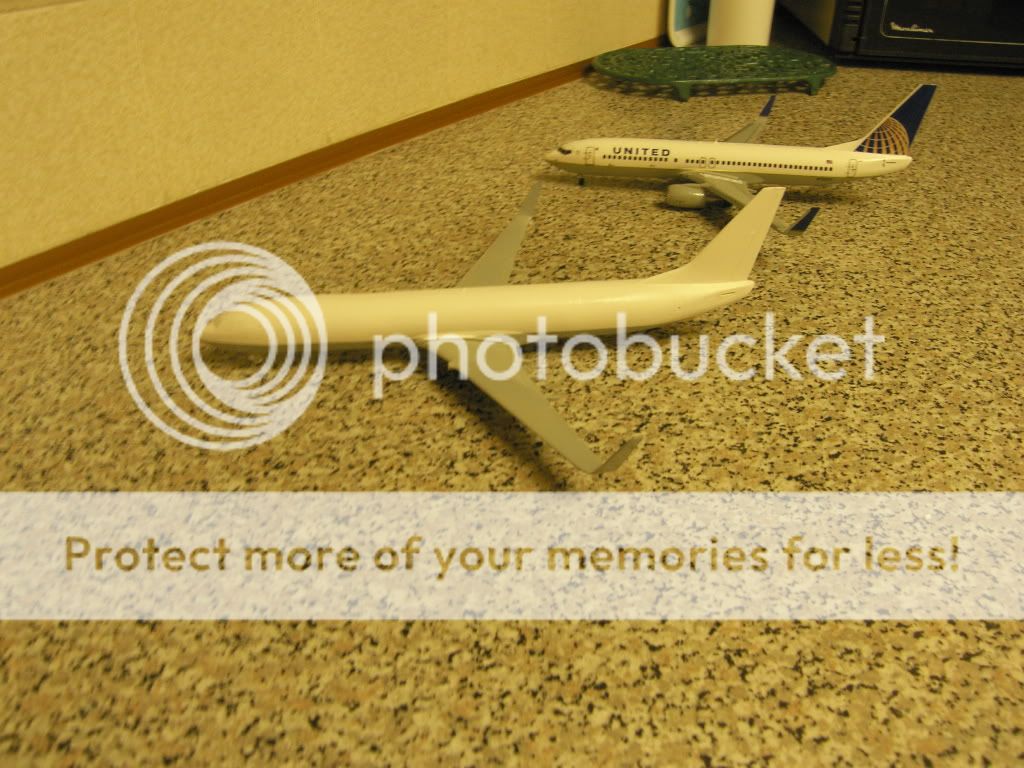

RICH W Posted January 5, 2012 Share Posted January 5, 2012 (edited) i have done a couple of conversions into the -900 a few years ago but here are some pictures of the current one i am doing the fuselage sections cut up i cored a 29mm plug using a hole cutter out of a piece of wood this fits nicely into the 737 fuselage and helps to locate the fuselage sections when gluing back together I prefer to use the wooden plugs and leave the gaps and fill them rather than glueing the bits back in that have been cut out when doing a 737-700 conversion all glued up just needs some filler also i will me modifying the engines as i did i a previous post so them look like this rather than flat on the bottom Richard Edited November 11, 2012 by RICH W Quote Link to post Share on other sites
TheFlyingDutchman Posted January 6, 2012 Share Posted January 6, 2012 You need quite a lot of filler I think? What is the reason you prefer to fill the gaps by filler instead of using leftover fuselage pieces? It seems to me you can apply those over the wooden plug and do the rest with filler. What livery will this model get? :) Quote Link to post Share on other sites
streetstream Posted January 6, 2012 Share Posted January 6, 2012 You need quite a lot of filler I think? What is the reason you prefer to fill the gaps by filler instead of using leftover fuselage pieces? It seems to me you can apply those over the wooden plug and do the rest with filler. What livery will this model get? :) You have leftover fuselage piece only if you use 2 kits. If you use one kit (for financial reasons) and you make it longer, you are left with a gap and no fuselage pieces to fill it. I would however us some evergreen plastic to fill most of it before applying filler. Quote Link to post Share on other sites
TheFlyingDutchman Posted January 6, 2012 Share Posted January 6, 2012 You have leftover fuselage piece only if you use 2 kits. If you use one kit (for financial reasons) and you make it longer, you are left with a gap and no fuselage pieces to fill it. I would however us some evergreen plastic to fill most of it before applying filler. I know that, but he mentioned he once made a 737-700 so he should have some 737 fuselage left :) Quote Link to post Share on other sites
streetstream Posted January 6, 2012 Share Posted January 6, 2012 I know that, but he mentioned he once made a 737-700 so he should have some 737 fuselage left :) Sorry. Scrolled right passed that piece of text. Quote Link to post Share on other sites

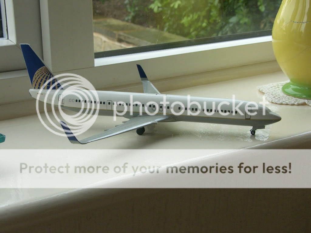

RICH W Posted July 29, 2012 Author Share Posted July 29, 2012 I Have just finished painting the 737-900 will be a 737-900ER when i have finished it using my own decal set the -900ER is the only 737 series missing from my collection Here are some photos of the model at the moment The winglets are my own made ones Richard Quote Link to post Share on other sites

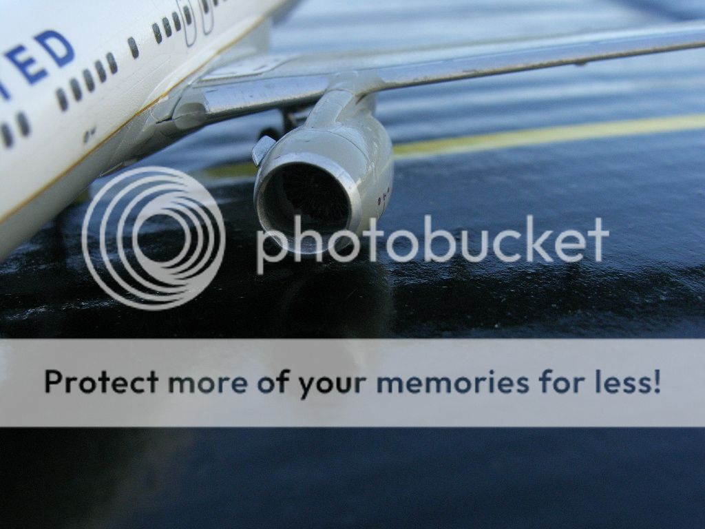

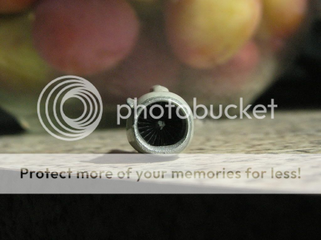

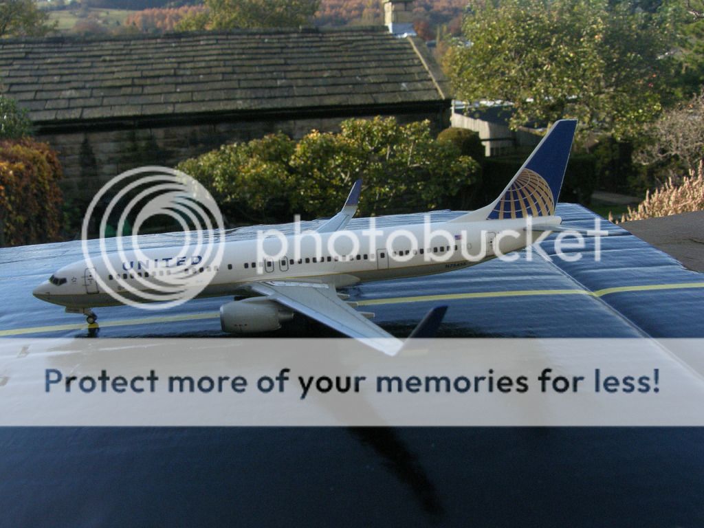

RICH W Posted November 11, 2012 Author Share Posted November 11, 2012 I have finally got arround to posting some finished pictures of this model here they are The modified engine intake to make it look more rounder Richard Quote Link to post Share on other sites
