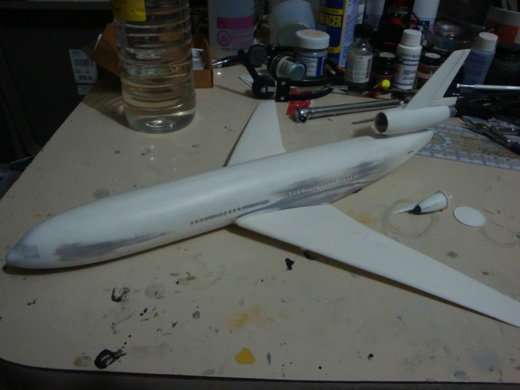

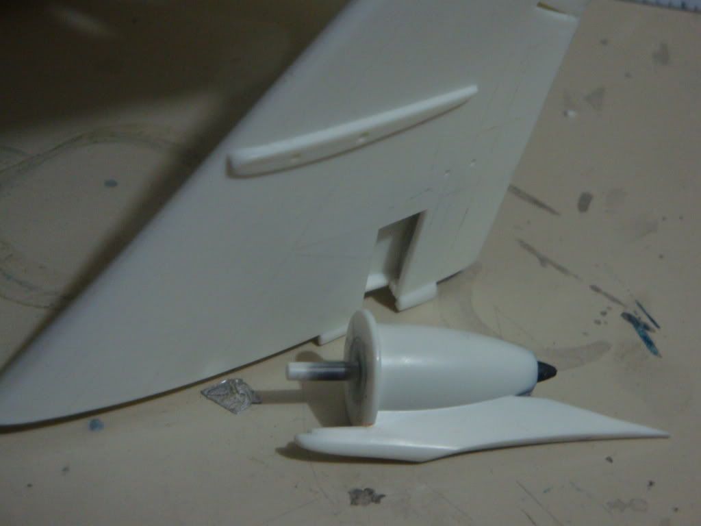

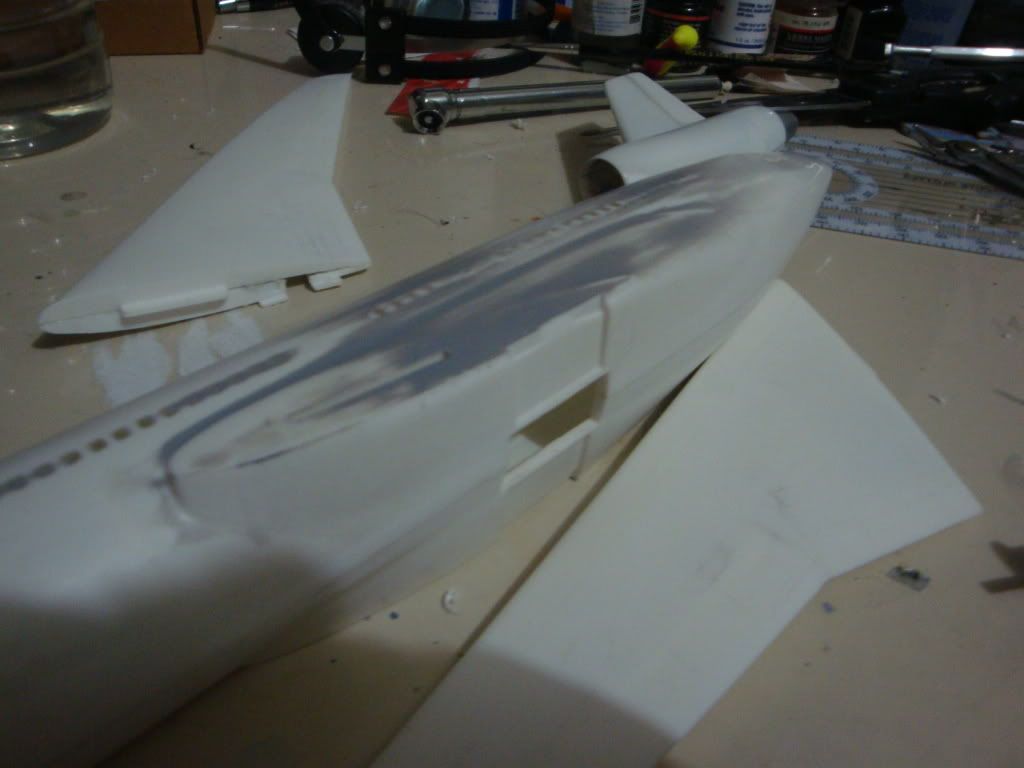

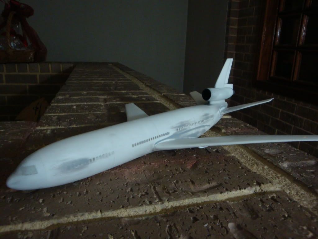

MaRiO FDZ Posted January 6, 2012 Share Posted January 6, 2012 (edited) Hi fellas After my 777, I'm still in an airliner groove, so after a medium dificult kit I go to a difficult kit: Airfix's DC-10-30 1:144 I starte this kit sometime before final construction of the 777, but since I have contact with my models only during weekdays, progress is SLOOOW. I actually just touched it today after almost a month in the bench. Anyway, this kit requires certain corrections have to be done to this kit to make it look right. The most important one is the Engine pylons sit waaay too low. You have to cut 1/8 of an Inch from them to make them look right. Also, windows are too low, they must be filled. The middle gear has no gear bay, so I had to scratch build that. I also used blue tac to fill the MLG bays under the wings, and used a mix-a-putty to fill the nose for weight and shape it into form. Anyways, picture time. Le Decals await. Le DC-10. The No.2 engine was painted, assembled. I stuffed some tissue paper down the duct, wet it so it would compress more, and added filler to the seam. After some sanding and priming to check, it looks ok. Same thing was done for the engines. Le pylons cut. Again, 1/8 of an Inch was trimmed out , and some tenax or some other heavy glue will be necesary for the attatchment... During this process, the wings, horizontal and vertical stabilizers were scribed according to reference The Middle gear area cut open. I shall scratch build the compartment to give it some depth. It will be very hard to see, anyway. Le DC-10 today. Ran out of CA, so back in Holding pattern. Some minor details to the Central gear bay are missing. Le middle bay. Le Engines. Next in line, paint the white (Tamiya) on the engines, and aluminum for everything else... then to see how to attatch it to the wings... hmm I shall continue the kit next week. Progress pics will come. Thanks for le comments. Take Care Edited July 22, 2012 by MaRiO FDZ Quote Link to post Share on other sites

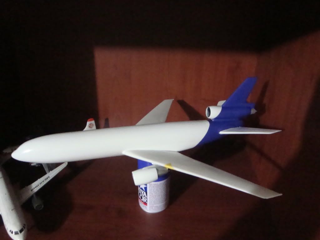

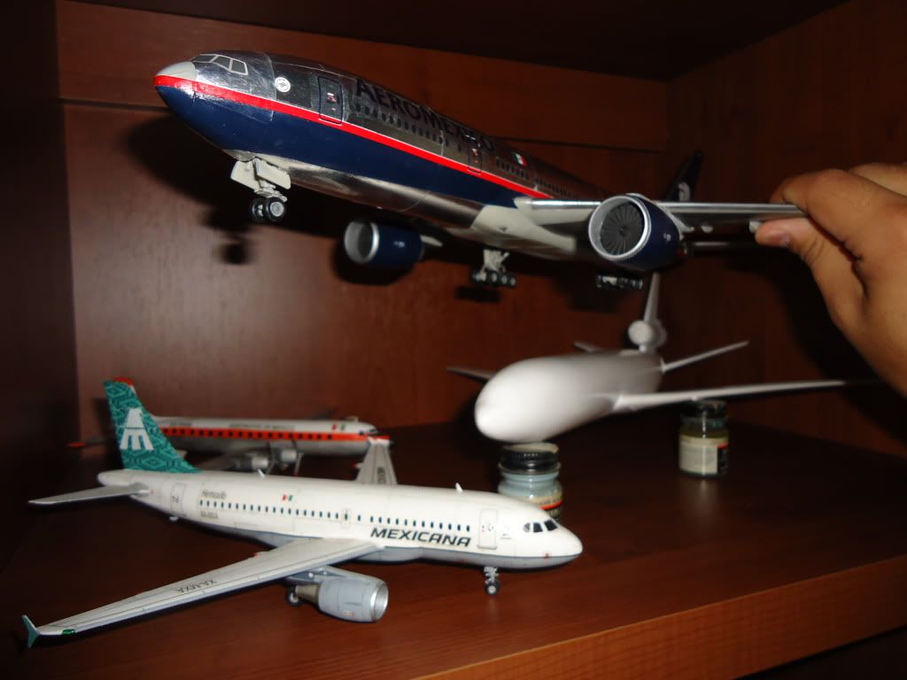

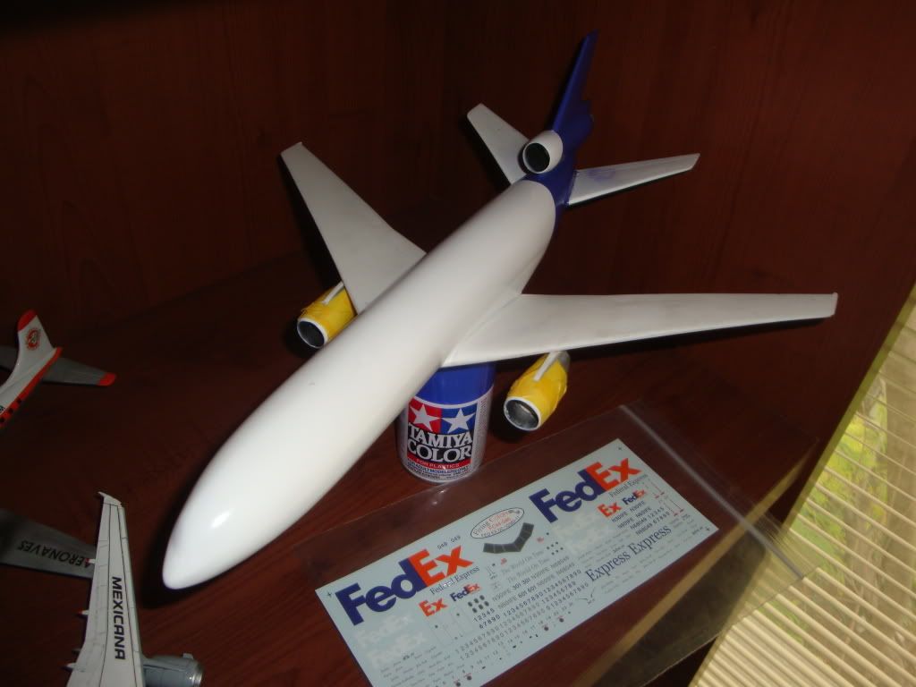

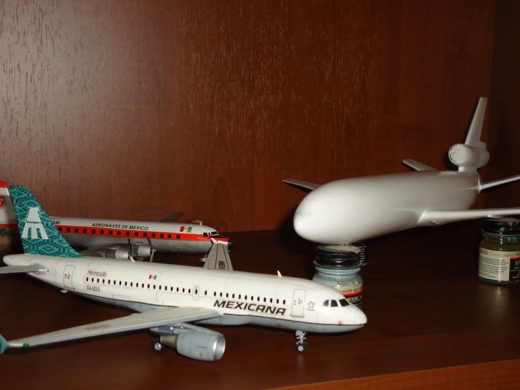

MaRiO FDZ Posted January 26, 2012 Author Share Posted January 26, 2012 Hi Fellas So After after 3 weeks I can Finally do some work and update this thing... pretty basic update, Tamiya TS-26 Pure White for the Fuselage... Letting it cure for now, tomorrow I have little time, so some Masking will be applied for the first color, the Gray underside that runs along the aircraft. After that, the purple, and finally, the Aluminum. Here's some size for comparison with a DC-6, an A319... Aaaand a 777. :) All 1:144 Scale!! Take Care!! Quote Link to post Share on other sites

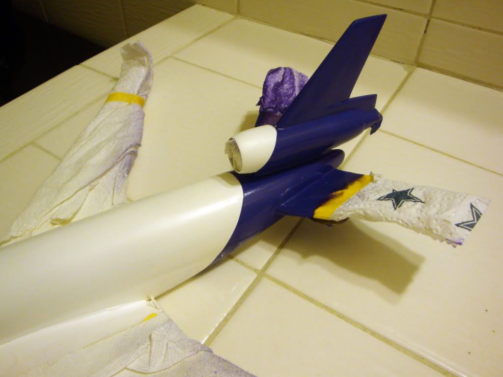

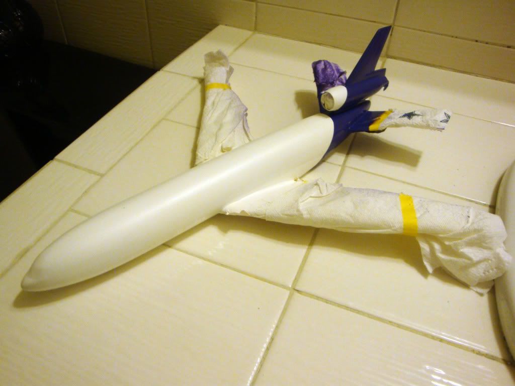

MaRiO FDZ Posted February 24, 2012 Author Share Posted February 24, 2012 Thank you guys Update. Doing a color check, I realized Testor's Model Master Ultraviolet Pearl is a match to FedEx purple... but thing is, when I applied it, it turned out with small glitter. Its a car paint, and it shows. So doing some research, About 3 or 4 people suggested Tamiya Purple. I wasn't sure it would work, but it actually did splendidly. Just an under layer of Tamiya dark blue and voilá! Anyways, the With the purple on, it is now time too let it cure, and next up touch ups before the Future coat. The wings go Aluminum, so those are last. Thanks for the comments. Take Care Quote Link to post Share on other sites

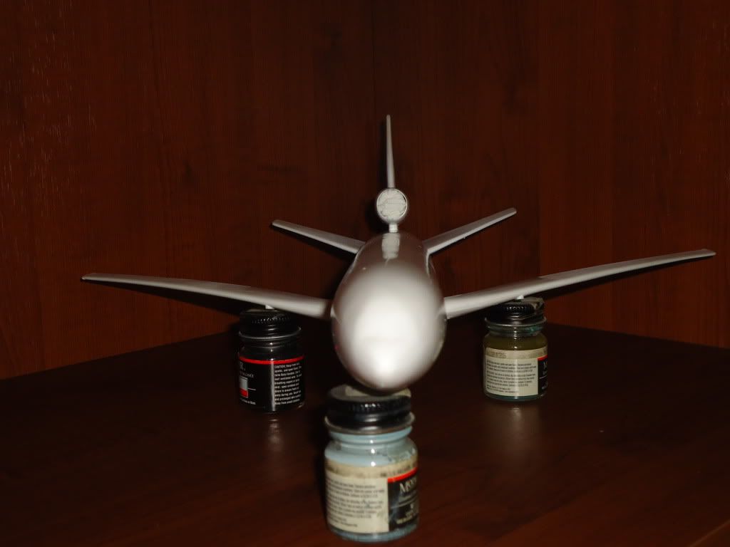

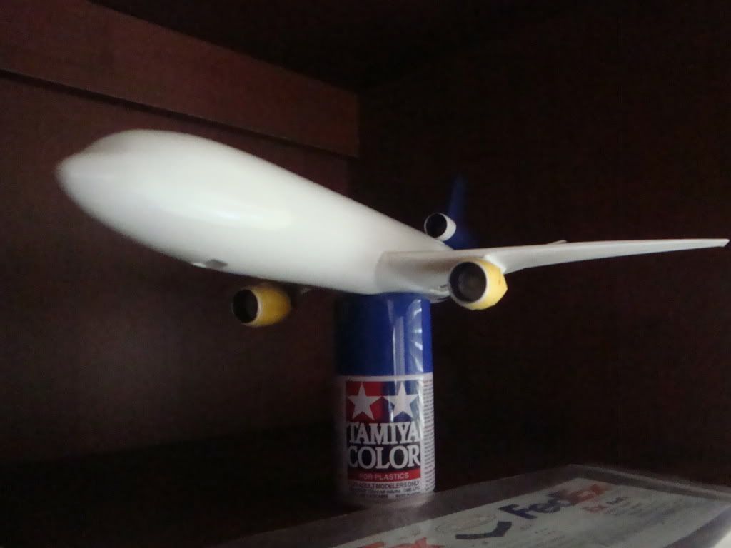

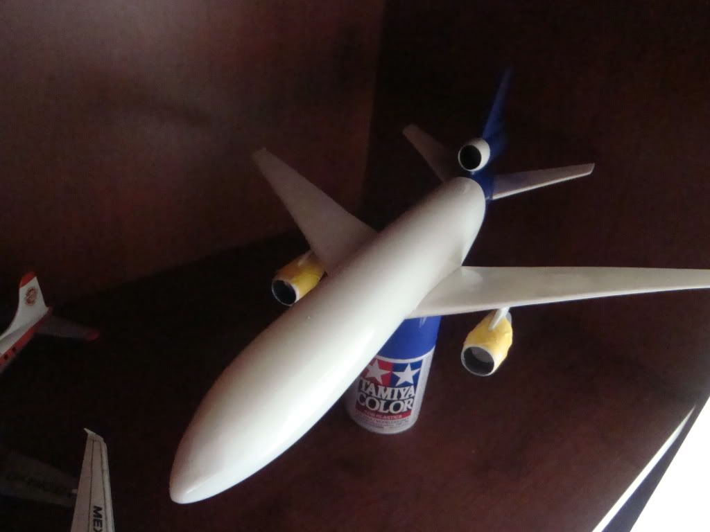

MaRiO FDZ Posted March 1, 2012 Author Share Posted March 1, 2012 Update Future Coat on... waiting for it to dry to start masking for the aluminum color: Wings, Horizontal Stabilizers, engine intake rings and belly. Engines Dry Fitted for Picture, they are also waiting their future coat. Thanks for your comments. Take Care Quote Link to post Share on other sites

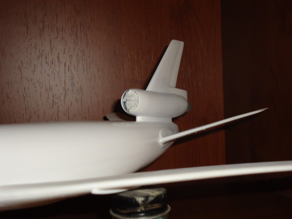

MaRiO FDZ Posted March 1, 2012 Author Share Posted March 1, 2012 Another Update, Engines glued... masked for the Aluminum ring. Next up, to fill and sand the engine pylon/wing seam, while the rest of the future cures... after that, it is masking again all the white and purple for the black undercoat, then the aluminum... And a pic to remind of things to come... Take Care Quote Link to post Share on other sites

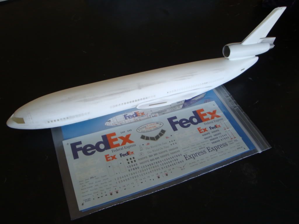

MaRiO FDZ Posted August 1, 2012 Author Share Posted August 1, 2012 (edited) Aaand... update. Again, pics of the plane minus the main Decal... the FedEx big one on the side (both of them) Broke on me, so... I added what I can and now I must wait... 2 pics Take Care Edited August 1, 2012 by MaRiO FDZ Quote Link to post Share on other sites
