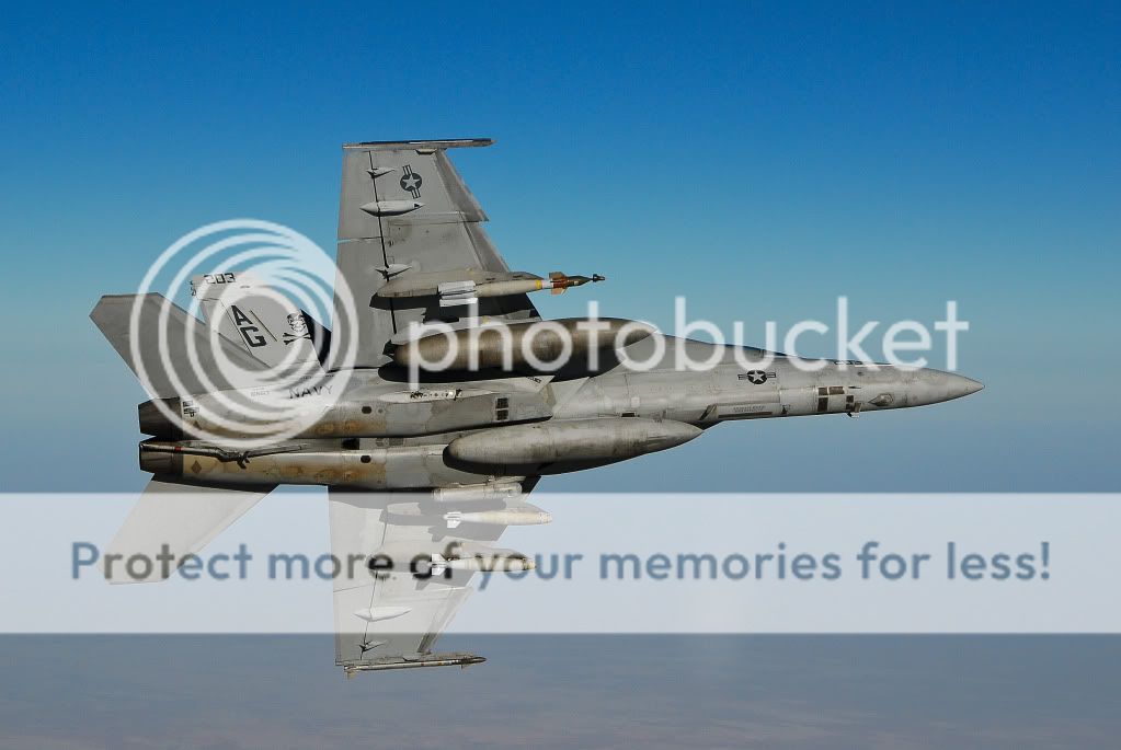

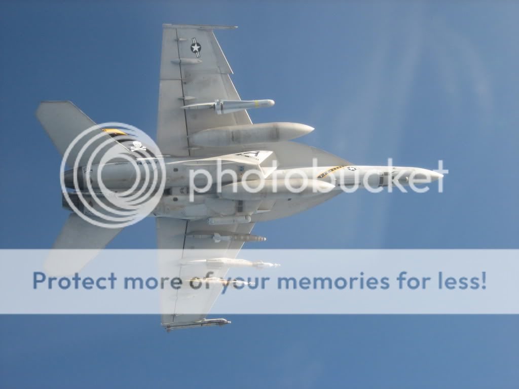

VFA-103guy Posted January 7, 2012 Share Posted January 7, 2012 (edited) Hey Brian- Super hornets are typically carrying these load outs (in the pics below) right now. I can't say I've seen the SLAM-ER loaded operationally, but I haven't been keeping up with things like I used to. Anyway, you should at least have the ATFLIR loaded on the left cheek station. Anyway, here's a few pics for ya. This last pic is on navy.mil, but a friend of mine took the original and I have the 10mb version..lol Edited January 7, 2012 by VFA-103guy Quote Link to post Share on other sites

mawz Posted January 7, 2012 Share Posted January 7, 2012 I did notice this as well, which I have seen in so many pictures, they seem to really like to leave off a pylon, or two, or three!! Unsurprising, the canted Rhino wing pylons are high drag, so leaving as many off as possible is to be desired. Quote Link to post Share on other sites
