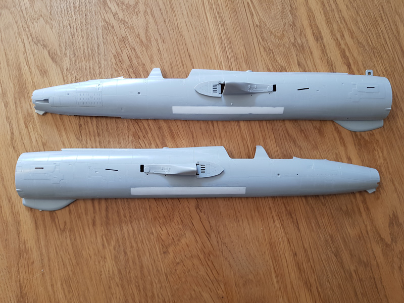

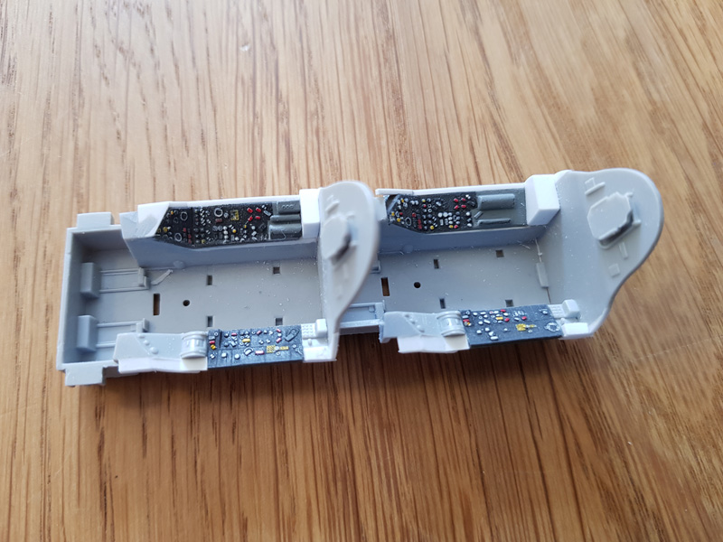

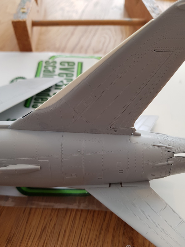

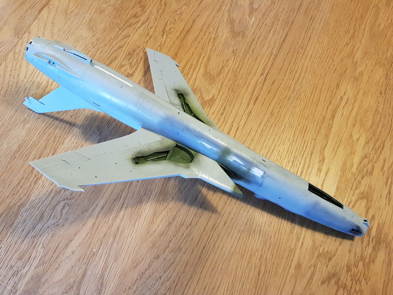

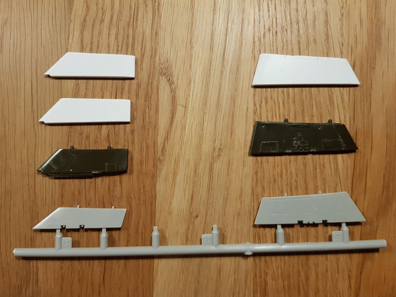

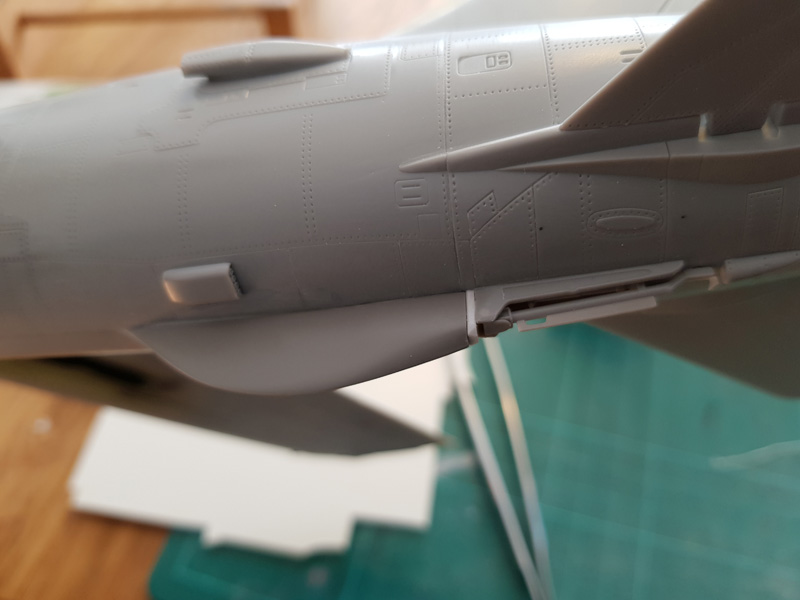

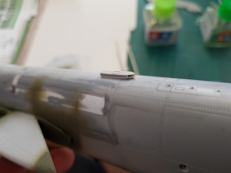

I have been working on the HB F-105G for some time. These are the things I corrected/improved:
- Removed large ECM blisters on fuselage (I am building an early F-105G).
- Replaced consoles etc. in the cockpit (my next HB F-105 will have a resin pit).
- Replaced the fat ventral fin with one from Quickboost and added details around that area.
- Increased the tail fin chord by simply adding a piece of plastic card on the leading edge and forming the leading edge with Tamiya putty.
- Modified the intake on the belly (the HB item looks a bit shallow).
- Scratchbuilt new wing pylons from plastic card.
- Replaced weapons with Hasegawa items.
- Added belly straps from adhesive aluminum foil.

To me, the seats are a non-issue (replace with a/m if I have to); the warload is a non-issue (I have a LOT of Shrikes, StandardARMs and HARMs, as well as various ECM pods from other WW builds, and from a/m); the canopy curve is a non-issue (open or closed - one or the other almost ALWAYS hides the majority of that issue); tank fins - seriously non-issue... I have plenty of plastic card!
Potential issues tho - those main gear legs looks a bit fragile?
Thoughts?
Dan
What would be a typical loadout for a Vietnam era Wild Weasel? AGM-78 but in combination with what?  I'm guessing not with AGM-65's?
In my opinion, scale thickness, or "thinness" of the tail is at least as big an issue as outline when critiquing available F-105 kits. The Thud’s vertical stabilizer had a blade like cross section, befitting a double sonic strike fighter. Available F-100 kits suffer this same ignominy, while the rest of the Century Series seems better served by kit manufacturers in this regard.
