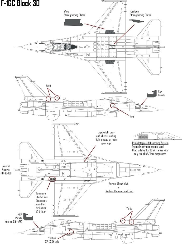

Bigasshammm Posted March 20, 2012 Share Posted March 20, 2012 (edited) Resurrecting this one as I just started a build. In this diagram the strengthening plates what would be the best way to scratch them? Are they recessed or would they be bumped out? Basically should I just scribe the lines for them or cut out pieces of PE or thin styrene and just glue them directly to the surface? Thanks Same with the RAM panels on the nose? Edited March 20, 2012 by Bigasshammm Quote Link to post Share on other sites
dmk0210 Posted March 20, 2012 Share Posted March 20, 2012 (edited) They are raised from the surface. You probably could cut them from PE or thin styrene. The main problem would be getting them to conform to the surface and lay flat. They also have some surface detail (rivets and such). Check some good clear hires pictures for detail. Edited March 20, 2012 by dmk0210 Quote Link to post Share on other sites
