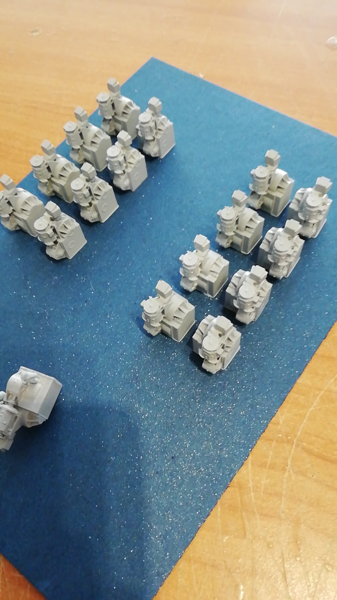

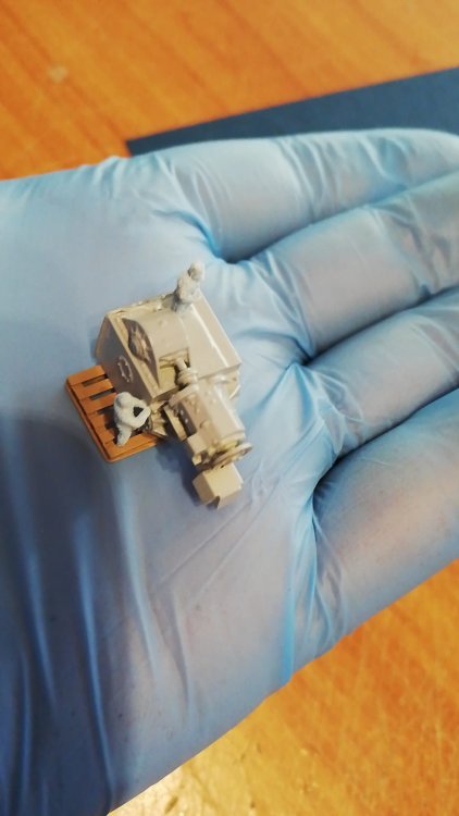

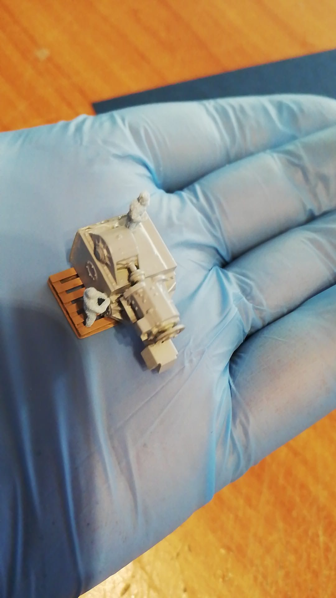

crackerjazz Posted September 3, 2021 Share Posted September 3, 2021 Hi Manfred, here are some test shots that @bubble sent. He couldn't upload them to ARC at the moment so he asked me to post the pics for him. They look great -- he printed them in 1/72 and 1/144 but he's saying the gearbox warps a little under the UV lamp. I guess that means more thicking required for printing in 1/160. Quote Link to post Share on other sites
spaceman Posted September 3, 2021 Author Share Posted September 3, 2021 (edited) Hey Joe, wow, I've written bubble, that he is faster than the police allows!!! I told him that I need the combos at 1/160 scale, what is pretty small indeed, and asked him if he can try to print this, because a direct size comparison is important. BTW, what should you do massive, as he said, the gear case walls or he whole combo? Maybe the UV curing with Resin printing is comparably a similar tricky problem as the Support wax problem with SW's printing? Only a thought ... Edited September 3, 2021 by spaceman Quote Link to post Share on other sites

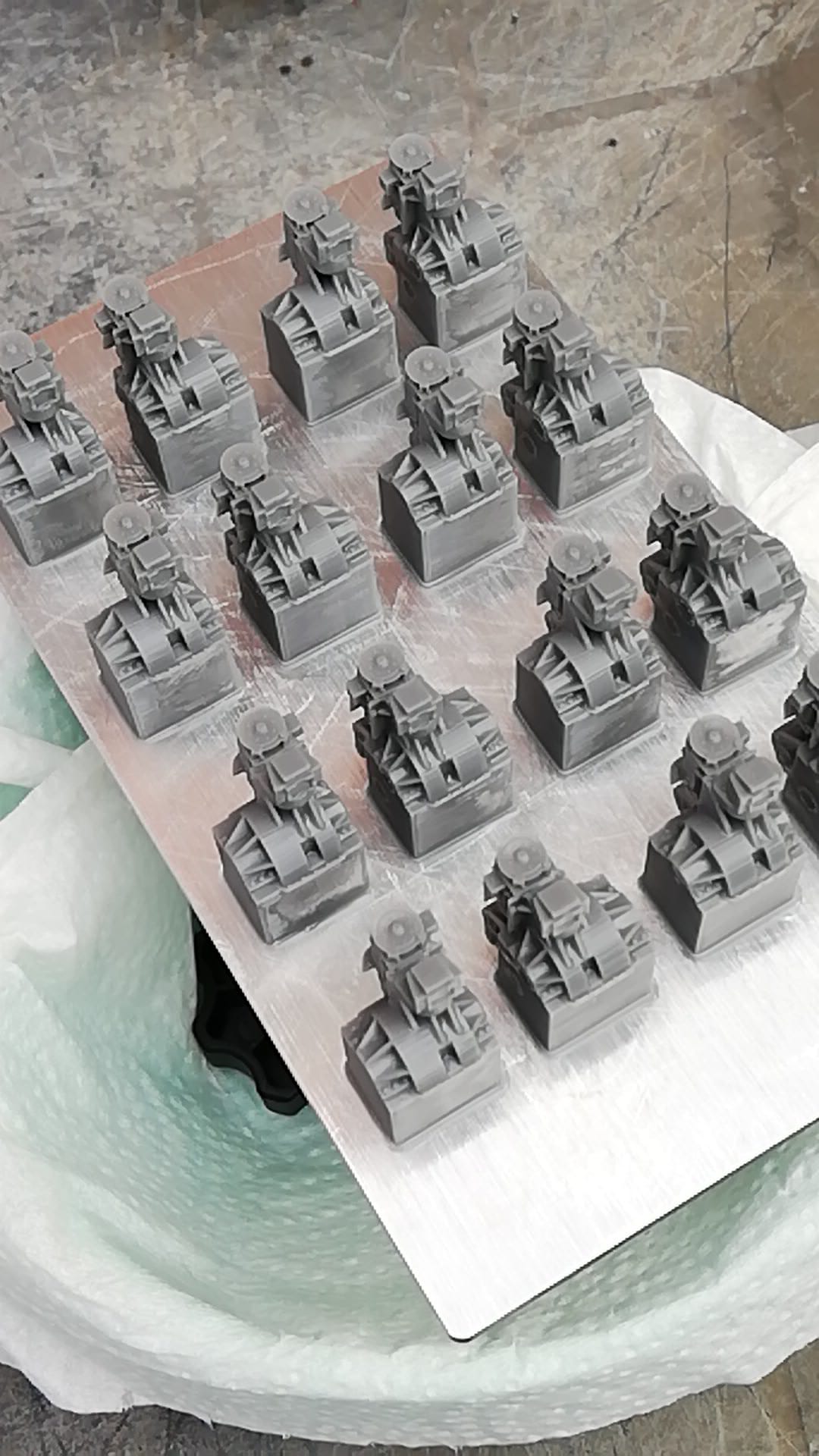

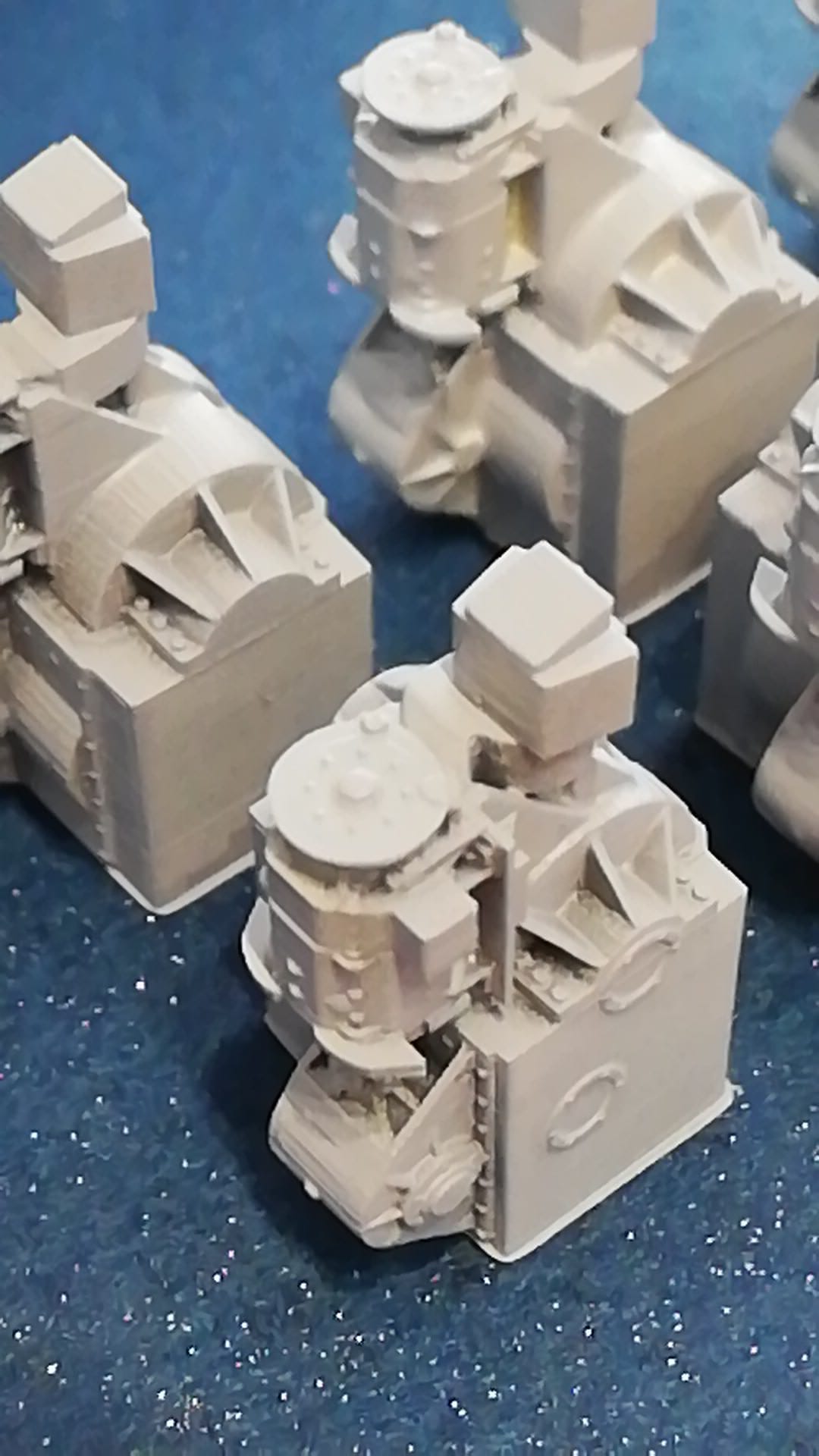

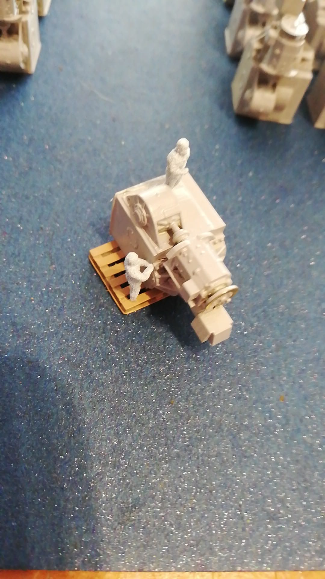

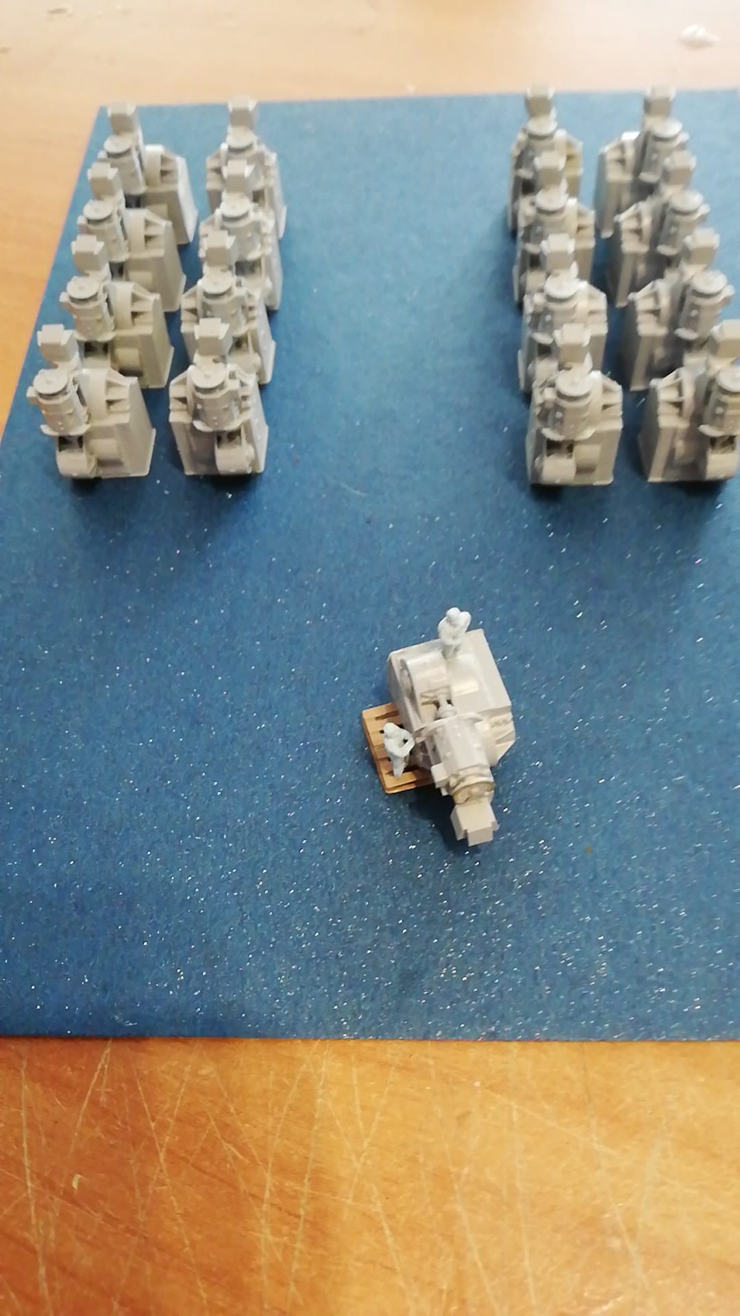

bubble Posted September 5, 2021 Share Posted September 5, 2021 On 8/29/2021 at 2:19 PM, spaceman said: Hi Joe, I can understand your interest in good 3D printers well, but please discuss this with each other via PM, okay? I'll get in touch with you today about our problems with the optimal print orientation of the Motor-Gearbox Combis. they are done Quote Link to post Share on other sites
crackerjazz Posted September 5, 2021 Share Posted September 5, 2021 Wow, they look amazing, Bubble! : ) Quote Link to post Share on other sites
spaceman Posted September 5, 2021 Author Share Posted September 5, 2021 (edited) Hi Bubble, what kind of a mirage is that? You're either a magician or a warlock, incredible and overwhelming! Are these 1/160 scale combos? Did you print it gray or paint it? The Pad guys are looking cool! Edited September 5, 2021 by spaceman Quote Link to post Share on other sites
