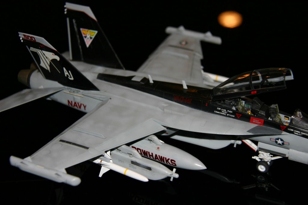

jward Posted August 4, 2012 Share Posted August 4, 2012 Just finished this as a commission build. Kit goes together fairly well but some modification is needed with panel lines, filling gun holes on nose, vents, etc. to represent an accurate Growler. Decals are a bit thick but register was perfect IMHO. Perhaps the bests feature of the kit is that it does come with 2 AMRAAM's and 2 HARM's. Finally - weapons in a Has. kit! Overall a great kit and I plan on building another in the near future as this kit really captures the look of the Growler! Enjoy the pics and any comments / critique is welcomed: Jim Quote Link to post Share on other sites

blunce Posted August 4, 2012 Share Posted August 4, 2012 Looks purdy good, but seems a bit tough to see. Perhaps some photos on a white background? And since this is "critique forum", I'll offer this observation: while the aircraft looks to be somewhat weathered, the nozzles look pristine. I'd like to see more color variation in them. Also, try and increase your F-stop to get more depth of field for the focus. See how the area that is focused is fairly small compared to that which is blurry? Increasing your F-stop helps this. But other adjustments then become necessary as well. Good to do a search on that, there's been threads here before on photo tips that cover this. Other than that, GREAT build! Quote Link to post Share on other sites
jward Posted August 4, 2012 Author Share Posted August 4, 2012 Thanks for the comments. Blunce - you are correct about the nozzles. I need to highlight the lines to give it some depth and realistic finish. Forgot to do that . . . thanks for pointing that out. As for photography - I'm a novice but will certainly look into the F-stop feature and how to use it better. Jim Quote Link to post Share on other sites

Fly-n-hi Posted August 8, 2012 Share Posted August 8, 2012 This is a nice build. It looks great. Since you asked I'll point out a couple of things. Please don't take this as a slam against your nice work. 1. It looks like you might have attached the outer smaller pylons on the wrong sides. They should angle outward from the plane at 4 degrees. It might just be the photo but it looks like yours are angled inwards. 2. This is minor but there should be a little bit of grey around all sides of the anti slip areas on the LEXs. 3. The two small rectangles on the left LEX should be darkened. You could fix that very easily. 4. I could be wrong about this but I think the dark grey grills on the wings where the wing fold hinges are shouldn't be there on the Growler. Hasegawa didn't catch this detail if my memory serves me correctly. I'm not 100% sure on this one, though. 5. The dark grey vents under the nose in front of the nose wheel well aren't there on the Growler. Those are purge vents for the gun gasses but since the Growler doesn't have a gun... 6. The exhaust nozzles on the Superhornets are dark on the inside. The legacy hornets are light on the inside. These are nit-picky observations, of course. Quote Link to post Share on other sites
