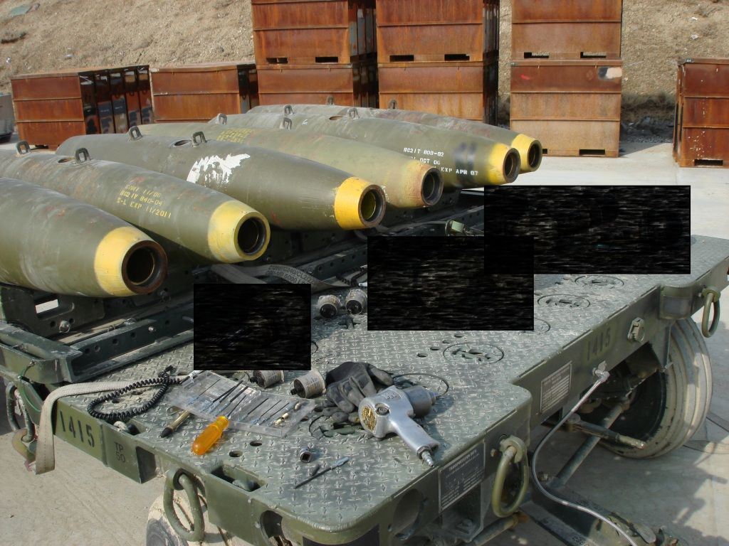

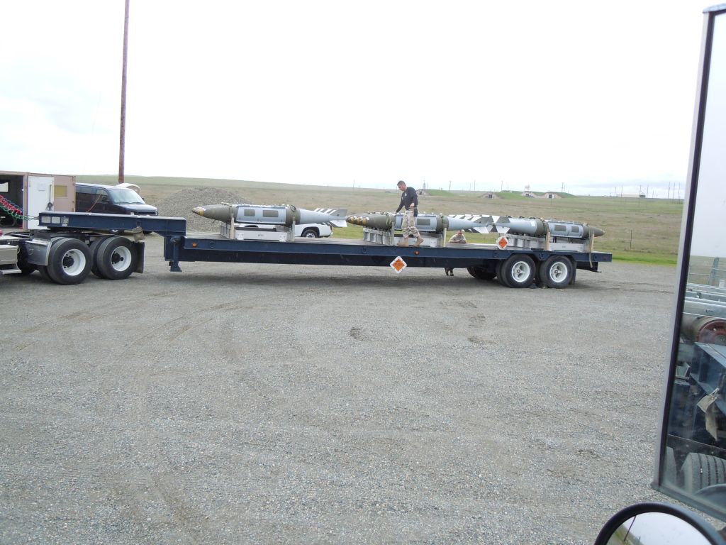

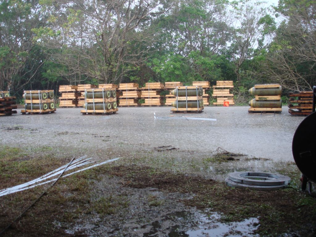

Doughboy Posted August 21, 2012 Share Posted August 21, 2012 (edited) FWIW I would not worry too much about it. A lot of the bombs we used did not have a clean edge especially in the AOR. Here is a pic of some 82s I took at Bagram showing what I mean. The 82/84s we see commonly stateside are typically in better condition than the AOR bombs. The lines are cleaner and the OD is fresher. However every 82/83/84 I've ever seen in the USAF the tip of the nose is painted yellow. The Navy uses the stripes. BLU-109/113s M-117s are a different story they use stripes. Edited August 21, 2012 by Doughboy Quote Link to post Share on other sites

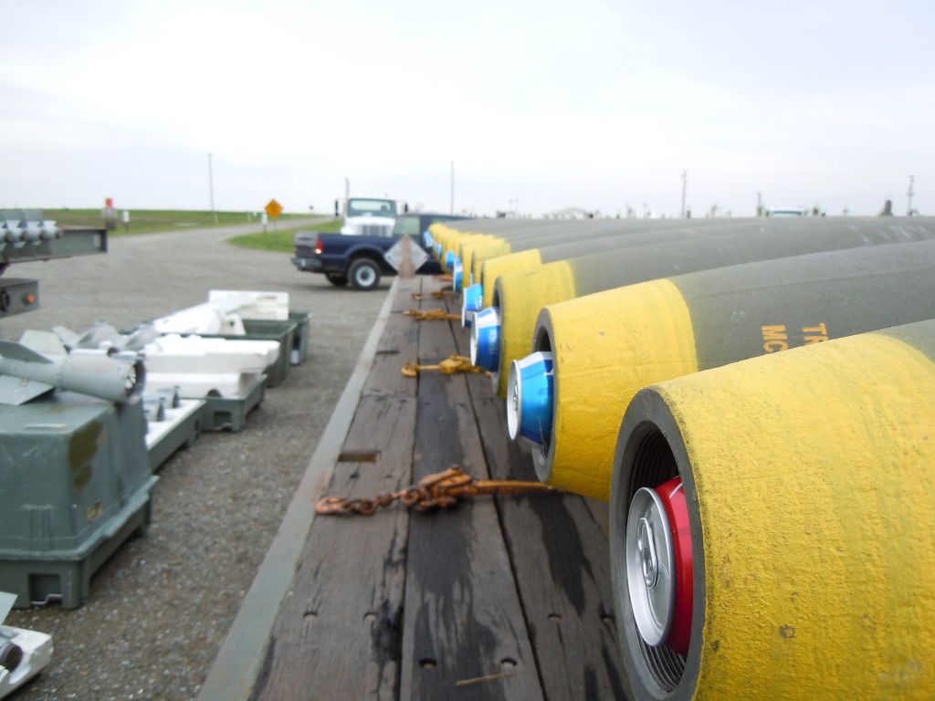

Kaibutsu Posted August 21, 2012 Share Posted August 21, 2012 Hey DoughBoy, Great pictures, but what's with the beer cans in the second picture? Just wondering Quote Link to post Share on other sites
Doughboy Posted August 21, 2012 Share Posted August 21, 2012 Hey DoughBoy, Great pictures, but what's with the beer cans in the second picture? Just wondering That is from AFCOMAC at Beale AFB. USAF Ammo troops have to go up there for training starting at E-5. We go up there lean a bunch of war fighting planning and execution things. This culminates in a week long exercise. Deployed students build the bombs and the people permanently stationed there tear down the built up munitions and put them back in the igloos. Tradition is that when we do a build that requires nose support cups we put beer in the fuze wells for the permanent party guys to enjoy. So we built up a bunch of G-38s and put the beer in the noses for them! Quote Link to post Share on other sites
