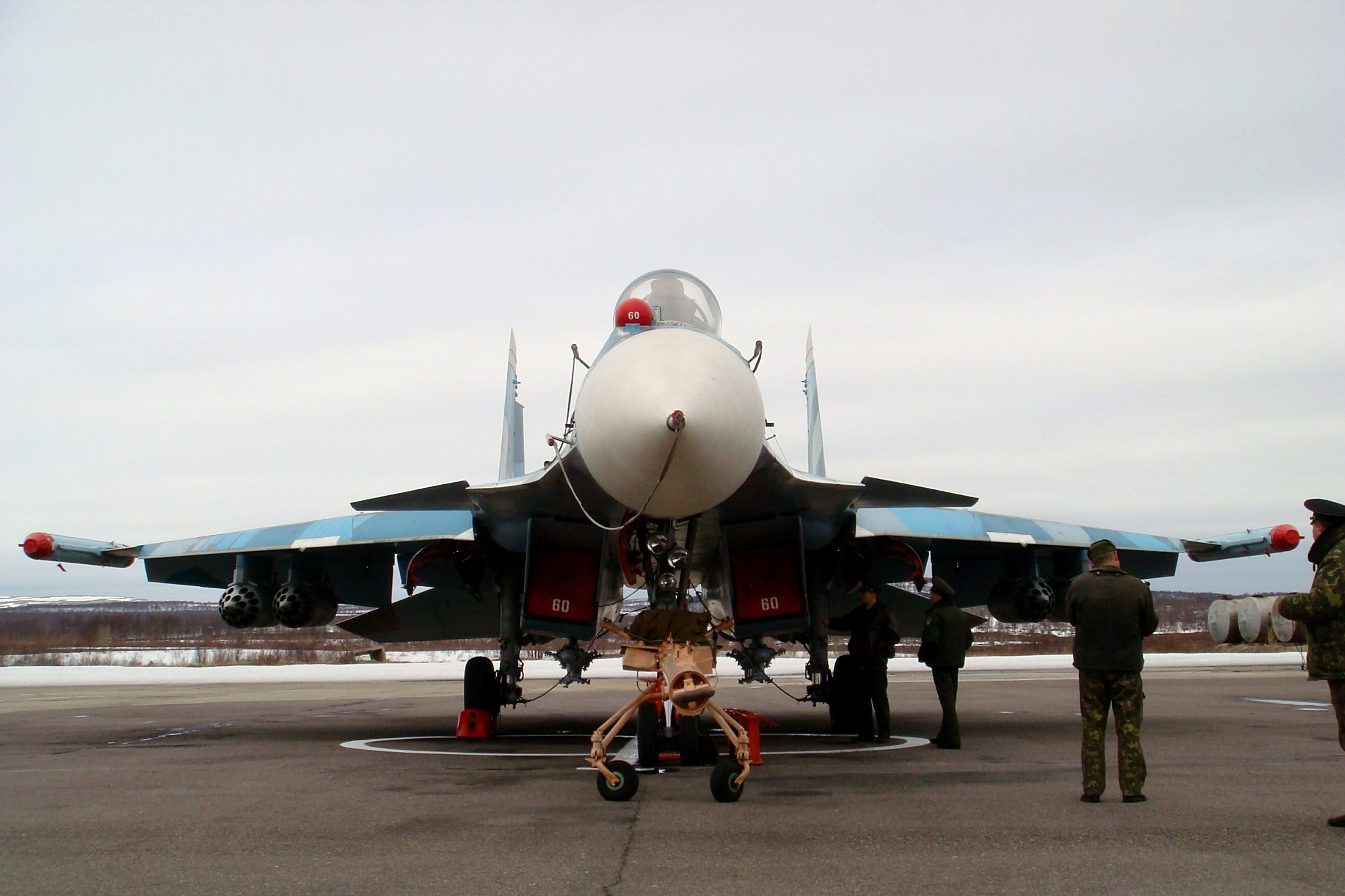

Nazar Posted November 2, 2023 Share Posted November 2, 2023 Regarding Sorbtion and strike weapons. Photo by my friend Alexander Gorbulinsky Link to post Share on other sites
