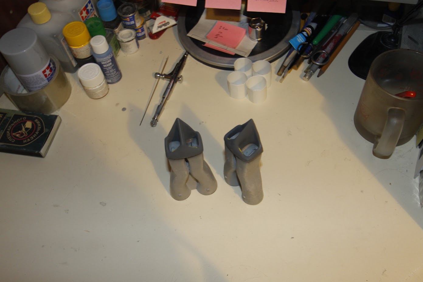

And i complite with intake duct and turbine fans
1zoAaZ-l2Eg_AXC1y5O8AjYUCVMCPH-J8rp1mWGV
and original foto
WEOM2cjtD7k5Iu1pYXv8T7Kw8WGH7n9hcckIXt0Y

Good day all
Now i'm making afterburner fans, any ideas what's color or pigments or something else need addition that was so close as in foto.Any ideas are welcome :rolleyes:/>/>
BCb8h4VUJij1ArDVrH7MGAN4g9gV9kZrU6SUosF5
Yes this i using that make this fan
r7XvWbPltJXqN09w6lGFgnJ110WXPmNSQgxRpuHD
Best regards Alex :coolio:
Edited by black_widow
Hello Alex, I have lurking on your build. It looks like you have nailed the paint for the afterburner fan. To my eye the tips in the center look almost white in color but, perhaps it is a camera flash reflection of bright aluminum? Your choice for color of course. I am not ever sure this post qualifies as a suggestion. Haha. This is a great build you have here. Don't go and second guess yourself!
