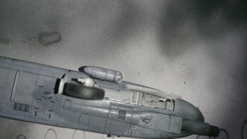

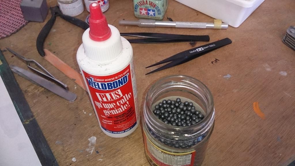

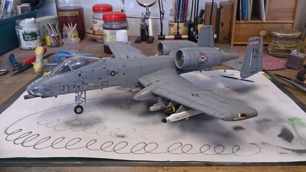

Crazy Snap Captain Posted August 14, 2013 Author Share Posted August 14, 2013 O ye of little faith :D I used the method that Fly-n-hi described with the lead shot and white glue. I actually found a gap in the front landing gear where I could feed in the lead shot after I had mixed it with the white glue. Took about 20 or so pellets. Here's the ingredients... Here is the gap in the front landing gear where the pellets were fed in. You can just make out some of the lead shot... And the finished hog (not tail sitting thank God). All in all a painful kinda build, but will definately be doing another one using the lessons learnt (and some AM). Quote Link to post Share on other sites
