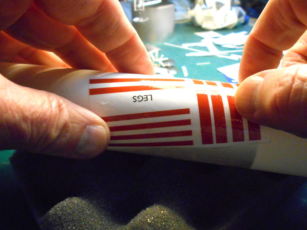

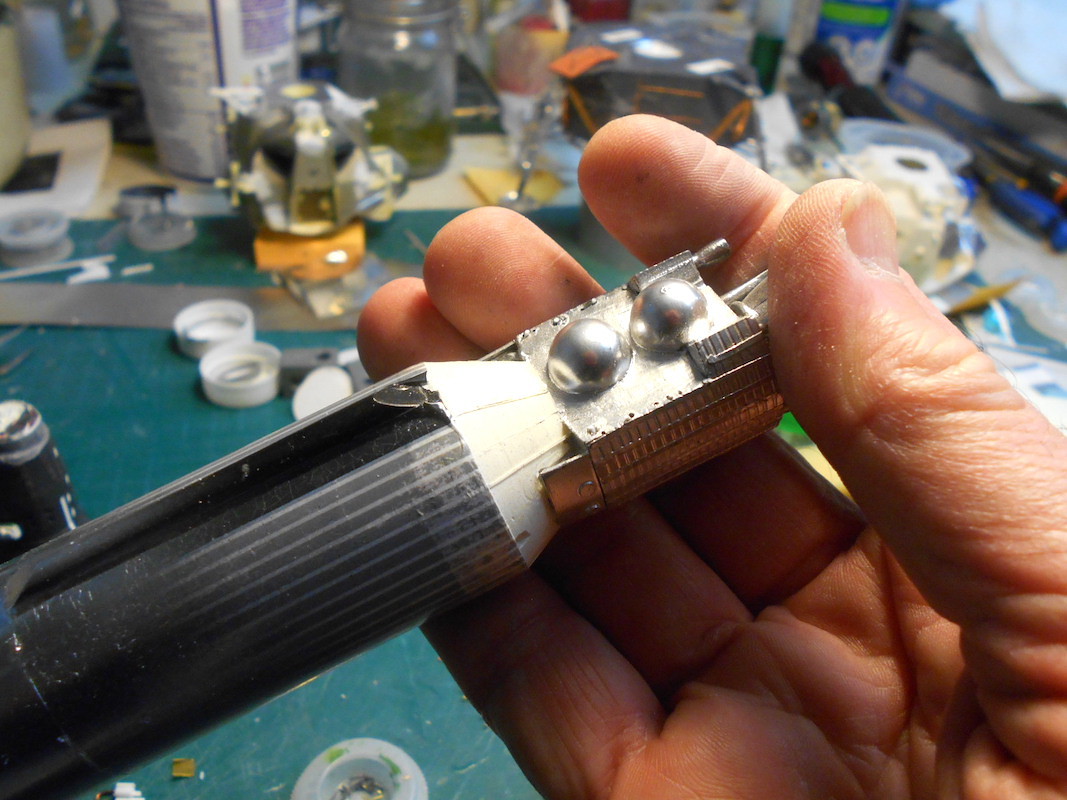

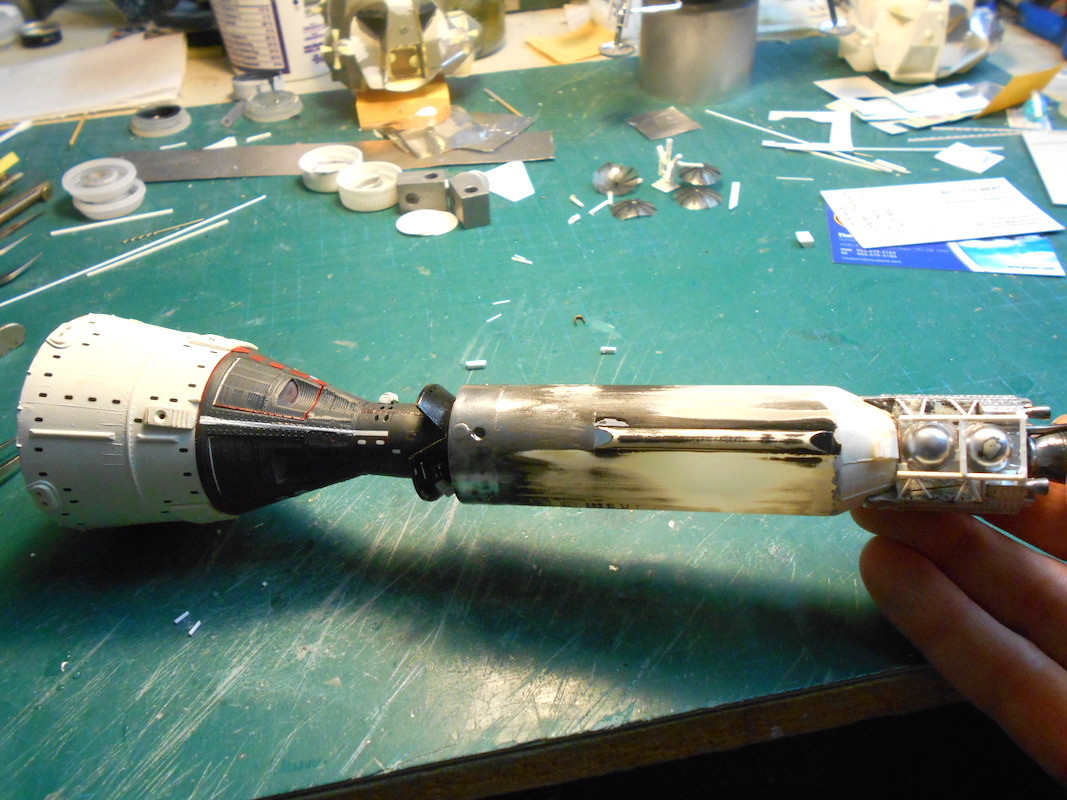

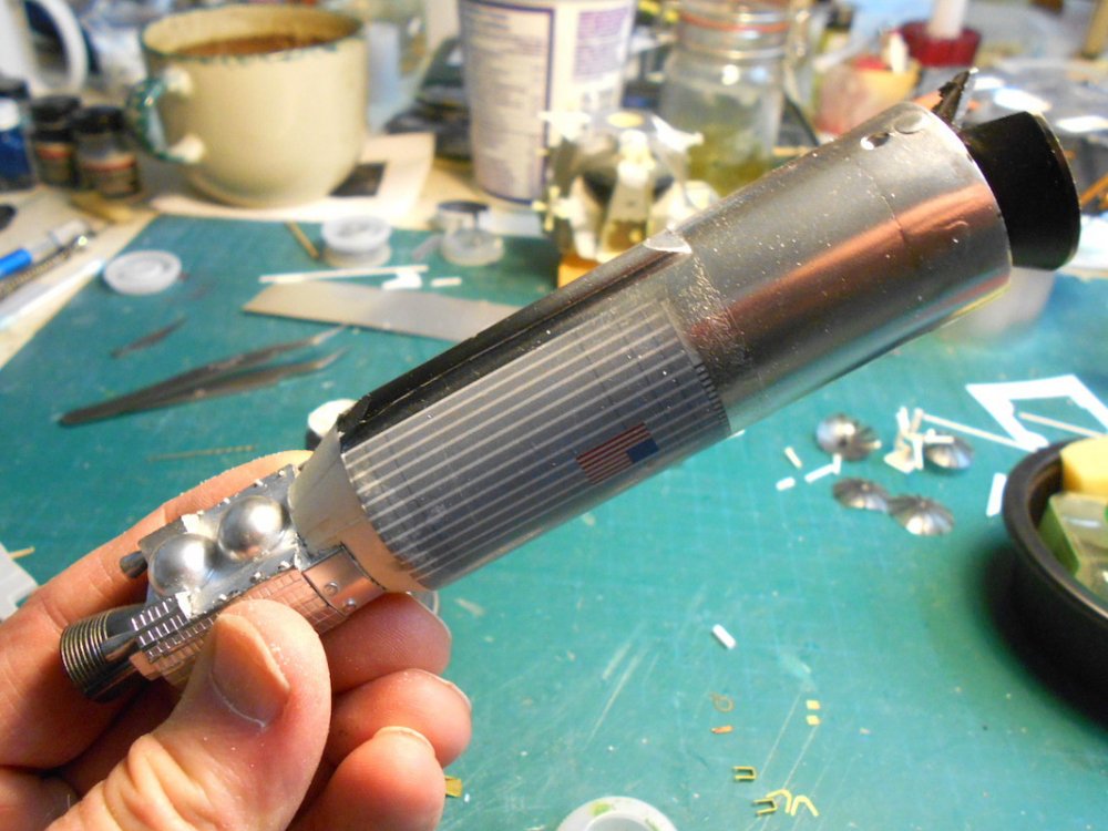

K2Pete Posted December 4, 2022 Author Share Posted December 4, 2022 Well-l-l ... this took some time to resurrect this build ... something like page 32 on this forum. But let's get this one off the Shelf of Doom ... ;- D This is the Aft area as it has sat for 10 years ... sheesh, TEN YEARS?? Let me extend my apologies to this model ... ! ;^ D My homemade decal has faded and I'll see if I can salvage it In order for the Gemini to fit inside the Agena, I had to file down the nose diameter Alright, that'll do This homemade decal was printed off all those years ago, so I shall have to see if it works or falls apart Starting to add some details. The reference photo, one of many, is in the background And some Greeblies ... I don't remember what I did with this decal back then so I thought I'd just peel it off using Vinegar to soften it. When that didn't work, I just wet-sanded it off Much better, and you can see the added details on the Aft end too And a dry fit ... it's longer than I thought it would be ... So, onto Paint and Decal and hopefully I'll get this Shelf Queen done! Thanx for looking in Pete Quote Link to post Share on other sites

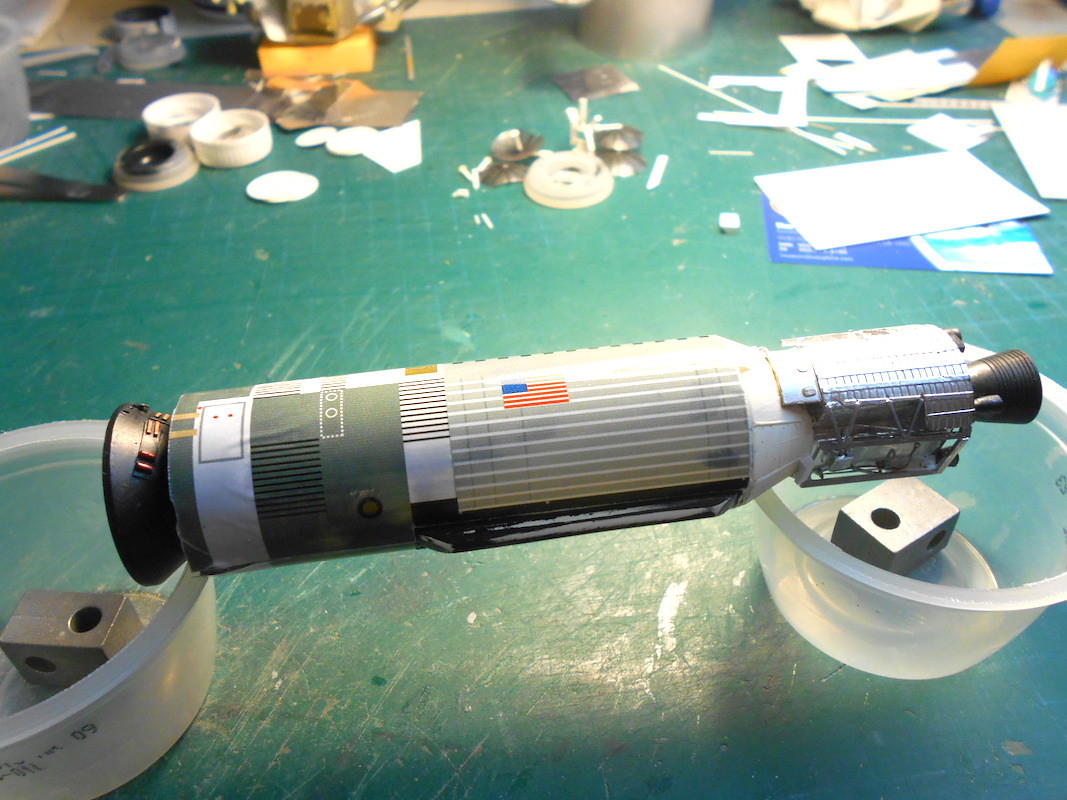

K2Pete Posted December 7, 2022 Author Share Posted December 7, 2022 (edited) Many Thanx Gentlemen! I had some issues with my 10 year old homemade decal ... I'm glad I printed off 2 of 'em. I cut this big decal in half and when I put it down, the setting solution didn't allow me to adjust it ... so while manhandling the decal trying to get it into place, the decal rubbed off in spots. You can see the poor alignment ... But kudos to Bare Metal Foil's Expert's Choice decal film, it still worked perfectly! Even after all these years! Using vinegar, I tried to remove this ruined decal as gently as I could ... to no effect. ... and realized that wet sanding it off would be the quickest method. While thinking about how I can place this decal on the model, damage-free ... it's about 4" long, should I cut it into more than 2 pieces, maybe 4? And while sleeping, the thought came to mind about using dishwashing liquid instead of setting solution. Way back in 1979 or '80, I had a buddy who wanted to put a BIG Phoenix decal on the hood of his Firebird ... and he had seen guys doing it with a lotta difficulty, ruining the BIG expensive decal. And he tried dish-soap. IIRC he read about it in Hot Rod or Car Craft magazine. So I tried this on a piece of tubing and an unused decal from the same sheet. And ... it worked Perfect-a-mundo! I could move it around quite easily! It laid down very nicely! I wiped off the soapy water with a soft brush and then applied setting solution with a soft brush, and will leave it to dry ... But am I ever happy this worked! ;^ D There are a couple of spots where the surface rubbed off so I'll do a little repair work with paint and then on to the finishing! Thanx for taking a peek Gents! Pete Edited December 7, 2022 by K2Pete Quote Link to post Share on other sites

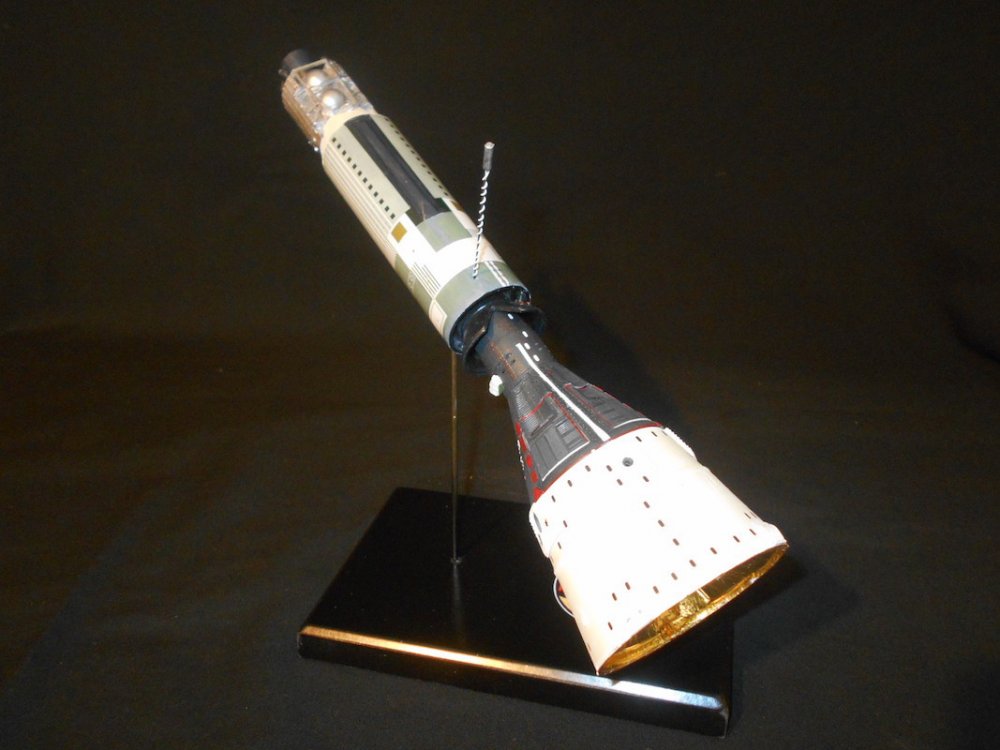

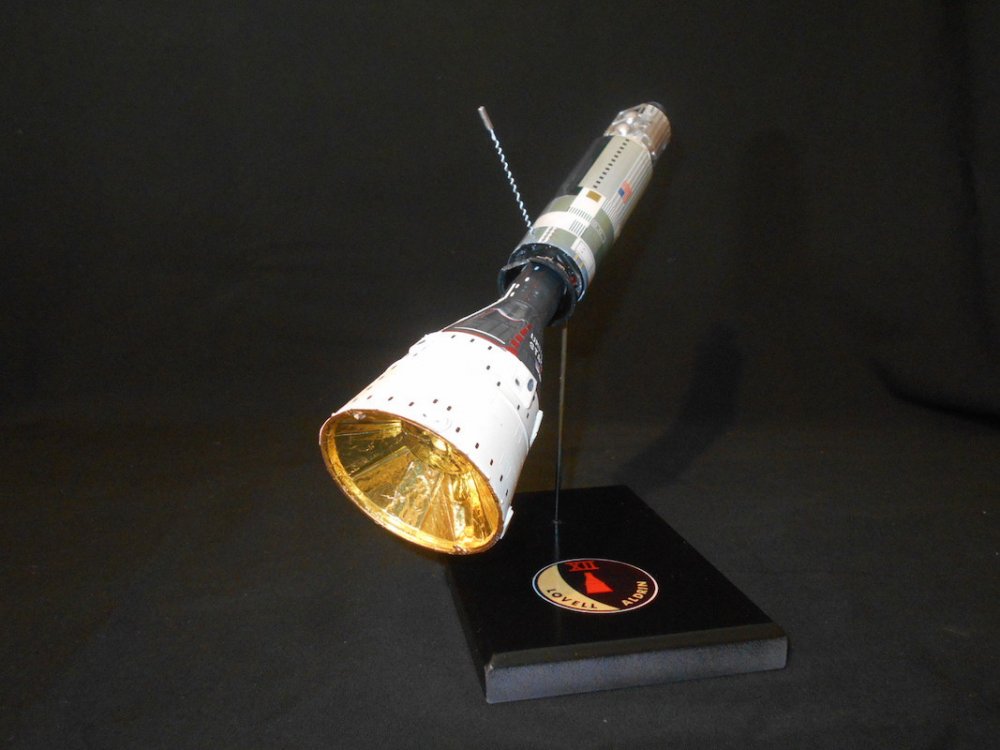

K2Pete Posted December 9, 2022 Author Share Posted December 9, 2022 I got her done after all these years! This little 1/48 won't win any awards, but I'm a happy old fart ;- D When I would do my morning Tai Chi patterns near the workbench, this little guy would be watching me, from the Shelf of Doom, with the most derelict, lonesome eyes, as if to say, don't you love me anymore?? Phew, I won't have to go thru THAT anymore! ;^ D The Gemini 12 Decal is homemade and I've added a few little greeblies to the Agena and made the antenna from piano wire and wrapped thin gauge copper wire as the cord. And I fixed up those little flaws in the Agena decal with some well matched Model Master paint. On the Gemini, the long, central White decal was breaking apart and I used a spare decal, one of Rick Sternbach's products, to repair it and THAT 'new' decal broke apart in the water ... well, it IS over 10 years old, what should I expect, right? Anyways, here's a few pix! Thanx for taking a peek at this build gents ... I've still got 1 or 2, 1/48 Gemini Spacecraft in the stash, and I'd better get those done too before I get too too much older. ;^ D))) Pete Quote Link to post Share on other sites
CaptKirk Posted December 9, 2022 Share Posted December 9, 2022 Looks fabulous! I always had it in my head that the Agena was much larger - (I guess the ones I saw in the pictures were closer to the capsule than I thought) - and your model does a fantastic job of correcting this. What's next? Quote Link to post Share on other sites
