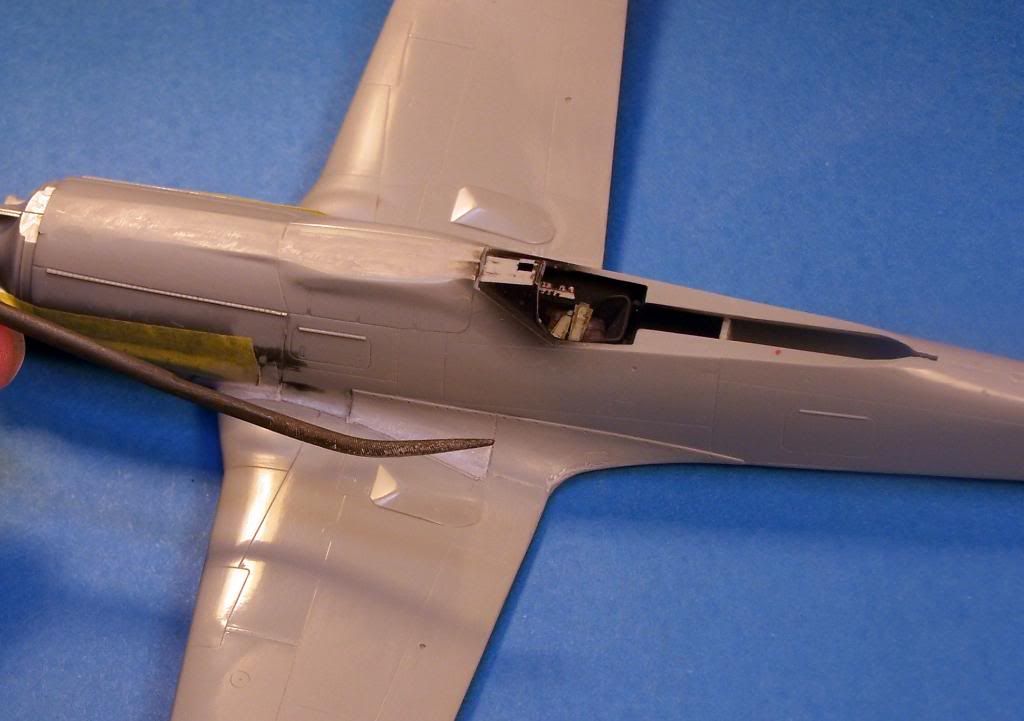

Netz Posted February 16, 2014 Share Posted February 16, 2014 If your seeing scratches after a coat of paint then your finish grit is too course. 320 is about as course as I go "if" I sand at all, but I seldom have to go finer that 600 on a regular painted surface (non-NMF) But always finish with OOO steel wool. Another medium you can use are files, they will cut plastic away rather than grind it, files will leave a smooth finished surface, for hard to get to areas like a concave surface then you can use a "Riffler File" those curved ones you see and wonder what they are for... Curt Quote Link to post Share on other sites
