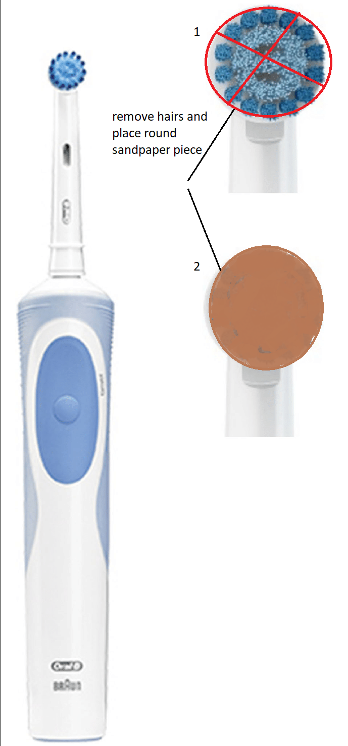

My other problem is these tent ridges.   I tried filing/sanding them down but they just wouldn't smoothen out properly.   I'm gonna try putting a low thin wall where supports can maybe attach to that I can maybe score/break off later -- that might make sanding easier than dealing with tents.
uhmm , i using a old rotating toothbrush , i change the top head place  a little piece  round sanding paper , fine sanding paper , works perfeckt and you need not much press on the thin parts , it,s a idea
oscillating-rotating-powered-toothbrush-Oral-B-Vitality-2D-Sensitive-Clean-Procter.png
I had already seen the same idea somewhere a long time ago, which I liked immediately and had tried it out, as described here by bubble:thumbsup:
Bristles removed, double-sided tape stuck on and fine sandpaper (500), done! :whistle:
Very suitable for larger and accessible parts, but SW's filigree Gearbox Combos would be too delicate for this method. :hmmm:
But for your struts, Joe, it should work if you're careful enough. up040577.gif
Edited by spaceman

The sanding tool did help a little.   It caught my eye at the LHS so I picked it up along with a polisher.
