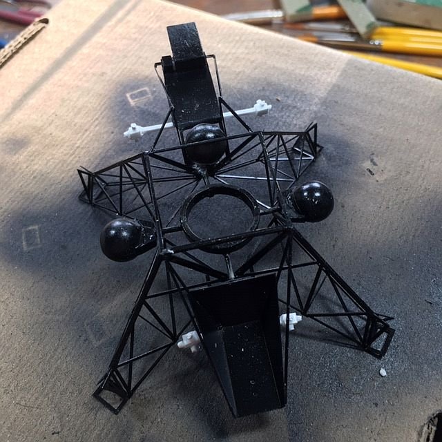

Long time member here, but was a lurker and then lost track of the forum. That is until I started building the 3 Stooges LLRV, and when I finished all the pieces, it still looked incredibly empty.  I re-found Tag Team's offer and sent for their CD, and then I found you on this site.   Gotta say amazing work.
Even tho my little dinky 1/72 version is nothing by comparison,  I'm following your build with interest, adding what I can to my little model.
Hi Wombat, , appreciate the kind words : )  Hi Go Flight, thanks! Would love to see pics of your model.   Hey, that's a good CD of Jay Chladek's photos of the  LLTV B3 (NASA 952) at the JSC.  It was the 5th and final training vehicle made -- so wonderfully preserved.   Hi Manfred, I took an entire week off to spend March break with my kid but ended up building so you saw a lot of progress.  Now things might slow down again, but I'll try my best and see how far I can take this.  Hopefully completed by GB's end  : )
Thanks. It wasn't until I added all the kit parts and the model still looked sparse that I realized it was necessary to do some scratch building. At the time I was just trying to copy the few clear parts by eyeballing the size etc.  So far I have the two additional spherical tanks in the rear, the attitude adjustemtn nozzles, and I'm currently trying to create a tiny altimeter unit for the rear. I figure if I could busy it up with some wiring and plumbing it would make the tiny scale a bit more believable.
I painted it gloss black in prep of the metallic coat before I thought I needed to add "more stuff." 😉  Thanks for looking.
