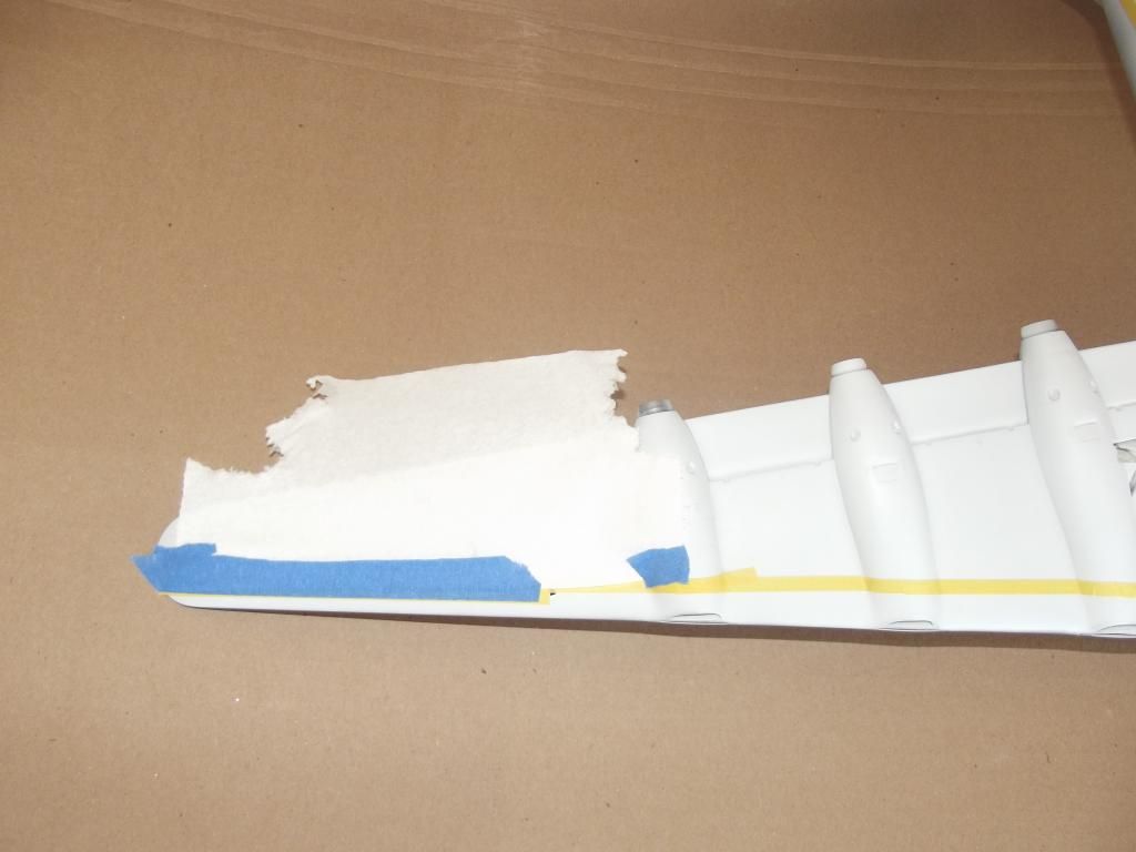

Netz Posted May 4, 2014 Share Posted May 4, 2014 I see allot of modelers refer to "Hardware Store" brand tapes such as Blue Tape and Frog, note these are made for Household use and not modeling,you really can't compare them to Hobby produced products. So my thumbs up for Tamiya tape, as there aren't too many other readily available products made specifically for the scale modeler. With that, this is my method of masking areas off, the picture is pretty self explanatory, the only thing touching the painted surface is the Tamiya tape. Another good product to use for masking as mentioned above is Para Film M, I like to use it on NMF as you can cover a panel and cut it along the panel line with a sharp "Curved" blade, it's very quick and easy. Curt Quote Link to post Share on other sites

nerdling Posted May 5, 2014 Share Posted May 5, 2014 I see allot of modelers refer to "Hardware Store" brand tapes such as Blue Tape and Frog, note these are made for Household use and not modeling,you really can't compare them to Hobby produced products. So my thumbs up for Tamiya tape, as there aren't too many other readily available products made specifically for the scale modeler. With that, this is my method of masking areas off, the picture is pretty self explanatory, the only thing touching the painted surface is the Tamiya tape. Another good product to use for masking as mentioned above is Para Film M, I like to use it on NMF as you can cover a panel and cut it along the panel line with a sharp "Curved" blade, it's very quick and easy. Curt Have you tried the Yellow Frog tape though? It is literally the same thing. You also get quite a bit more of it for a cheaper price. Quote Link to post Share on other sites

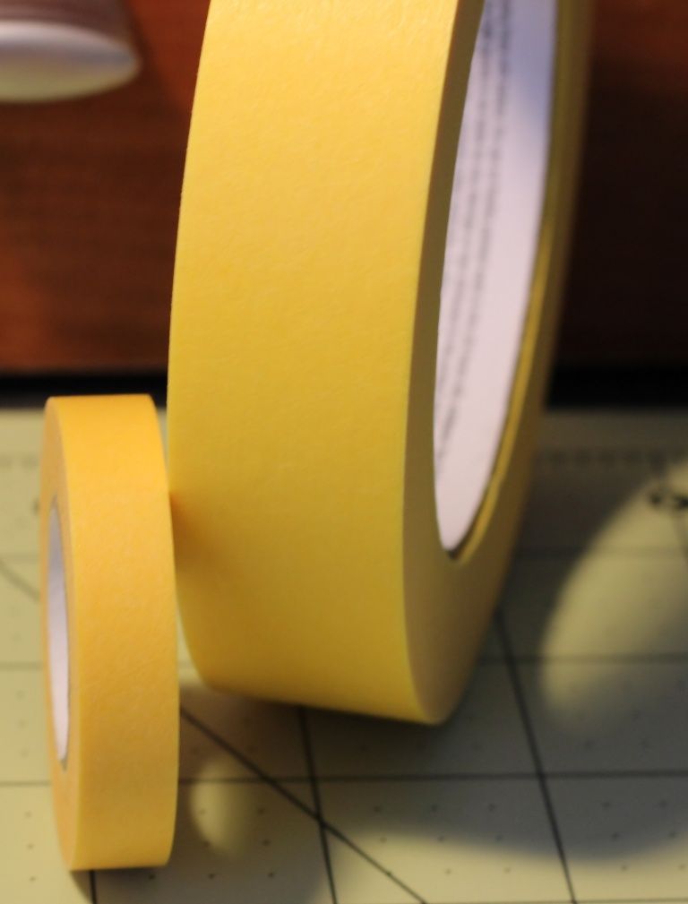

Shaka HI Posted May 6, 2014 Share Posted May 6, 2014 Well..tried a fairly out of way Walmart for me...Cost is under $7 (that Tamiya roll in the pict cost me $6 locally!!!!). Slightly thinner and seems a little less flexible than Tamiya's tape, but I highly doubt that the Tamiya tape would perform any better. Thanks Nerdling! Now I can mask with abandon! Quote Link to post Share on other sites
