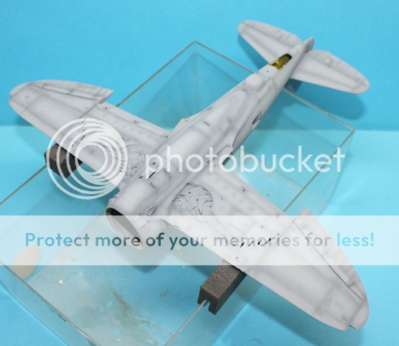

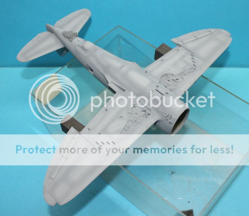

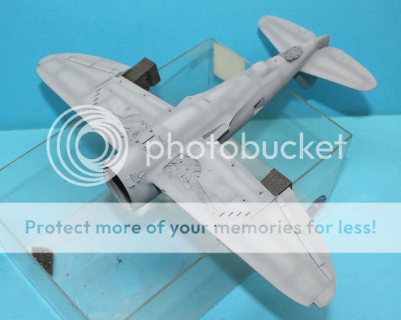

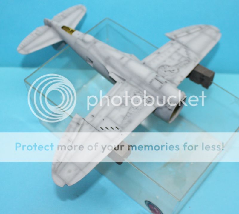

galfa Posted August 25, 2014 Share Posted August 25, 2014 Would like to know more about your shading. Freehand? Masks? How? Quote Link to post Share on other sites
ajcmac Posted August 25, 2014 Author Share Posted August 25, 2014 Really looking forward to your final set of pictures. The entire painting and weathering process has been a excellent learning tutorial. Joel Joel Thank you :worship:/> :thumbsup:/> . Would like to know more about your shading. Freehand? Masks? How? galfa Post shading, no mask, freehand. I have photos of the application of light and shadow when I painted the Neutral Gray. All references are from Tamiya paints. I applied Neutral Grey XF-54 Tamiya. Then make the mixture for the lights. XF-54 (1) + XF-2 (0.5) thinner X-20A (4). Paint the interiors of the panels. Then make the mixture into the shadows. XF-54 (1) + XF-1 (one or two drops, no more) thinner X-20A (4). Paint the lines of panels. Apply again the two mixtures, starting with the lightest color. On the fuselage apply lines, as thin as possible, vertically. In the wings apply them in the direction of flight. I hope you understand because my English is not very good :crying:/> . Regards ajcmac Quote Link to post Share on other sites
