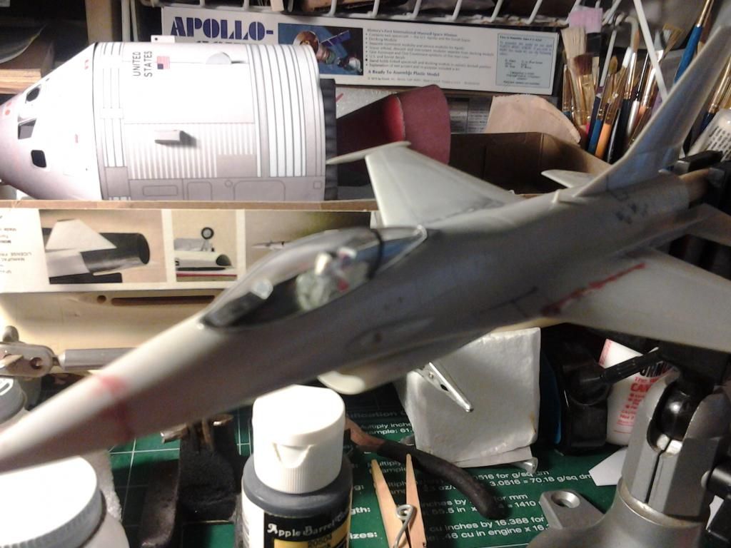

The old 80's era 1/72 YF-16A. I've not fussed around with correcting inaccuracies; I just want a simple and fun build. This project has endured plummeting off the work bench twice. As a result I have had to replace two parts and reattach a wing that detached after it's second fall.

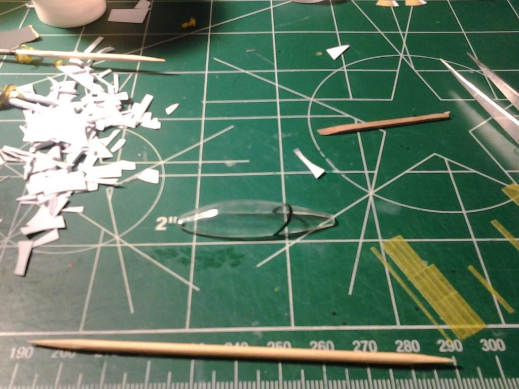

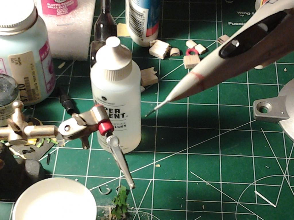

It's blurry but the pitot mast at the tip of the nose was replaced entirely (The old part was too badly damaged in one fall...annoying cats). The tip of the cone was shaped styrene stock. The "tube" is piano wire with copy paper wrapped around in soaked in the runny type of CA glue. The end result actually looks a lot better than the old part did.

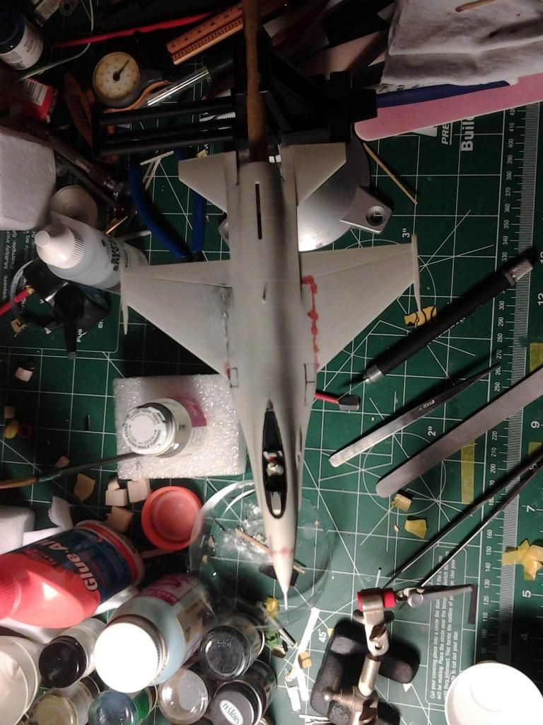

With the repairs completed I'm hoping to get to attach the vertical stabilizer and canopy and get painting done this week. Since the YF-16 was glossy I was wondering how I should proceed. Should I bother with painting the three main colors; white, red, and blue, in gloss? I was thinking of laying down flat paints then accomplish the gloss with clear coat once all the colors are laid down on the model. Would that be an appropriate course of action?

If I were doing a gloss paint scheme, I would use gloss paints, like I did when I built racing cars. I always started with a primer coat of Tamiya gray primer. Then polished smooth with grits from 4,000 to 12,000. Then I applied the gloss paints which were either enamel or lacquer based. Let each color dry for a min of 5 days before you apply the next color. Polish out each color before you apply the next color. That will remove any hard masking lines, and keep the surface smooth. Then decal, then a clear gloss such as Testors Glosscoat cut 50/50 with lacquer thinner. Polish out after a min of 3 days drying time. Then a final few coats of Glosscoat thinned to 40/60. Let dry for 3 days, polish then wax. The shine will amaze you.
Joel
Just be careful with polishing paint. Any raised lines or outside edges have very little paint on them, and you can polish right through them in just a few passes. Go slow, use lots of water, test with your finger often. Do a few google searches. You'll even find a lot of vid on You Tube that will be very helpful.
Joel
